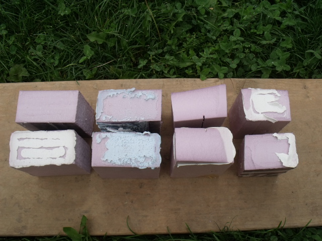

Test #2 is finished. This test actually allowed a 6 day cure time.
Test #2
George.

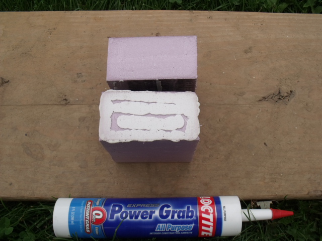

Loctite Power Grab.
Again I found the Power Grab to be lacking in Power or Grab. The break was easy to achieve. Product had dried well around the edges but was still a bit sticky in the center. With more time I am sure it would achieve a full cure, but I do not think it would help much with the Power Grab :thumbdown: .

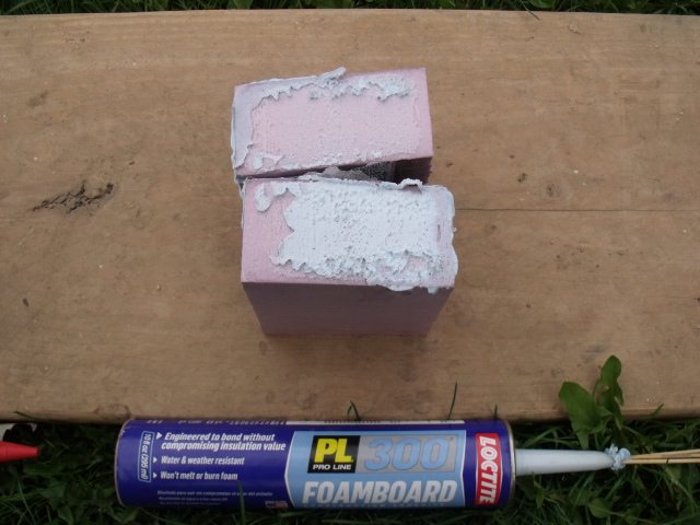

Loctite PL 300.
This product was a bit harder to achieve separation. Again the edges were dry, but the center was still quite wet. I believe with a longer dry time this product would achieve a good bond just by the effort it took to separate with just the edges dried . :thinking:
Loctite PL 300
George.

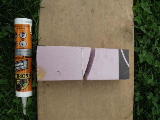

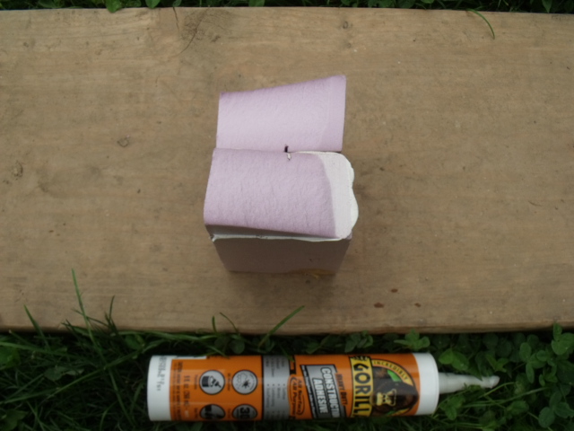

Gorilla Glue Construction Adhesive.
OK, once again the Gorilla Glue Construction Adhesive showed it's stuff. This took quite a bit of effort to break. In fact, as you can see, the glue line did not fail and it was the foam that gave away. That is how much effort that had to be applied to snap this block in two. Product once again was dry all the way through. I like the fact that not only does it dry fast, but it also bonds to the foam quite well. :thumbsup:
Gorilla Glue Construction Adhesive #1
Gorilla Glue Construction Adhesive #2

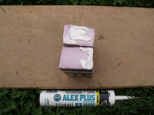

Alex Plus.
Again I found that Alex Plus achieved nearly the same bond as the PL 300. The break point seemed nearly the same. Edges where dry, but the center was like a clay constancy. I believe that it was drying faster than the PL 300 too. Again for the price and such similar results I think I would just stay with Alex Plus. :thumbsup:
Alex Plus

Small wonder that Loctite Power Grab All Purpose did not work well. The tech data on that one states one surface must be porous. Foam to wood/plywood/OSB works very well but foam to foam, No.

I might also add that the Alex Plus is not even sold as a adhesive let alone recommended for foam bonding, but as a crack and seam filler. Which in my test seems to bond just as well to foam as the PL 300 which is a specific product for foamboard. For the price I would op for the Alex Plus. Would the PL 300 work better once a full cure was achieved? I don't know. That is another test if someone wants to pursue the results.
