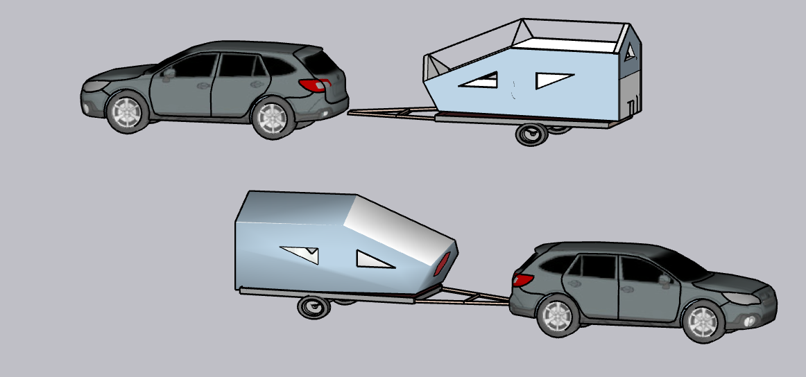

troubleScottie wrote:On your design, drag is based on two things, velocity (squared) and cross-sectional area. Anything that can be seen when looking at the trailer from in front of the tow vehicle is going to add drag. Technically, there are other issues, with the shape of the trailer and turbulence between the tow vehicle and the trailer. That is a major appeal of the teardrop : low, narrow profile running in the shadow of the tow vehicle, and the half wing shape which is one of the lower drag configurations.
I tried a couple drop angles on the front of my previous "church" design and it seemed to make it much too complicated, sacrifice a lot of headroom / jacket hanging space, and not seem that appealing.
Screenshot (88).png (87.85 KiB) Viewed 2848 times

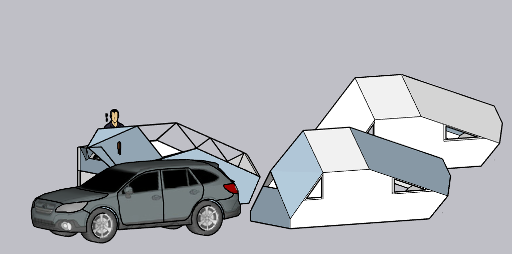

Then I thought, Why not just spin the whole thing around?
Screenshot (89).png (147.48 KiB) Viewed 2848 times

Re: Winter-ready ski-trip foamy design
Postby GPW » Mon Oct 05, 2020 2:15 am
IrrE, that looks pretty Cool , and doable.. :thinking:
