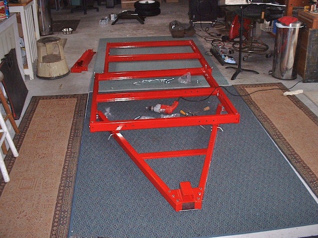

Postby GPW » Sat Nov 26, 2011 2:16 pm
Coming along ... I did have a little trouble with some slightly mis aligned holes where the tongue pieces connected to the frame on the sides ... abrasive stone on a drill fixed that ... ;) More pics in the Album ...

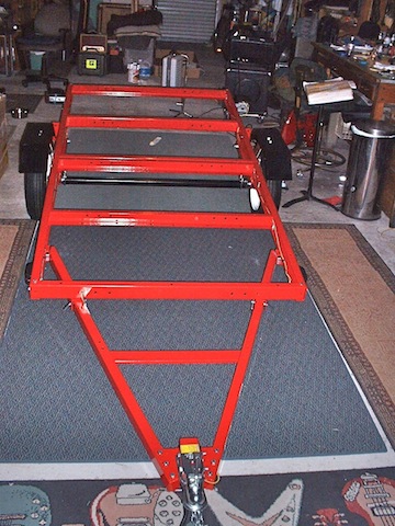

Postby GPW » Sat Nov 26, 2011 9:13 pm
I’d have posted this sooner , but I had to go take a nap ... Tired from trailer assembly , and crawling around on the floor ... :oops: All I have to do now is re-pack the bearings, install the lights and the coupler , and we’re ready to put the Foamie on top ... One thing I already found out ,the holes for mounting the cabin are too close to the edge and would be covered by the foam walls ... and my door looks like it might open onto the fender , so we’ll have to do some shifting around ... Guess that’s what I get for building the cabin , before I got the trailer ... :roll: :oops:

Postby GPW » Sun Nov 27, 2011 6:51 pm
All done now , finished ... Built pretty stock , but I did solder and heat shrink all the wiring ... just seemed better job for our Humid clime rather than the little blue crimp connectors ... Looks Good ,all done , but boy am I sore ... back , legs ,butt ... This was a workout for the old guy ... :o
