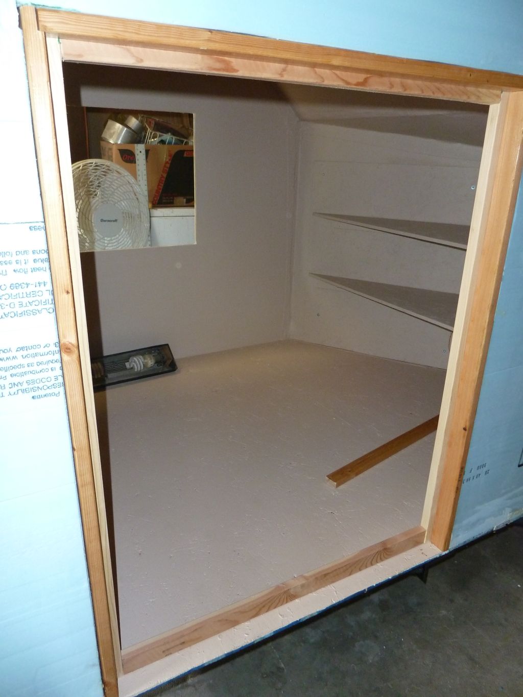

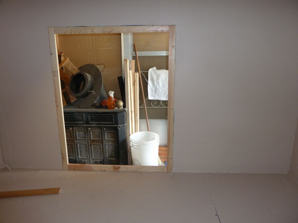

Finished roughing in the door frame consisting of 2ea 1x2 pine, one on flat, the other on edge along the foam. pix below. Anybody who wants to tell me I am doing it wrong is welcome to say so since I am just thinking it looks about right. Will screw & TB II the three frame segments, screw & glue bottom gasket flange to floor (or up thru floor or both). Then Great Stuff the frame members in place with nylon-dry-wall-screw-sets & packing tape.
The idea is the cover the wood along the foam with canvas from outside overlap, gasket on face of wood flange, and homemade screen door between the flange edges. The foam door will also have 1x2 (plus 1/2 ply/osb for an even edge) on its indented (routed) edge to fit into the frame.
Door frame 1.jpg (162.99 KiB) Viewed 11226 times
Doorframe detail 2.jpg (142.1 KiB) Viewed 11226 times
note outside porchlight wire covered by wiring loom at bottom right of door
Door frame inside 3.jpg (84.67 KiB) Viewed 11226 times

Postby KCStudly » Fri Jul 03, 2015 5:41 pm
Nothing wrong with that. Least not anything I can see from my house. :thumbsup:

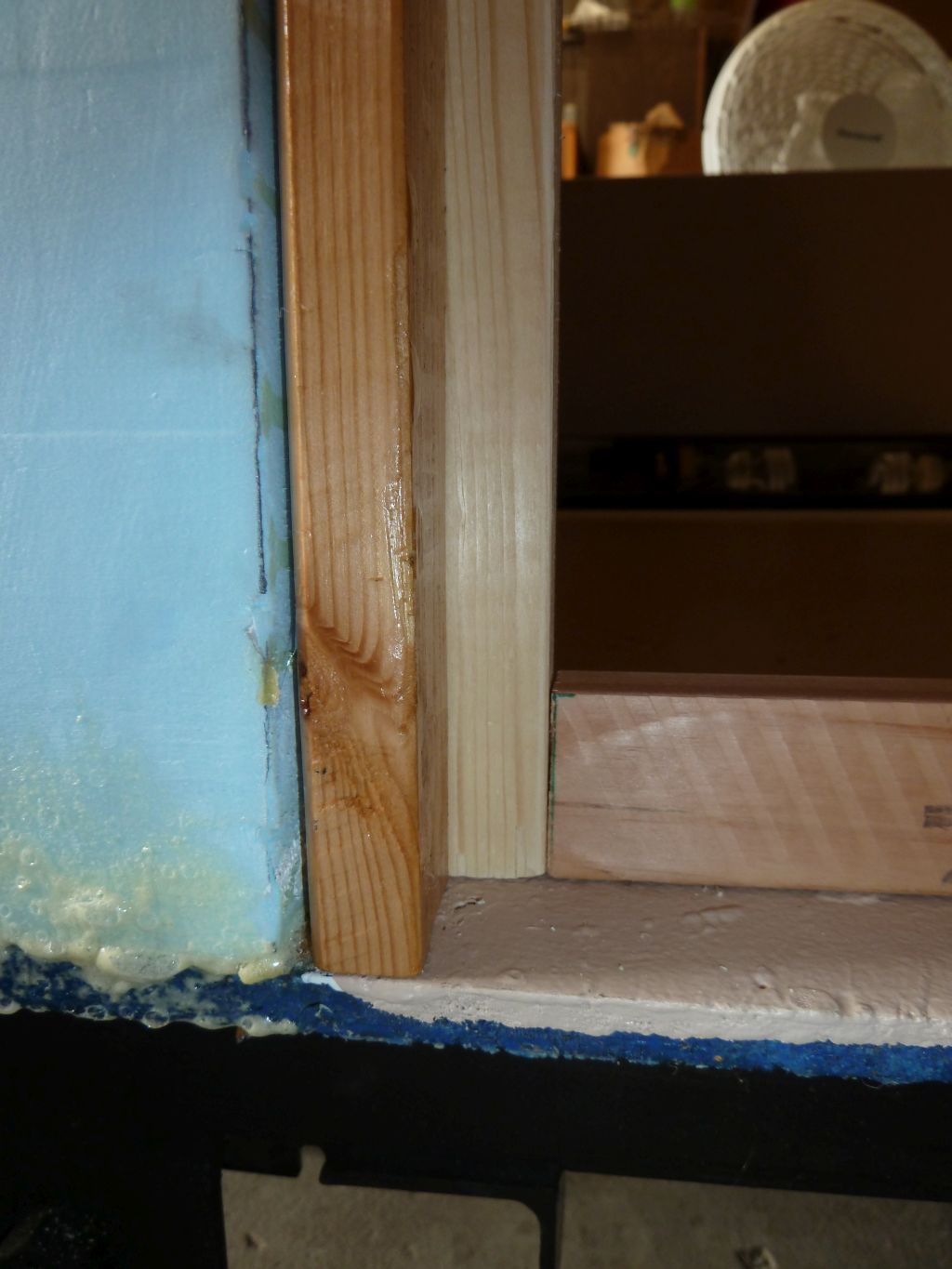

Why is because 1x2 inch nominal is 1.5 inch wide so the foam sticks out half an inch beyond the wall thickness. I still could add half inch ply or OSB to the edge and have the other 1x2 stick out into the interior more but want to avoid that. Still would need to wrap door in wood and cut out 2x4 insert to mount lock into.

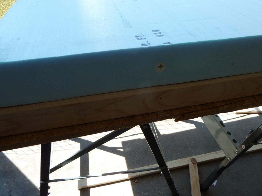

EDIT: have cut down the foam door to size & will add the 1x2 s to edges and try sanding it down to see how it looks. can always do something else if it sux.

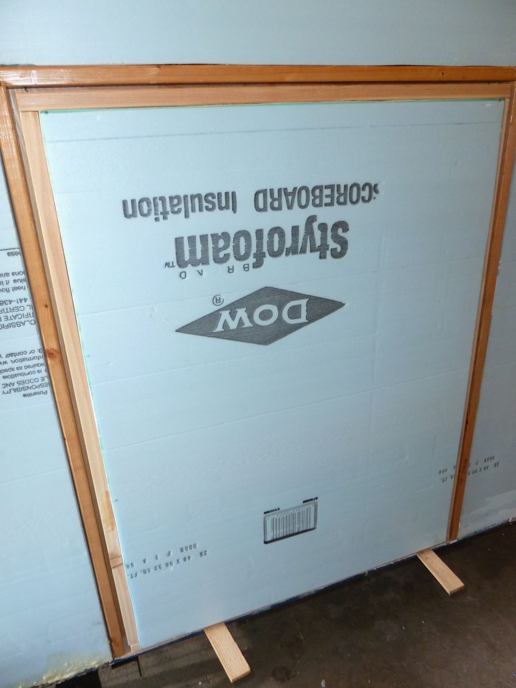

Show you door work in progress so anybody can pipe up and give an aye or nay ! I am thinking it will work out decent but unsure of how crappy it will look.
dry wall screws hold foam in position during glue up
Door dry-wall-screws.jpg (94.87 KiB) Viewed 11161 times
Door rough assembled fit check 2.jpg (146.26 KiB) Viewed 11161 times
half inch foam sticks out - can either sand the edge to match or try to sand whole panel
Door rough assembled fit check edge.jpg (190.41 KiB) Viewed 11161 times

Postby GPW » Sun Jul 05, 2015 7:57 am
Either Bevel the edges for a smooth transition or use some type of 1/2” thick moulding... Door trim ... :thinking:
Re: Bread-loaf build thread
Postby KCStudly » Sun Jul 05, 2015 9:01 am
I was thinking long board and 36 grit sand paper to get it close (don't press too hard or it will chunk out), then 100 grit until you start touching the frame... or hot wire cutter.
