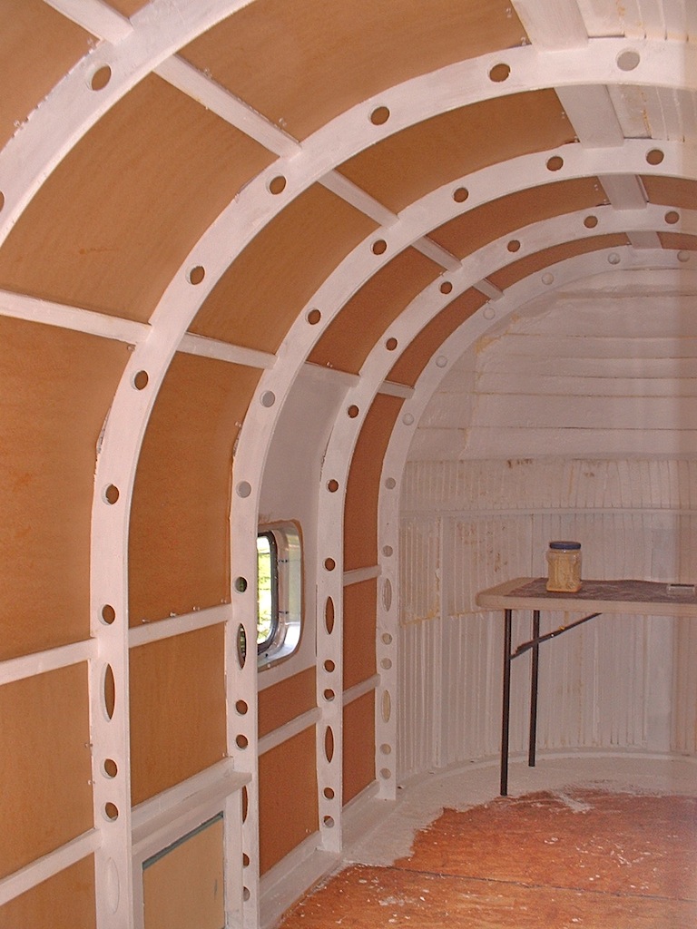

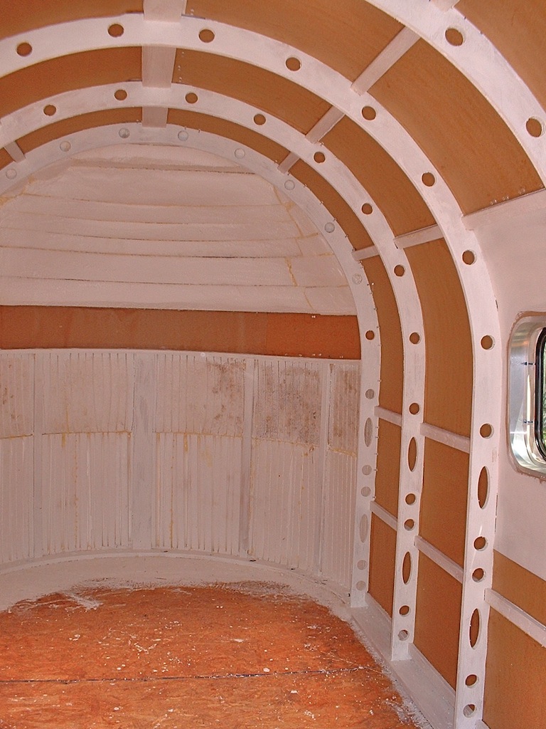

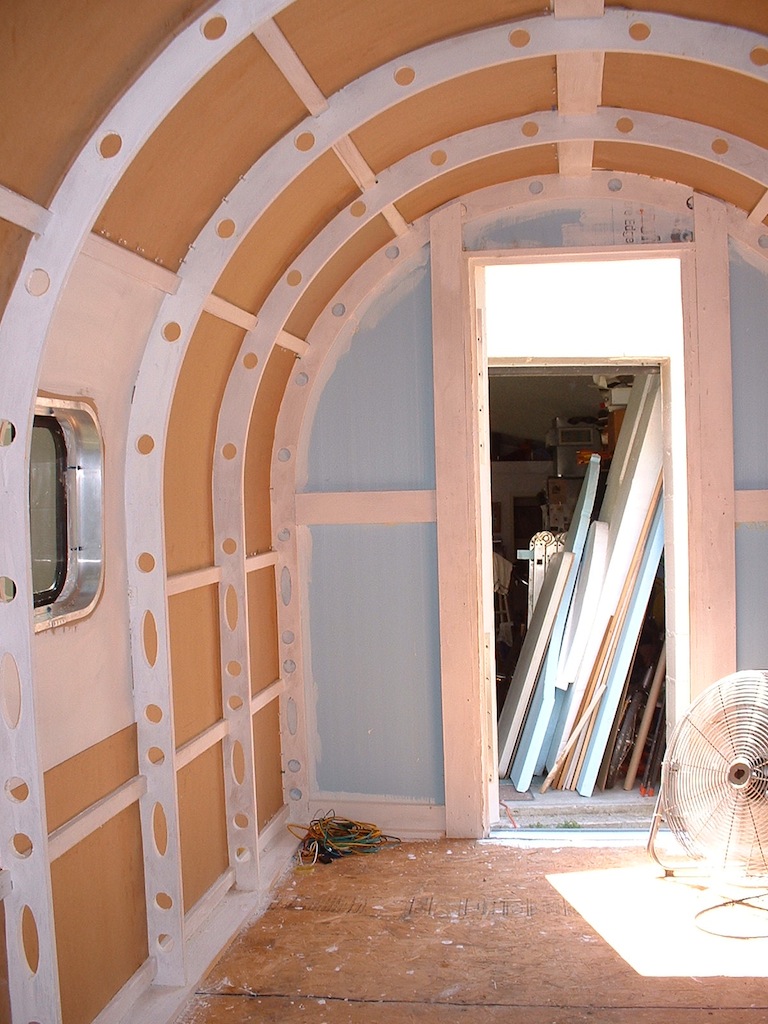

KC, that was the Dry fit :o ... here it is glued ... Just slobbered TB2 all over the back , pressed it down ... It stays ... I did cut all the pieces out first and just temporarily pressed them in place (the previous pics ^ ) ... then glued them all up at once.. we found that much quicker than one at a time cut and gluing ..
Ran out of TB2 ... my fourth gallon .. :shock:

Distressing , the little spaces in the #3 panels (middle ) where the foam didn’t quite meet the ribs :oops: ... Thinking some good quality gummed paper tape should seal those ... :thinking:
I’d like to spray some texture over all this , like drywall, just to add a little character to the surface , and hide some of the sins... :R
Chipboard , TB2 and foam is a marriage made in Heaven ... All the talk about cardboard in the past ... I’ll certainly be using it again !!! ... :thumbsup: :thumbsup: :thumbsup: :beer:

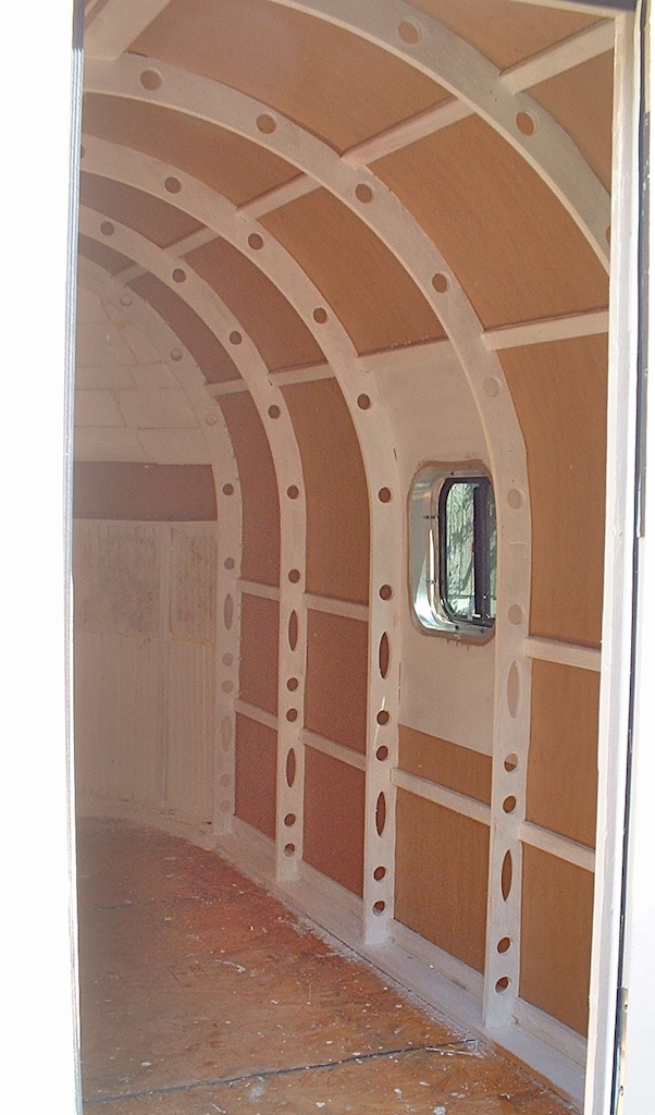

By emptying out all my old T2 bottles into a peanut jar , I was able to finish the inside chipboard , save the front nose ... :thumbsup: So that’s that and all’s well!!! :D
Also able to cover the middle nose part ... Only the heavy chipboard yet to be installed on the nose bottom (like paneling) and the burlap over the upper rounded part ... :thinking:

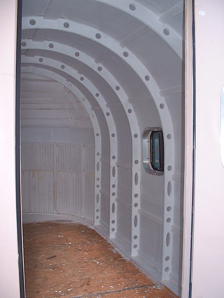

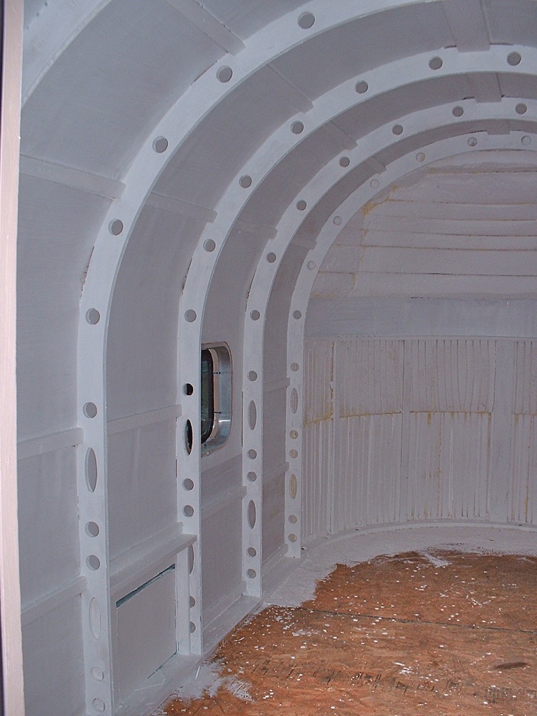

And back in prime ... Now out of the Gripper too ... that fiver'... Poof !!! Gone !!! :o ... a little caulking here and there and some sanding and we’re ready to paint ... :thumbsup:
Just an observation ... The Gripper , like any Latex product after a week is still un-sandable (gummy) .. Have to wait a while more ... :roll:
