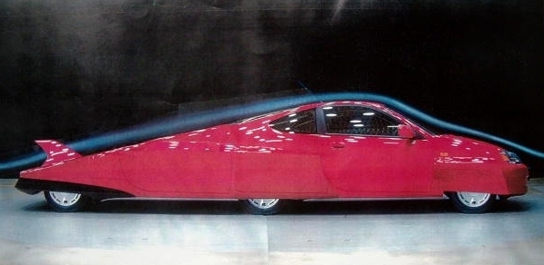

mezmo wrote:Also, I wonder if a heavy spandex like stretchy fabric panels
would work in a similar fashion between the tow vehicle and trailer.
I think that is what Honda did with this one-off baggage trailer behind an Insight. The with-trailer drag was significantly less than the bare car - though they did add front wheel spats at the same time.
