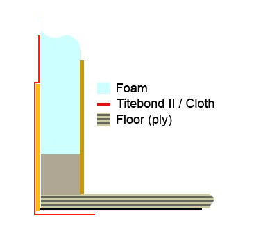

Been thinking about the 1.5" foam and the joint to the floor.
The image below uses a piece of wood 1.5" x 1.5" glued to the foam and screwed from below. Then with the 1/8" ply fixed to both the batton and the foam. It then has the normal TB2 / Cloth skin
I think this would be stronger than "normal" the TB2/cloth both sides join

Cone what about running a strip of ply along the outer edge too , forming a sort of "taco" the foam would slip down into.. That would pretty much move all the stresses to the wood areas...mechanical fasteners in abundance.. no longer relying on the glue for attachment of wall to floor ... :thinking: Image

While the taco sandwiching is interesting, I don't think it's necessary.
The canvas is pulled tightly against the foam and wrapped under the ply floor (held with staples as needed) and then becomes rigid after the glue dries. The inside ply makes more sense because the pressure from the canvas is towards the inside. I think the outside ply just makes an unsightly bump to canvas over. Even on something as big as a standie, I think the outer ply is unnecessary and might even cause a place of weakness due to foam flex under bumpy driving conditions.

GPW wrote:Cone what about running a strip of ply along the outer edge too , forming a sort of "taco" the foam would slip down into.. That would pretty much move all the stresses to the wood areas...mechanical fasteners in abundance.. no longer relying on the glue for attachment of wall to floor ... :thinking: Image
Its another great idea, but now who is over engineering :lol:

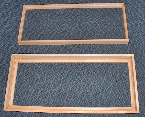

Got my window and inner frame (mock up) done , working on the outer frame now... Image
Once everything fits , will take it all apart and coat it with the "secret Jedi waterproofing formula "... :o (min and poly ... you know ) except where the glue joints are (taped off) ... A little silicon in the rabbet and we should be able to screw it all back together and install .. Hopefully ...

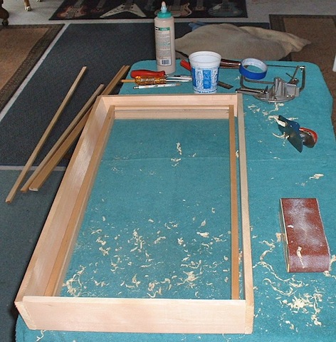

Got the outer frame done ... Fits , plenty of room for rubber seal ... You notice I angled the bottom of the window outer frame out so the water drains out ... much like a standard house window ... Image

Thanks Eagle !!! Here's the window and frame with the stops installed ... there's just enough space between the stops and the window itself for a 1/4" rubber gasket all around inside ... that should keep the water out ... If it ever rains here again ... :roll: Image
Ps. the bowed looking frame on the bottom is an optical illusion ... camera lens distortion ... It's really dead straight ...
