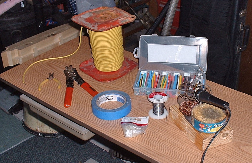

On to the wiring ... We were wondering if running the trailer light wires through the FS body (inside) would offer any advantages to the wiring longevity ... But running the wires outside (like every other trailer in the world ) would be easier ... :thinking:
We’re running a separate Ground wire to each light , and to the trailer chassis ... just a little extra insurance we don’t have any grounding problems in the future ... just one more wire ... and we can always pick up a ground off the trailer frame if we need it ...
Ps. each connection will be soldered (not crimped) and then shrink wrapped ... more security in our infamous Humidity ...
Now here’s a Thrifty trick ... in the past when we bundled wires , we used common black plastic “electrical” tape ... which did a good job of isolating and wrapping the wires , but soon started to come unwrapped at the ends ... :o Now , we use a couple wraps of Masking tape (paper) over the ends of the electrical tape wrapping ... and that does a good job of keeping the wrapping intact ... As we know , after leaving masking tape on for a few days , it becomes permanent ... very difficult to remove .... working perfectly for this job ... a “keeper” tape of sorts ... Hey , it Works !!! ;)
Re: FoamStream...
Postby GPW » Sun Sep 08, 2013 9:05 am
Got all my wiring tools together .. You can see my DELUXE soldering station ... :D
Re: FoamStream...
Postby GPW » Sun Sep 08, 2013 12:12 pm
Got the wiring all done ... not hard at all to do .... went on the outside like everybody else... Went to test it out and the 7 pin adapter from Harbor Freight didn’t fit ... it was too fat .. :o :roll: ... isn’t that a pickle ? ... :R The original receptacle was installed by the RV dealer , and I wouldn’t put it past him to use something that didn’t fit anything else ... and only he could supply the parts , he was a shifty B*****D ... :twisted: HUSKY Towing products ... :NC
