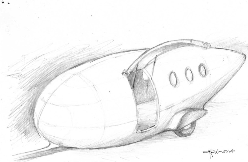

Re: Foamie aerodynamics.
Postby GPW » Sat Mar 01, 2014 9:20 am
just a rough sketch ... Certainly not an Easy build ... but possible ... :thinking:
Postby rowerwet » Sat Mar 01, 2014 9:24 am
did we ever come up with an easy method of forming foam panels using heat? if we could get them to the "wet noodle" stage, any shape would be easy to mold, and permanent once cold.
rowerwet
Posts: 2075
Images: 521
Postby GPW » Sat Mar 01, 2014 9:29 am
190F does it ... and then a mold to cool over... many possibilities there huh ? ... 8)
Postby rowerwet » Sat Mar 01, 2014 9:31 am
did we come up with an easy method? I keep thinking of a salamander heater, but then I'm not sure of the heat out put
rowerwet
Posts: 2075
Images: 521
Postby rowerwet » Sat Mar 01, 2014 9:33 am
or a steam box idea, but big enough for 4x8 panels... :thinking:
rowerwet
Posts: 2075
Images: 521
Postby GPW » Sat Mar 01, 2014 9:37 am
Row , there’s the Rub !!! A big enough “device” to put a whole sheet of foam in :o .... Impractical for just onsey’s and twosey’s ... Unless of course you're an “addicted” Foamie' builder ... like me... :oops:
