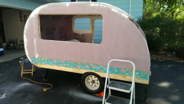

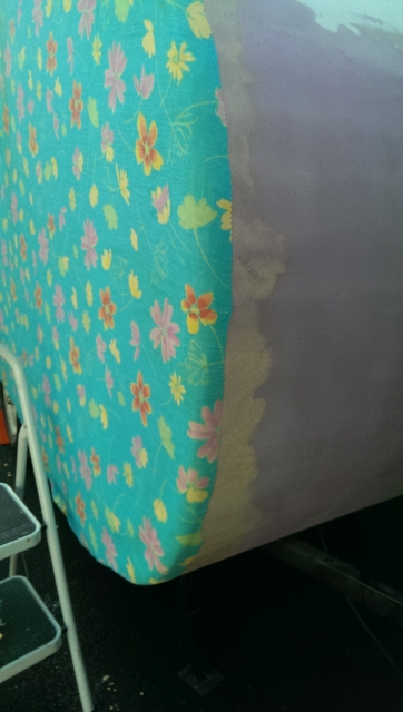

So this weekend I did get the linen on the outside of my trailer. This post has a lot of pictures but probably not as many as I'd like. I missed a lot of steps due to being gluey.
As with so many things the prep took SOO much longer than the actual covering.

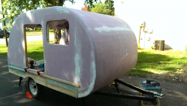

I used about a gallon of TBII on the outside I started with about a 1/4 bottle left in one bottle and ended with just a bit under that in another. I think the linen being so much lighter and thinner just takes up less glue. I used a 1/4" nap roller. I sanded all the foam with 80grit until it was suede like instead of shiny.
I also last week got a new TV, Image and we had a visitor while we were working. I am pretty sure my neighbors were having another one of those what the hell are the crazy white ladies up to today weekends though. EVERYBODY was driving by REALLY SLOW. Almost nobody stopped to say hello, except this big fellow. Image

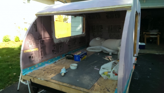

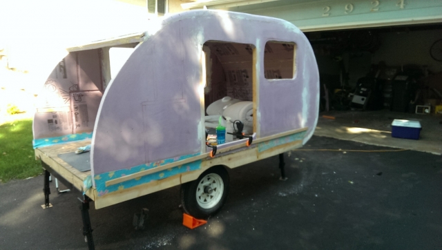

Here is where we started the day: I rolled the trailer into the driveway. You can see the bias linen reinforcing strips I already glued on for the floor join. I am pretty sure this was the first trip out of the garage. We finished sanding and pricking the exterior.
We had lunch sitting in the garage. Too many bees in the grass.

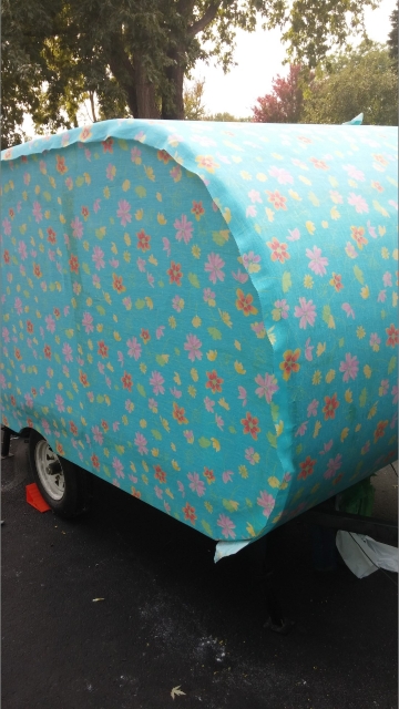

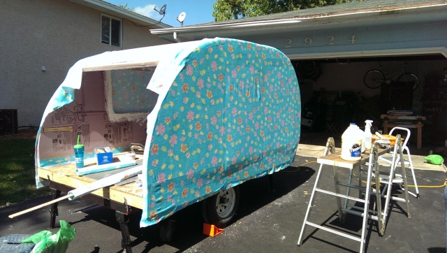

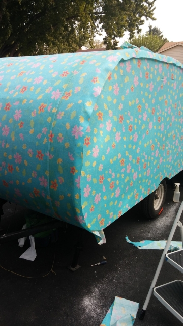

We put both sides on first and then went back and trimmed and rolled the edges over the radiused curve. I ended up doing that curve with a surform plane and then going back and cleaning it smooth with the sander.

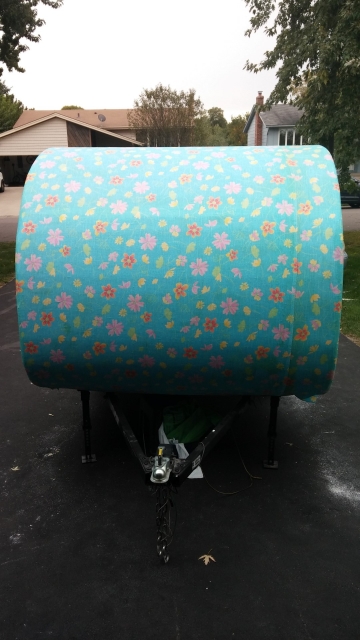

We then went back and marked the top for the placement of the narrower strip of linen (trailer 66" wide linen 60" wide. So we cut an 18" wide piece and lapped it 12" on the top and 6" to roll down over the sides.
Then we lapped the 60" wide piece over the narrow piece and hanging off the edge some as well. During this process it was super handy to have a scaffold on one side of the trailer and a step stool on the other (two scafolds would ahve been genius) and two helpers. One on the ground running around with a squirt bottle of water for our hands and the glue roller and brush. And one of us on each side of the roof.

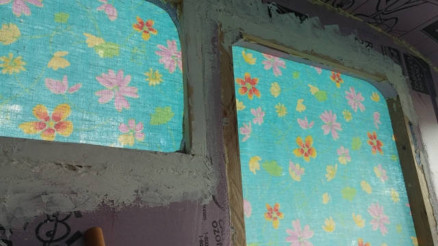

Apparentely neither photographer could resist a picture of the sun coming through the window openings and linen. We just each got a different side.
The view from inside:

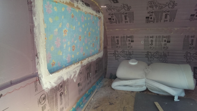

I then went and did the inside of the roof on sunday morning. I learned at TON. sadly mostly too late. so I will share for you all.
  • while stretching the fabric on the outside is great.You cannot stretch at ALL on the inside. or as it starts to dry and shrink it pulls away from the inside of the curves.
  • TBII washes out of hair much better than GG.
  • right before you cut your kerfs go ahead and do the bulk of your interior sanding while everything is flat. I'd let the exterior sanding wait since inevitable garage dings will happen but the inside of the roof was a BEAR to sand.
  • staple gun is your friend, I stapled a lot
  • if you wrap your fabric around a thin light stick you can keep it rolled and held out of the way with only one hand all the way across the trailer. I used a 1/4" strip ripped off the edge of a 2x4 outside it was long inside I cut it narrower than the fabric by an inch or so.

Re: Superlegerra -ish 5x9 foamy - Outside Covered!
Postby GPW » Mon Sep 22, 2014 11:31 am
LT, that came out really really NICE !!! :thumbsup: :applause: 8) Yes covering the inside is a bit tricky eh !!! :frightened:

Oh, and that print may show through the paint, even after two coats. The background of that fabric looks to be a blue-green and I understand that green is one of the hardest colors to cover over with paint. One room that I painted needed 3 coats before the mint-ish green walls didn't show through. But also, I never used that brand of paint again. Having the flower print lightly show through might be a nice feature. Once you get a little paint on, you'll know.

Thanks for the nice comments everyone! Tonight we finished covering the insides. I definitely need to do something about the two places where the fabric pulled away from the inside curve. Maybe injecting glue underneath and using sticks to push it up.

Postby pchast » Mon Sep 22, 2014 10:06 pm
HI.
If it pulled away more than a small bubble its because its too short from shrinkage.
You will likely need to cut it and add a patch of some sort. I did my roof in 6-8" strips
and still ran across it in one place.

Postby lthomas987 » Tue Sep 23, 2014 5:06 am
pchast wrote:HI.
That is really valuable info!
Linen is super stretchy when wet. So if I squirted somewhere to much that would explain it.
