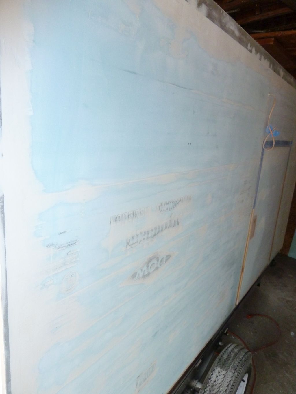

Finished sanding the sides (the roof has already been sanded except for the flashing edge. Will do that later). Tomorrow the finish spackle coat & sanding, then it's perforate & apply canvas !!!
Make the usual amounts of divots digging the edge of the sander in :R
Found a beauty of a divot from clamping the galley vertical when doing the GS glue-up. All will buff out :twisted: :twisted:

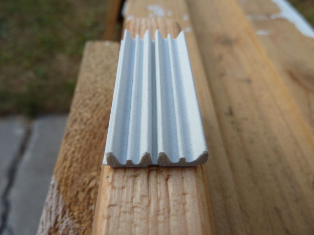

Edit: added pic of gasket planned for doors
Door gasket - sample.jpg (85.24 KiB) Viewed 23163 times
Spackle sanded 1.jpg (72.78 KiB) Viewed 23171 times
Spackle sanded 2.jpg (115.6 KiB) Viewed 23171 times

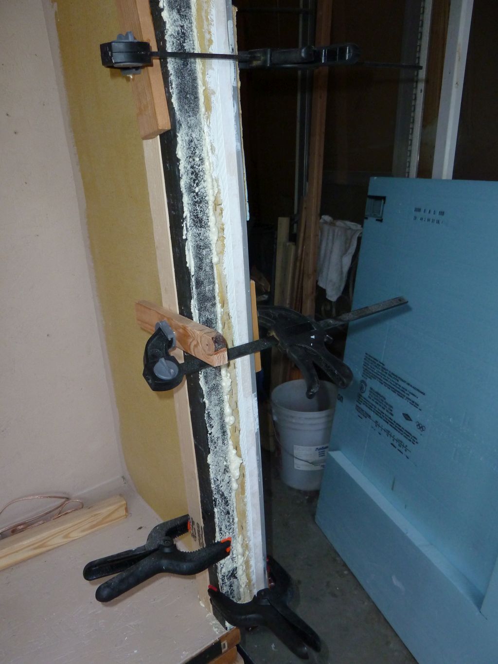

Postby Fred Trout » Fri Jul 10, 2015 10:51 pm
Cool ! Gonna be a while before we make it down to Nawlins tho :lol:

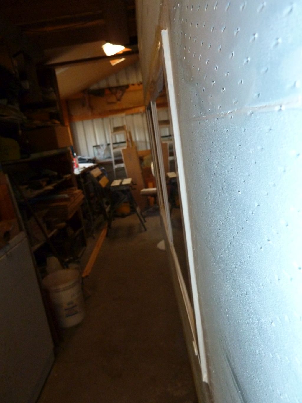

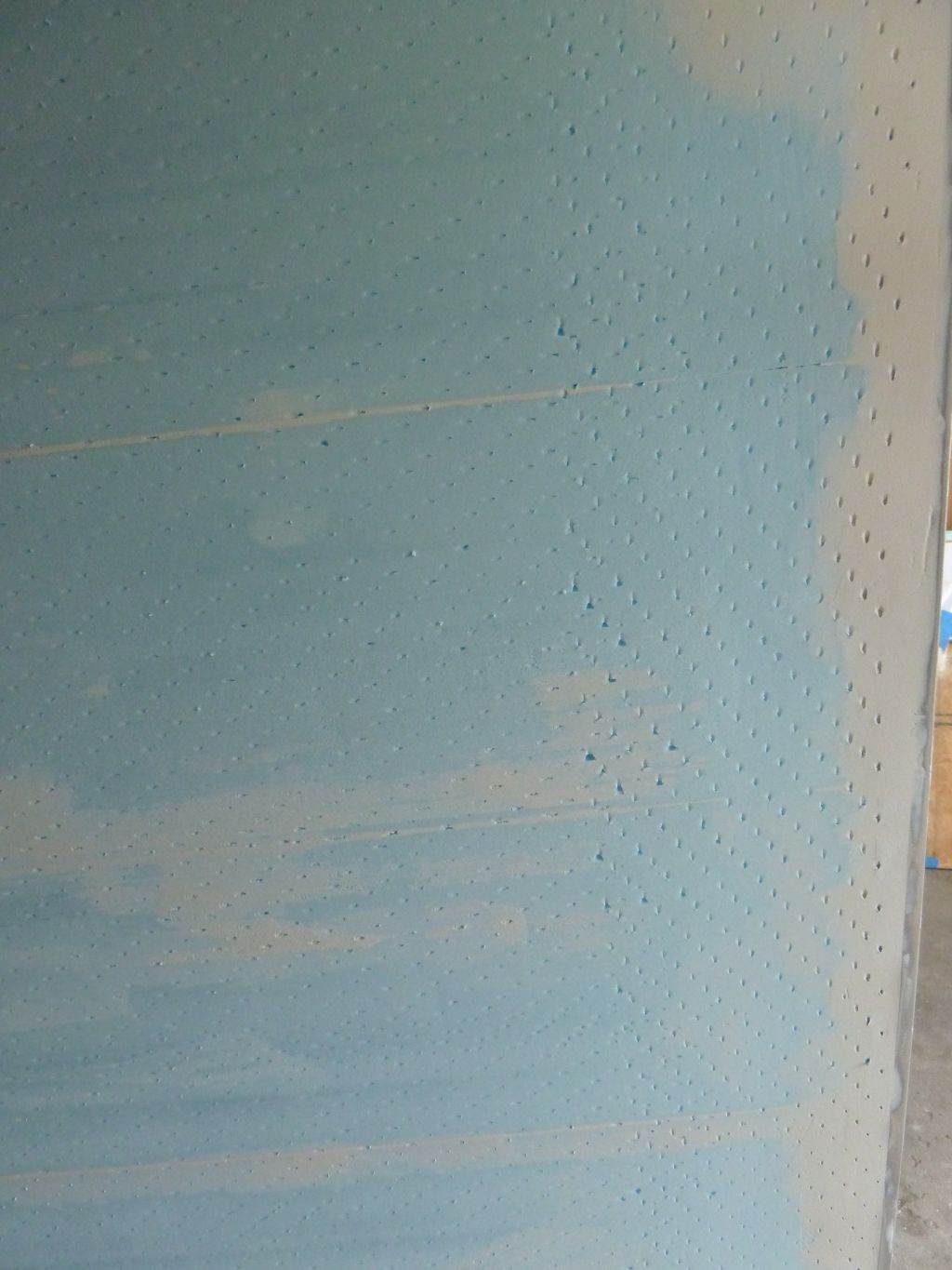

Finshed fairing, sanding, vacuuming, wet wipe-down, & perforation. Tomorrow I start with the bottom reinforcing canvas strip followed by side canvas Sunday.
Pix:
Ready for canvas.jpg (139.2 KiB) Viewed 23113 times
Door frame GS glue-up.jpg (165.2 KiB) Viewed 23113 times
DOH - Put GS on wrong edge.jpg (175.42 KiB) Viewed 23113 times

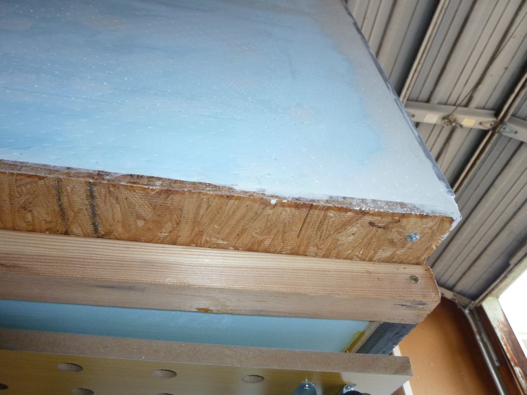

Postby Fred Trout » Sat Jul 11, 2015 8:19 am
Got the TD up on sawhorses this morning so I can work underneath. Kind of a pain when the trailer is in the way :R :R
pix:
Canvas 1.jpg (171.56 KiB) Viewed 23092 times
underside edge - need to remove temp screws
Canvas 2.jpg (123.44 KiB) Viewed 23092 times
perforator used to give the TB II more bite
Canvas 4.jpg (113.65 KiB) Viewed 23092 times

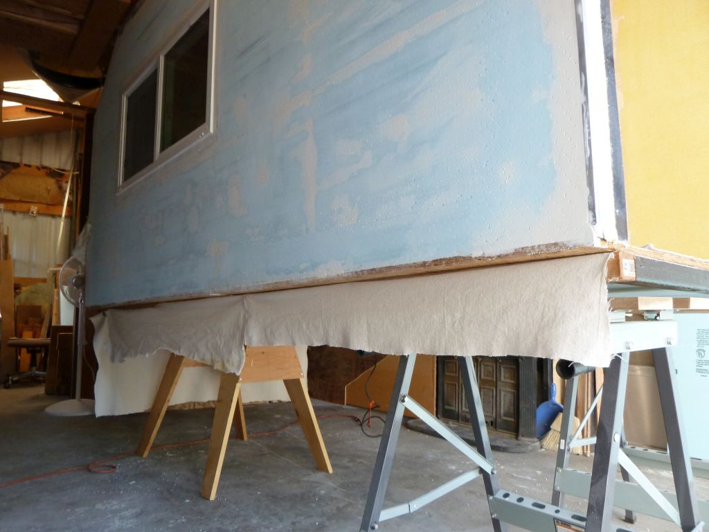

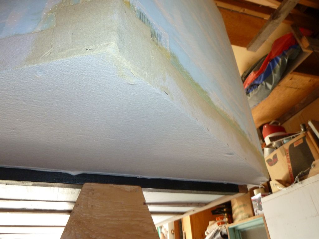

Postby Fred Trout » Sat Jul 11, 2015 12:38 pm
Stapled canvas strip to 2x2 floor support, applied TB II & smoothed it on. Doubled the layer at the nose - figured it was the most stressed point where 2 walls & floor joints were. Finished wall to floor reinforcing strip. Gotta wait for it to dry & do minor touch ups before I apply wall layer. Will spackle & sand any lines that show thru from canvas layers underneath to get a smoother final surface.
Pix:
underside of front angle got canvassed

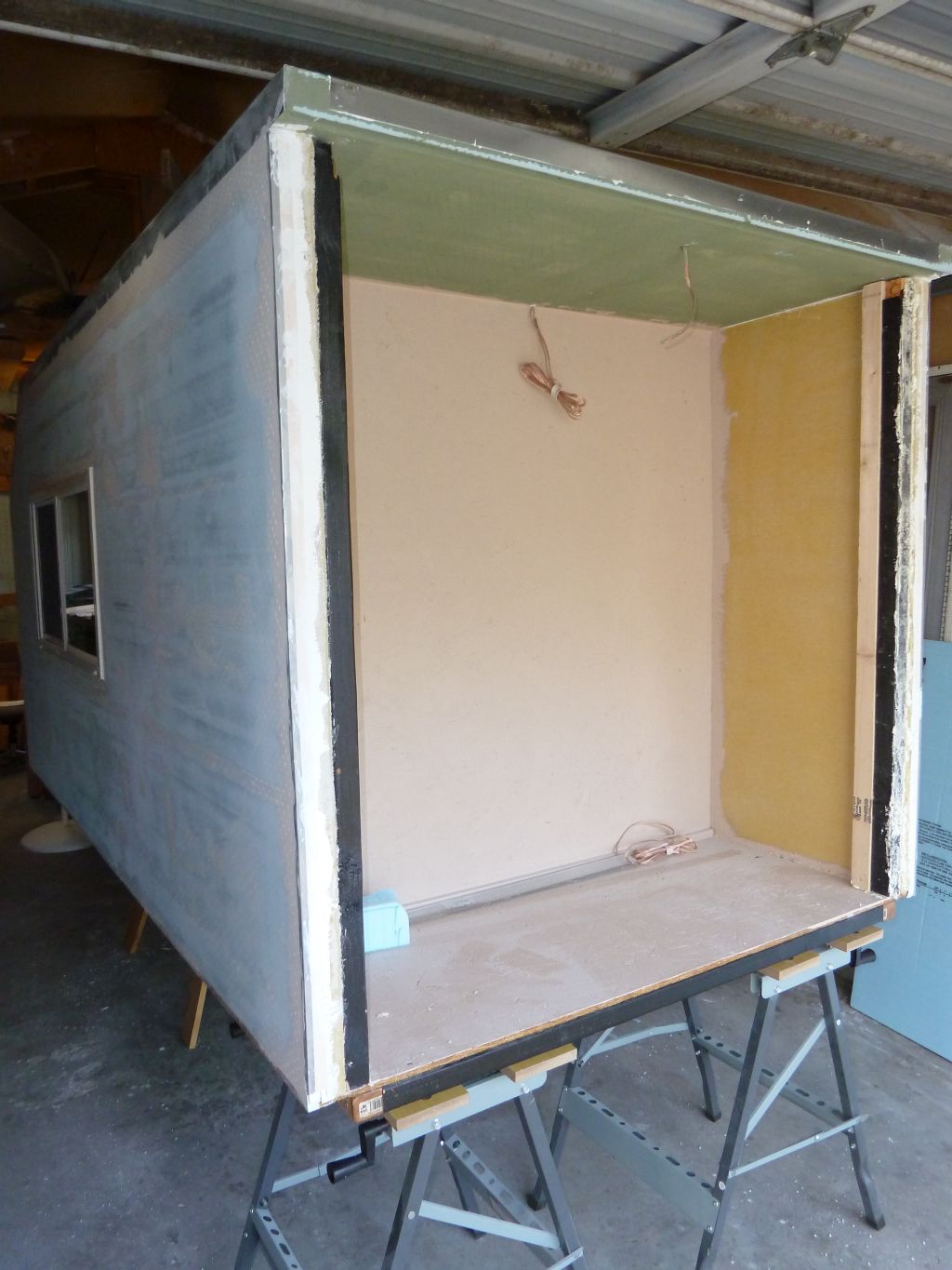

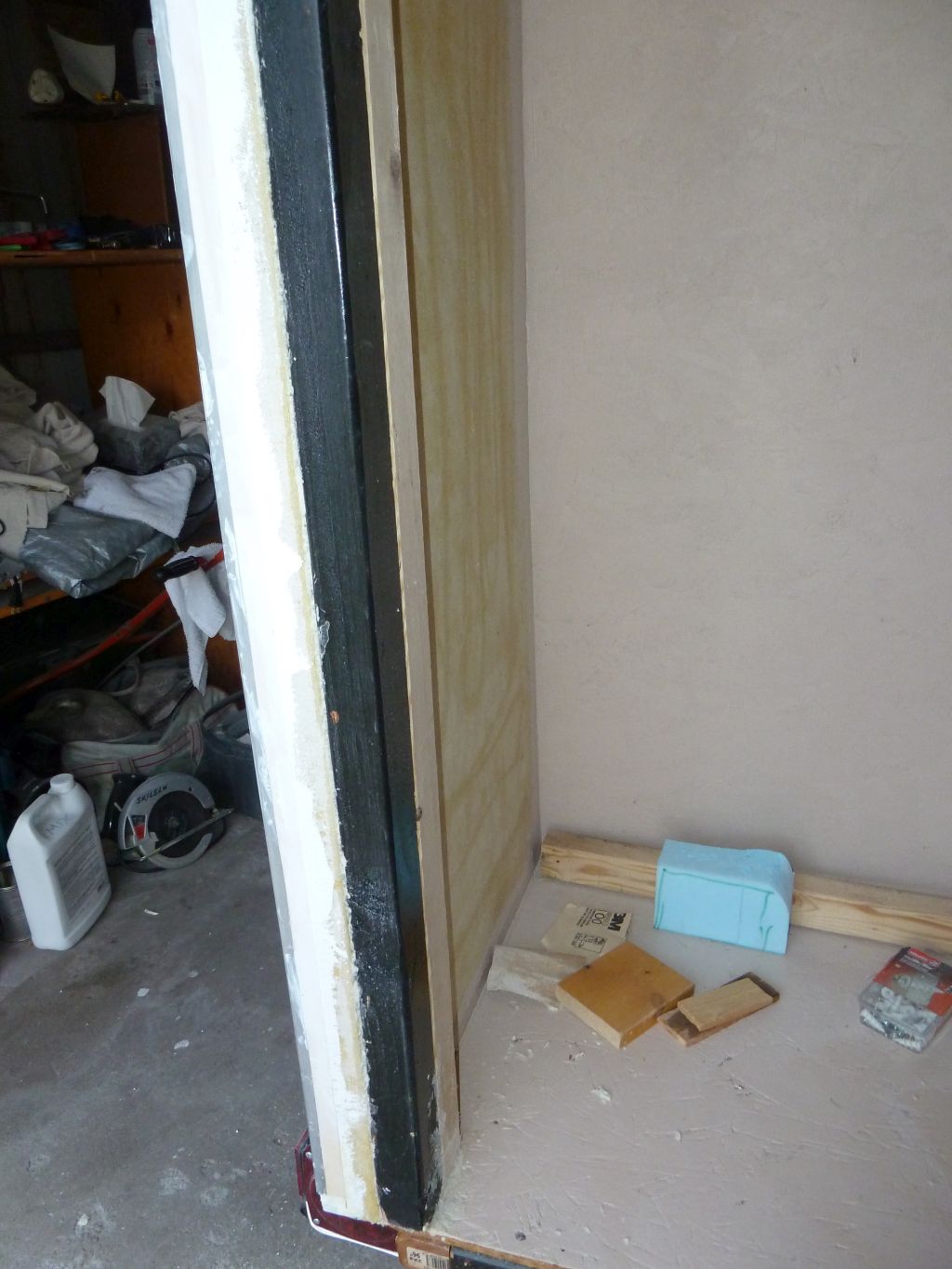

My drywall technique is pretty decent after doing the interior of my entire house. First room was pretty pitiful (and could have used your advise back then) but the last came out pretty close to professional considering I am a computer nerd. Pretty difficult to see any edges there anyway.

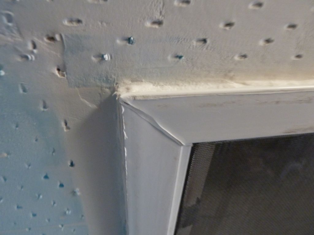

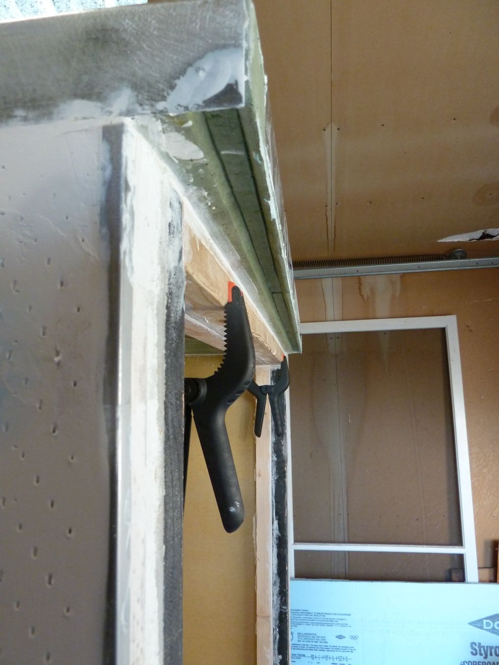

Spackling for canvas is nowhere near as demanding as a smooth paint semi-gloss finish. Just finished sanding the canvas edge w/TB II standing proud and galley supports where I foamed the wrong vertical edge :lol: Spent some time getting all the flashing flopping edges glued down, put in the last galley support frame member, caulked the edges of the entire galley support edges/cracks/divots/etc. prior to covering all with canvas tomorrow.
Pix:
note the drip edge - was a pain to get the canvas stuck in there before it all fell out (paint sticky fail)
Galley door frame support.jpg (163.5 KiB) Viewed 22997 times
finish detail of window, foam inserts, caulk, spackle
Window detail 2.jpg (87.47 KiB) Viewed 22997 times
the edge of the vinyl window has been caulked
Window edge 2.jpg (158.14 KiB) Viewed 22997 times

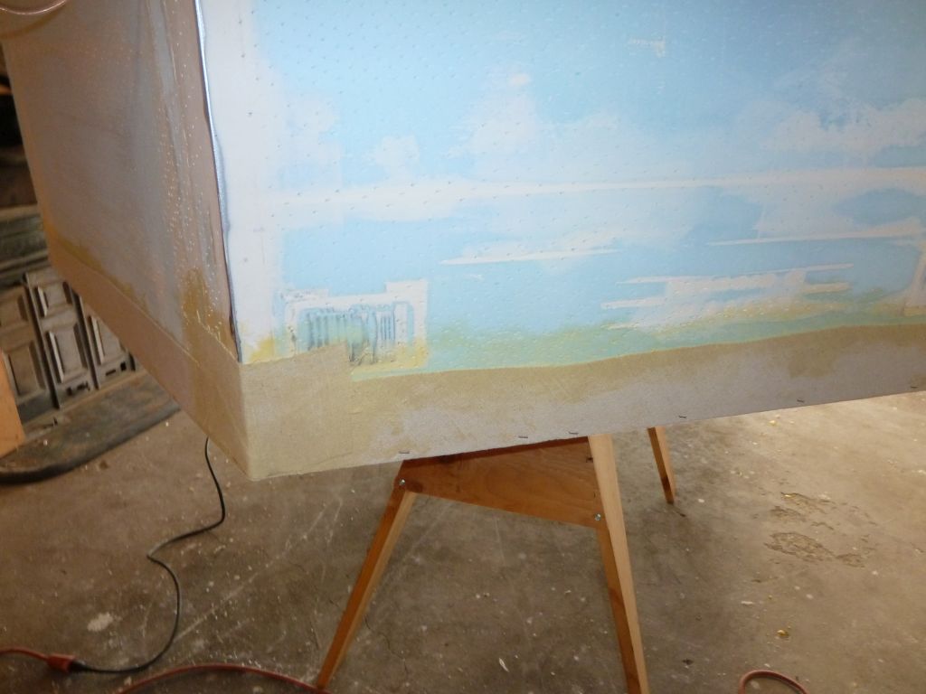

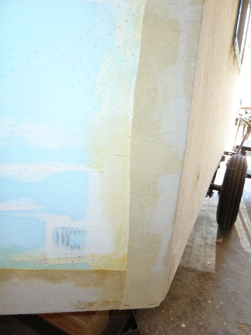

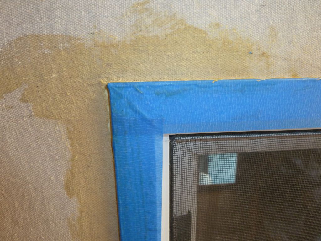

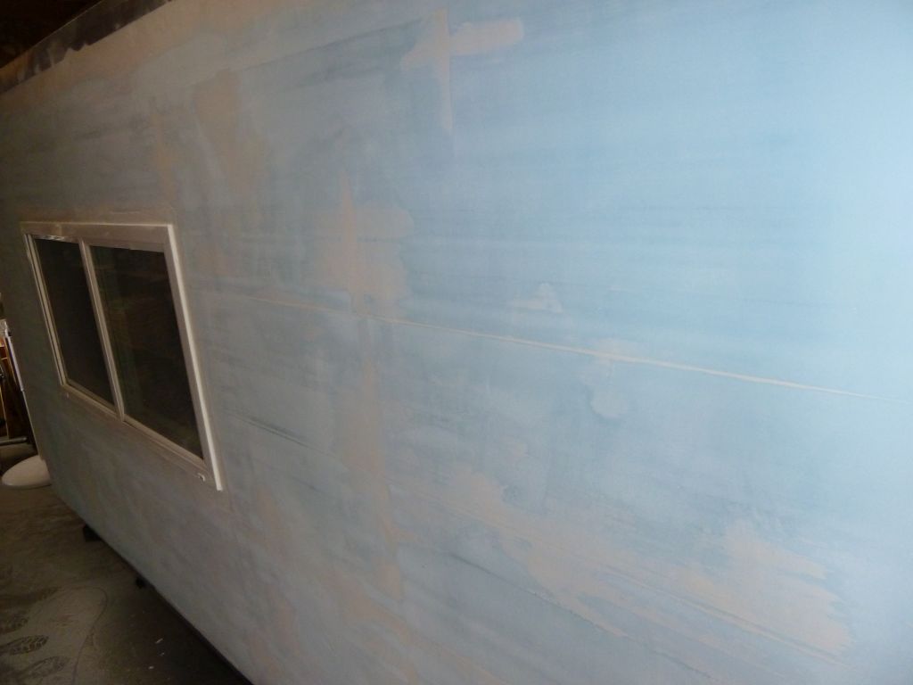

Postby Fred Trout » Mon Jul 13, 2015 2:46 pm
Lunch hour and the left side is done including persnickety overlaps & edges trimming. No serious problems apparent yet but all will show when we paint :R
Pix:
