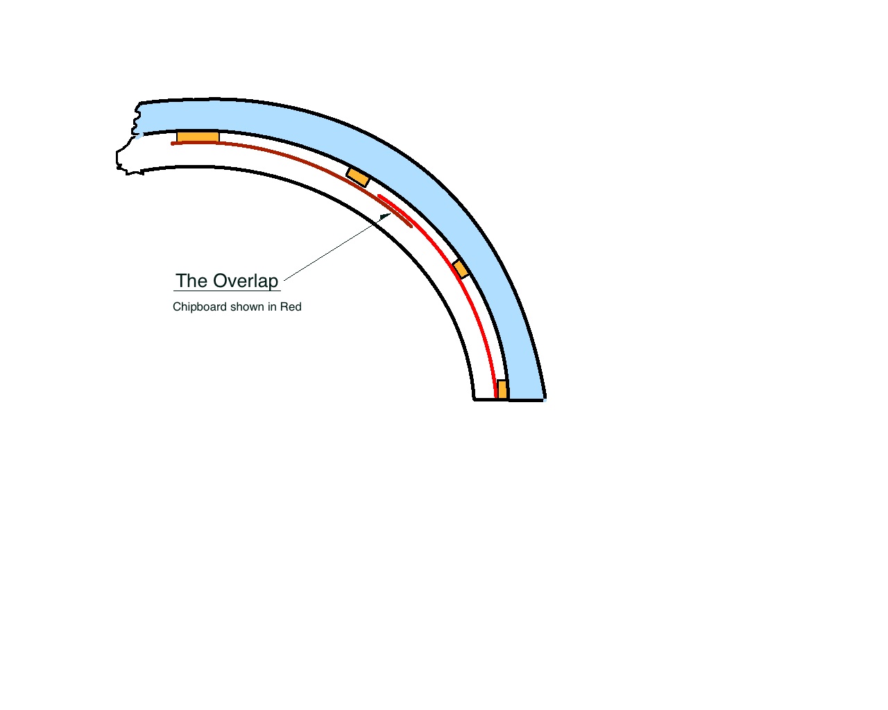

Studying the nose of the trailer , the layout , we’re thinking of using an overlap on the chipboard to make only Two panels , one each side , the overlap will be glued in the center and is ~ 6” so it will be even stronger and more easily attached ... Otherwise we have to cut 6 individual panels ... AARGH !!!! :roll:
Here’s a top view ...

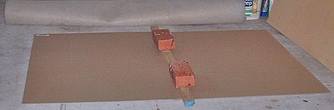

Here’s the two pieces glued together to make one panel ... TB2 and Newton clamps ... :thumbsup:
BTW, the overlap ended up at 3” after we carefully re-measured the front , again .. :oops:
Re: FoamStream...
Postby KCStudly » Wed Sep 25, 2013 2:17 pm
Plan view looking down thru the lower single curve of the front wall, I take it?
Re: FoamStream...
Postby GPW » Wed Sep 25, 2013 3:38 pm
KC, yes , that’s right !!! Sorry I wasn’t clearer about that ... :oops:
First panel dry , (I only have two bricks ) Gluing up the second panel now ... :D

Postby GPW » Wed Sep 25, 2013 6:06 pm
First panel done , second under the clamps (bricks ) drying .... The seam is hardly visible from one direction so will be used on the inner wall that way ... :thumbsup: TB2 and this chipboard seem to love each other , producing a nice tight seam , completely dry in a few hours ... Once it’s trimmed to fit , we’ll use the mix (or maybe the Gripper since have almost a gallon left ) to waterproof it before painting and fixing to the wall with screws... Simple ... and less weight too using only 4 out of 6 sheets ... ( two left over for the Next project ! :R :lol: :roll: ) 18# instead of 28# ... 8)

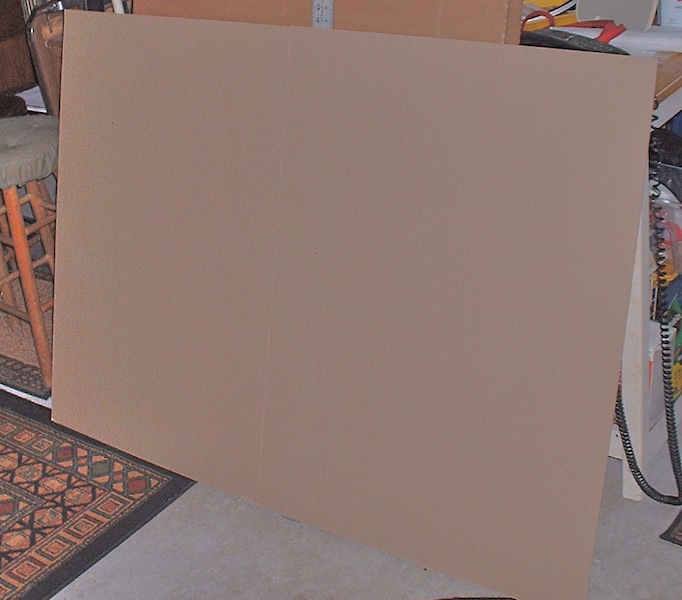

Postby GPW » Thu Sep 26, 2013 8:59 am
Got the panels test fit ... At first , just placed the chipboard up against the ribs and scored a line around the top .... then added a 3/4’ line below that to compensate for the ply rib thickness . Cut it out with a utility knife , having to score it several times for the cut ... Popped them in , and they fit ... exact :dancing ... This pic is with the panels just pressed into place ... seams facing the inside of the trailer , thus invisible ... Looks Good to me... once painted I’m sure it’ll will go largely unnoticed ... ;)
