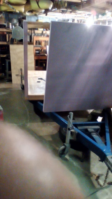

Postby pat g » Sun Oct 28, 2018 9:03 pm
This is early on in the construction of my new foamie. The floor is a composed of 1/2 inch ply, 2 inch foam, and 5mm underlayment. All interior walls are skinned with the 5mm underlay. The walls are connected to the floor with cleats.

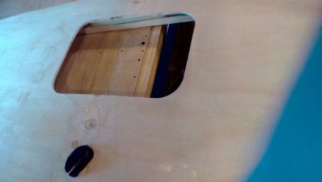

Postby pat g » Sun Oct 28, 2018 9:09 pm
I cut out the window openings before skinning the foam.

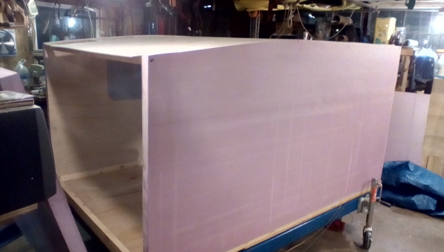

Postby pat g » Sun Oct 28, 2018 9:11 pm
Walls up, spars in, and interior ceiling ply in.

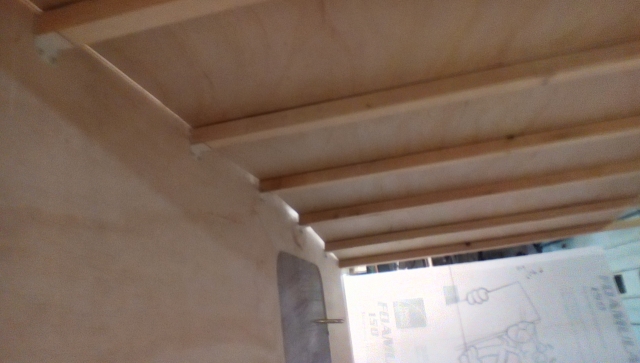

Postby pat g » Sun Oct 28, 2018 9:16 pm
A look at the 1.5 x 1.5 inch spars spaced 16 inch on center.

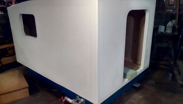

Postby pat g » Sun Oct 28, 2018 9:21 pm
All skinned and primed. This shows the rear entry which is offset to allow the addition of a vent and ac vents in the wall next to the door. The roof, front, and rear walls are skinned with 1 piece of canvas from Big Duck.

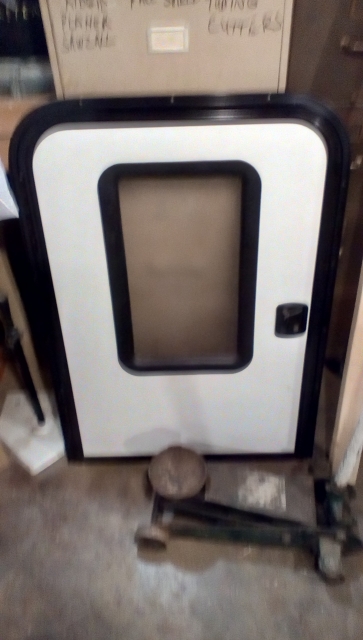

Postby pat g » Sun Oct 28, 2018 9:39 pm
This is my door from Tri State.
