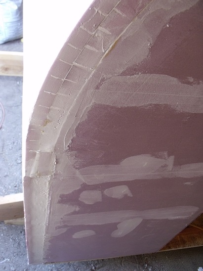

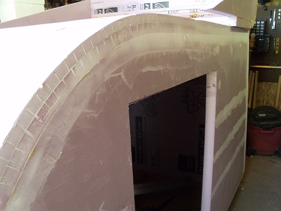

Did a bit of fairing today. A few more applications and I should be ready for the edge trim.
Fairing2
DSCF2149 small.jpg (114.73 KiB) Viewed 1372 times
Fairing
DSCF2148 small.jpg (94.23 KiB) Viewed 1372 times
George.

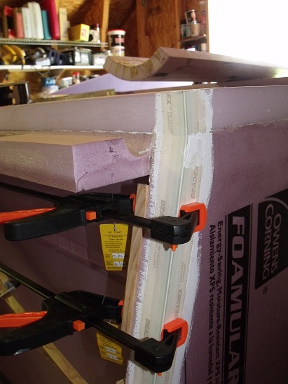

Really Nice the way you did the kerfs so it’s pretty inside too ... Is that roof really 4” thick ? That’s just Gotta’ be STRONG eh !!! 8)
Re: #1
Postby ghcoe » Sun Jul 21, 2013 7:11 pm
GPW wrote:Really Nice the way you did the kerfs so it’s pretty inside too ... Is that roof really 4” thick ? That’s just Gotta’ be STRONG eh !!! 8)
Well it would be strong if it was but, no.... It is two 1" sheets for a total of 2" to match the rest. Worked out pretty good.
George.
ghcoe
Posts: 1982
Location: SW Idaho
Re: #1
Postby GPW » Sun Jul 21, 2013 9:24 pm
That will still be Strong !!! It’s the curve gives it strength !!! :thumbsup: 8)
