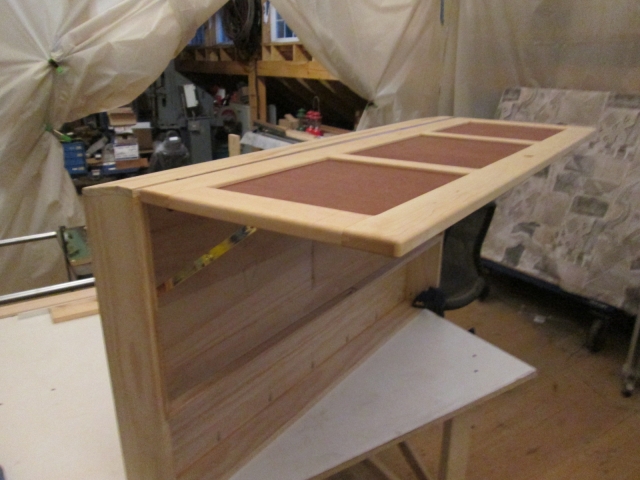

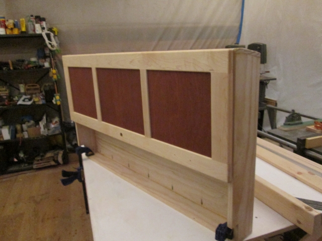

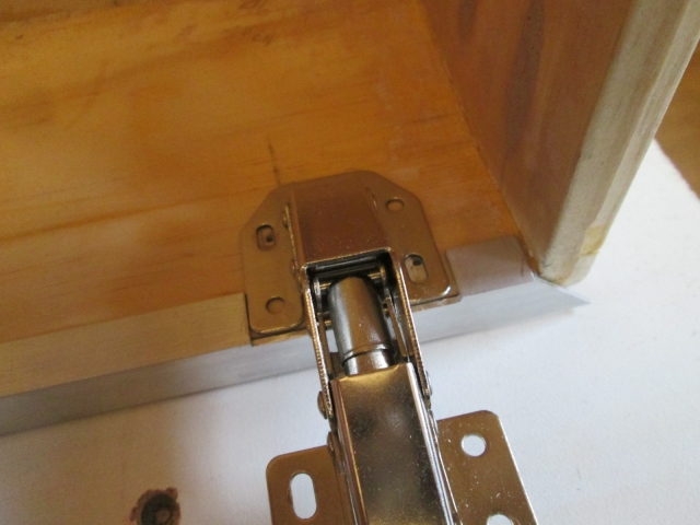

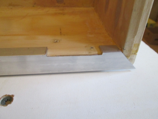

Before I put the polyurethane on the locker door and before I glue the vinyl liner in, I want to complete fitting the door prop strut/lid support. A couple of things have to happen first. I needed to check and see that the hinge alignment is okay or can be adjusted to accommodate the aluminum angle trim. So I miter cut the upper piece of trim to fit the locker opening, marked the hinge locations and milled away the short leg of the angle in these areas. (The top is shown with the locker upside down in these pics.)
I will likely have to trim the miters back a little to accommodate the thickness of the vinyl, and will do that once the vinyl is in place, but I needed to be able to locate the angle now for these operations, so be it.

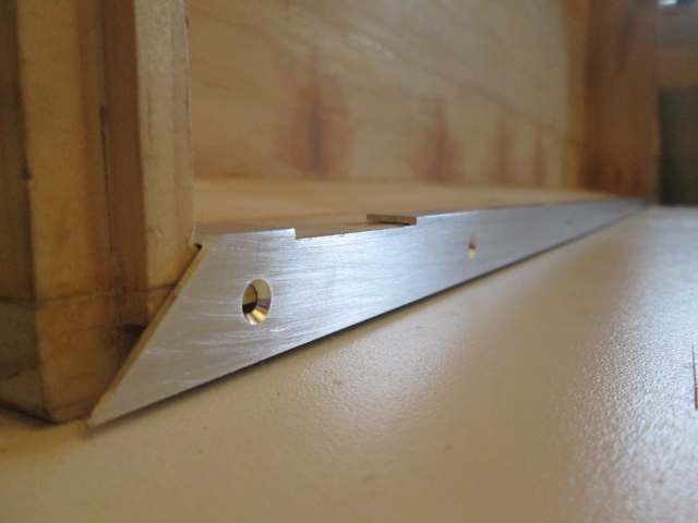

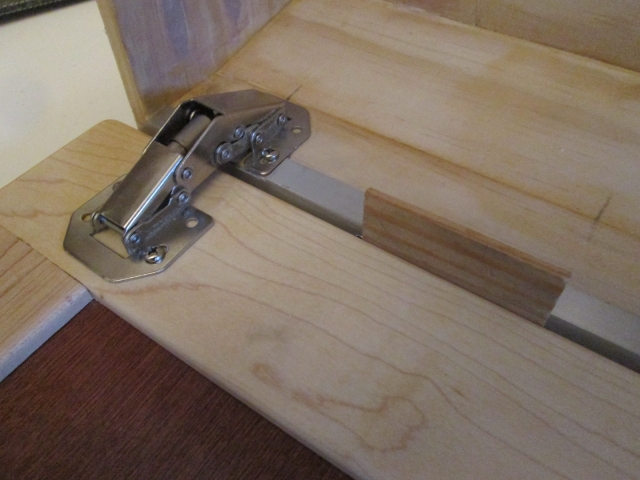

Here is one side with the hinge in position.
In order to hold the trim in place to check the fit of the door, I had to at least put a few of the countersunk screw holes in, but why stop there? Might as well drill and sink them all even if I’m just going to use a couple of screws for now.
Here the door is shimmed away from the trim the proper amount. There was enough play in the slots in the hinges to accommodate the trim, so everything is good there.

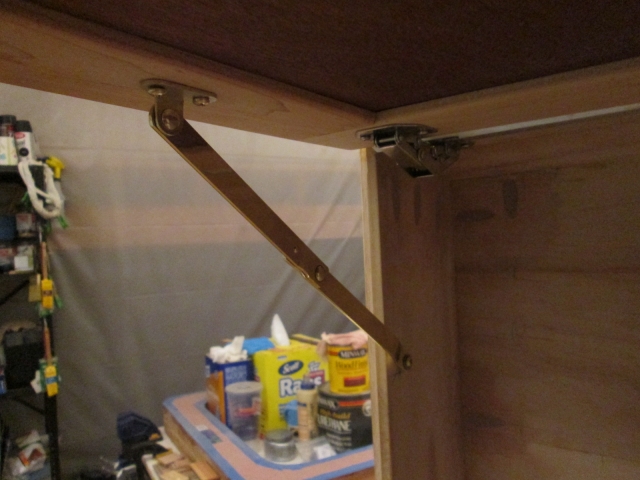

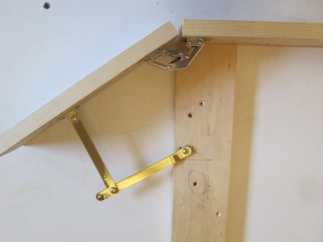

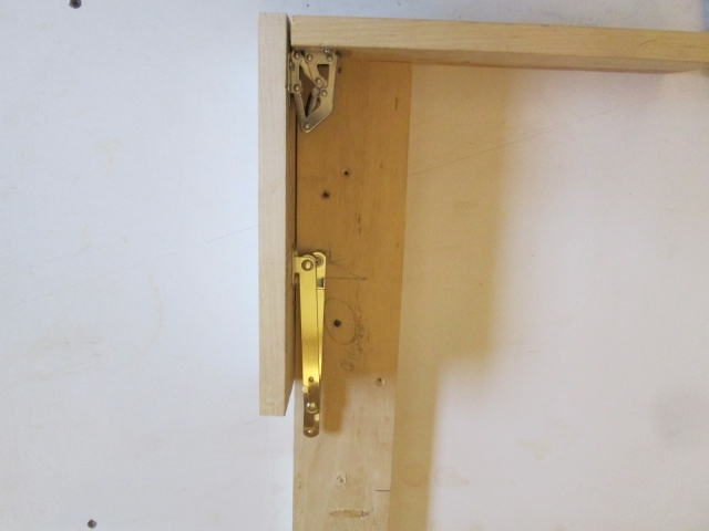

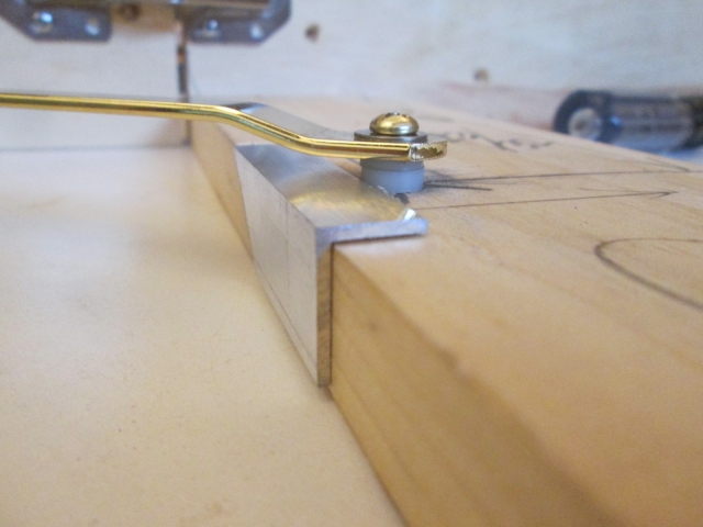

Next thing I wanted to check was to see if the hinged lid support I bought to use as a prop for the door would articulate properly with the hinges. Unlike standard hinges that rotate around a single hinge pin, these hinges have a toggle link that allows the door to swing out, then rotate back inward at the heel providing clearance for the thickness of the door. The instructions for installing the support reference all of the dimensions for attachment off of the hinge centerline. My hinge centerline swings thru an arc and I was concerned that this might cause the support to bind in the closed position, or might keep the door from opening fully to 90 degrees. So rather than using trial and error and putting a bunch of holes in my nice door, I decided that the logical choice would be to make a mock-up.

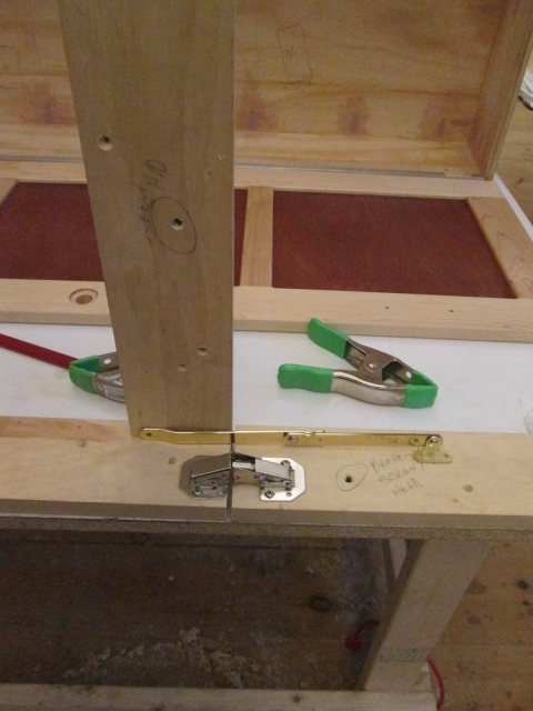

Here I have cut up a scrap (was the router jig that I used to cut the galley wing table blocking recesses) into three pieces and screwed two of them together. The single piece on the right represents the door, and the two pieces screwed together on the left represent the locker case; again upside down. The brass plate strut is just sitting there for now.
Before I can determine how far in from the side of the case to mount the pivot bracket, I need to make the bearing modification to the case side pivot. I’ll do that after work tomorrow using the lathe with the collet chuck. It will be easier to explain with pic’s as it happens.

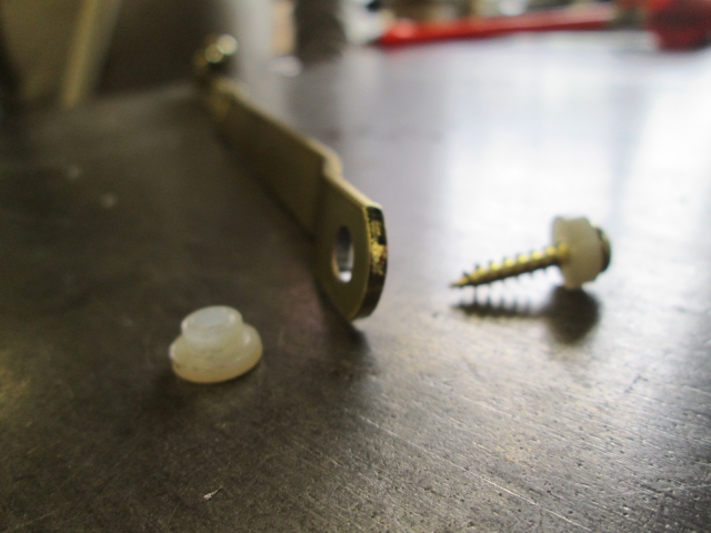

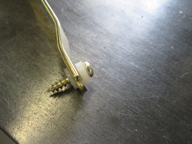

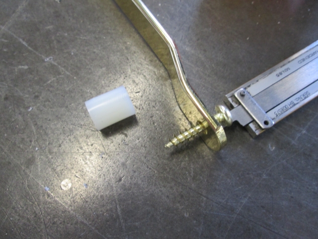

Okay, let’s look at what I did tonight. First I stayed after work a little bit to do the bearing modification on the lid support for the locker door. Here is a better pic of the strut end that mounts to the inside of the case. You can see that there is an offset bend (which was crooked and needed to be straightened) which is intended to keep the bar from dragging on the inside of the case. In the end there is a hole for the screw. So the strut would have pivoted on the screw threads and you wouldn’t really be able to tighten the screw; it would just loosen itself and/or cause the strut to drag on the face of the wood. Also shown is one of the nylon bushings that I bought separately. (The dial caliper under the head of the screw is just there to prop it up for the picture.)
By drilling the hole in the strut larger and making a T-shaped bushing out of the nylon that is slightly longer than the strut is thick, I should be able to tighten the screw all the way down without pinching the strut, and the flange of the bushing will keep the strut from dragging on the side of the case. The fabricated nylon washer shown under the head of the screw ended up being replaced with a thinner stainless washer, but ends up coming into play again later.

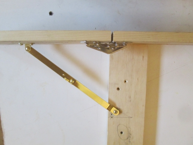

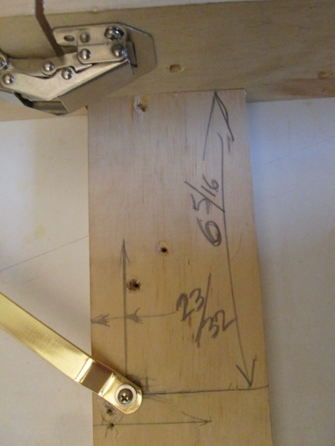

I was right about the hinges throwing things out of spec for the lid support mounting locations. It took several iterations with the mockup to figure out where the ends wanted to be, and I learned that very small variations in screw locations had a big effect in how the strut behaved. Too much separation between the mount points when closed and the folded hinge middle part of the strut could hit the back of the door frame keeping it from closing fully. Move one screw a tiny bit and now the elbow of the strut swings way into the case. I did get the mockup working good tho.
This is a “Left Hand” support used on the left hand side, but it seems to swing backwards to me in this application. For a blanket chest or toy box where the lid is horizontal when closed and vertical when open it makes sense for the left hand, but in hindsight, for this application I think a Right Hand unit would have been better. I think that would have made the elbow of the strut fold up near the hinge instead of down, but no worries; it will work fine.
I took it apart and measured the centers of the final holes for reference purposes.

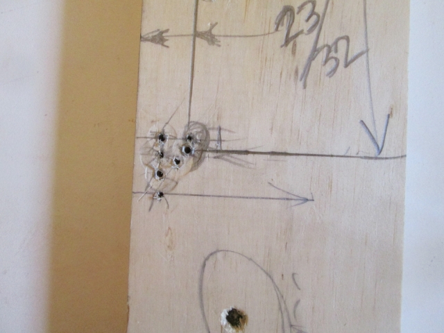

I count 7 holes to get this end right, and at least 3 pair at the other end.

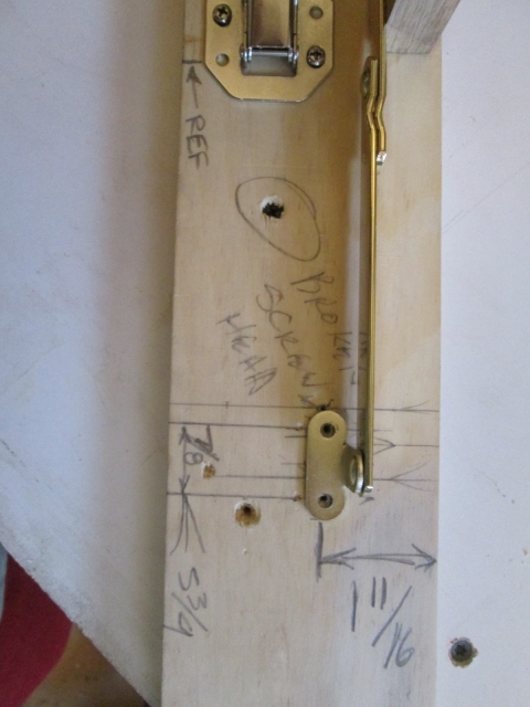

The head of the screw had to stay below flush with the side of the strut to clear the other end when folded, so I went with the SS washer under the head of the screw, but when I realized I was really close to the trim with just the T-bushing, I added the other nylon washer underneath as a spacer; a little thicker than it needs to be.
I might just take another shot at machining a one piece bushing now that I know what it wants.
The stupid thing is that after all of this trial and error, and success and careful measuring, when I went to transfer the info to the real parts the side pivot hole location was off nearly 1/4 inch. With Karl acting as a second set of hands, we set my head lamp up inside of the locker, and closed the door. With me sighting in thru the far side gap between the door and case (the gap will later get filled with the side trim) guiding Karl, and Karl reaching blindly thru the opening in the well section to stick a pencil thru the bushing we were able to make an educated adjustment to the final location for the case side pivot point.
I’m still glad I bothered doing the mockup. I had a much better idea of what needed to be adjusted, how changes would respond, and how touchy the accuracy was. In the end I got what I wanted. The door opens to 90 deg and closes; the one extra hole in the side of the case will get filled and covered by the vinyl; and I didn’t have to put any extra holes in the maple door frame. I do have to remember to reinforce the screw hole in the pine case with CA glue, otherwise I think it will wallow out in time.
