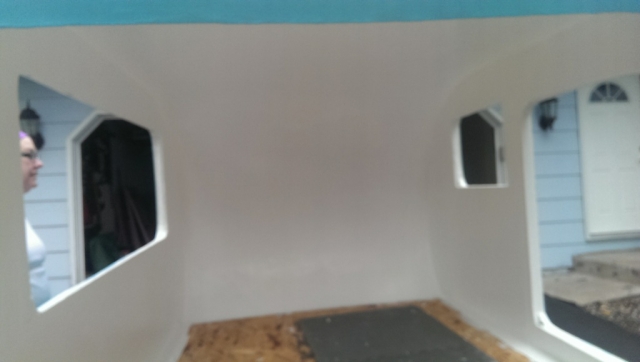

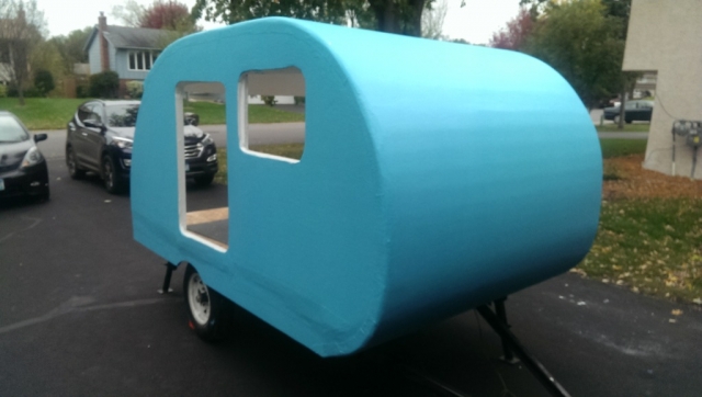

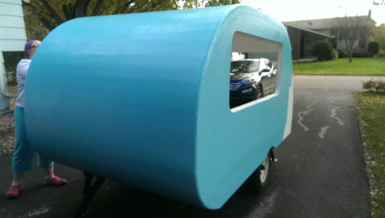

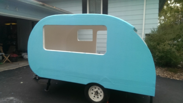

I went with a blue very much like the background of the linen. We used Behr Premium Plus Ultra flat on the outside in blue. On the inside we used the same paint but in Ultra White.
The paint was a dream to work with. We're going to do a second coat tomorrow morning just because we can. I could have done the whole trailer inside and out with one gallon. But I did use two coats of gripper. So the fabric weave was pretty full.

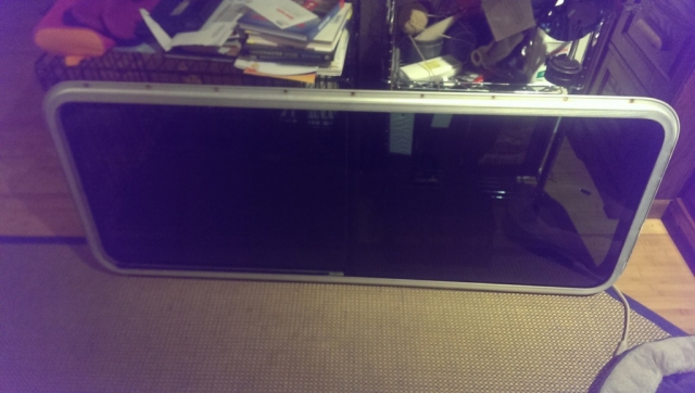

I also started tinting the windows tonight. The little one is done. The big one half done.

Postby lthomas987 » Sat Oct 04, 2014 11:37 pm
[img]
[/img] I know it is a kind of annoying way to post photos. I well fix it later in the week.
But I couldn't resist showing the color.

I tinted my $5 Craig's list windows last night while watching Oklahoma lose to TCU. They look pretty good considering I have never tinted anything and was no good at putting screen protectors on phones was never my strong suit.
Also there's some dig hair in one pane.

Can anybody think of a reason why I shouldn't just mount my windows permanently once the paint is cured? That way they'd stop kicking around the house and garage waiting for me to get them put in place. I've still got to build a hatch and door but I can't think of how the windows would impede that can you?

lthomas987 wrote:Can anybody think of a reason why I shouldn't just mount my windows permanently once the paint is cured?
Unless you have something large that needs to be able to pass through there, like an inner spring mattress, are prefab cabinets, I can't think of a good reason not to.
