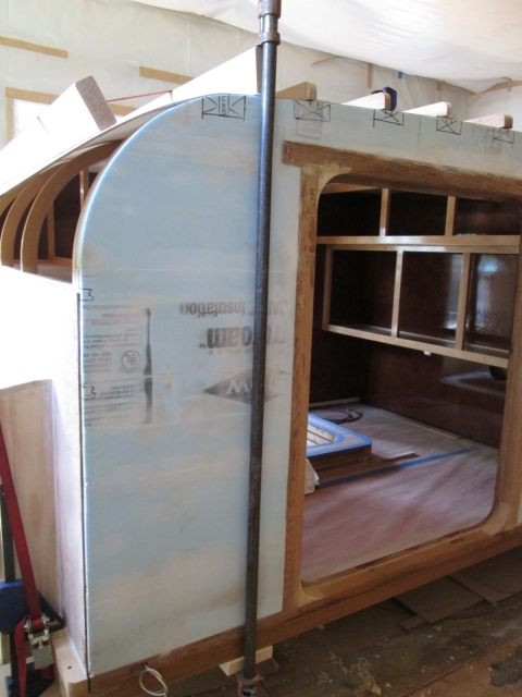

GPW, it is a roof, but I'm not sure that I'm going about this in the right order. I'm concerned that if I can't train the front curve well enough, and have it stay trained while I mask, stain it all, and poly at least the main part of the ceiling, that I will have one hell of a time getting the front to curl again while attempting to glue it down. We'll see.

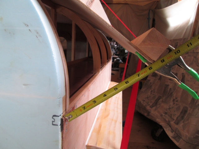

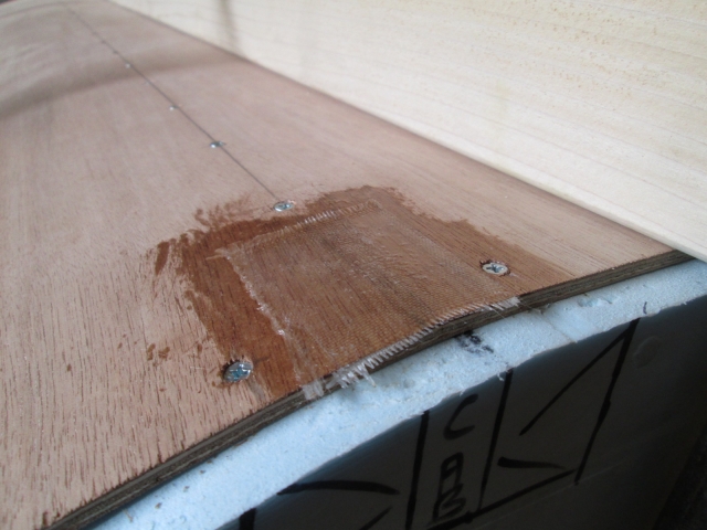

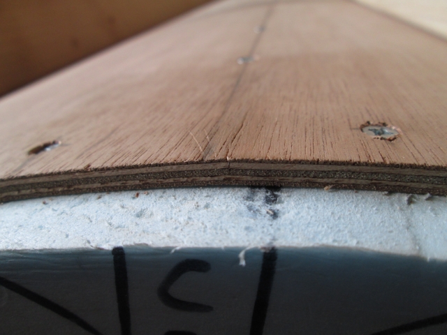

So yesterday I measured the gap between the corner of the front panel and the ceiling panel and it was 12 inches. Before I pulled on that anymore I wanted to address this little chink in the edge of the ply; that little pop I had heard and seen. If you look very closely just to the right of the smudged pencil line you can see a split in the first 3 layers of ply.
I decided to reinforce this area with small swatch of fiberglass tape and epoxy resin.
I had to be careful not to cover the screws over. Here it is from the other direction after it cured enough to trim the little riffle off of the edge.

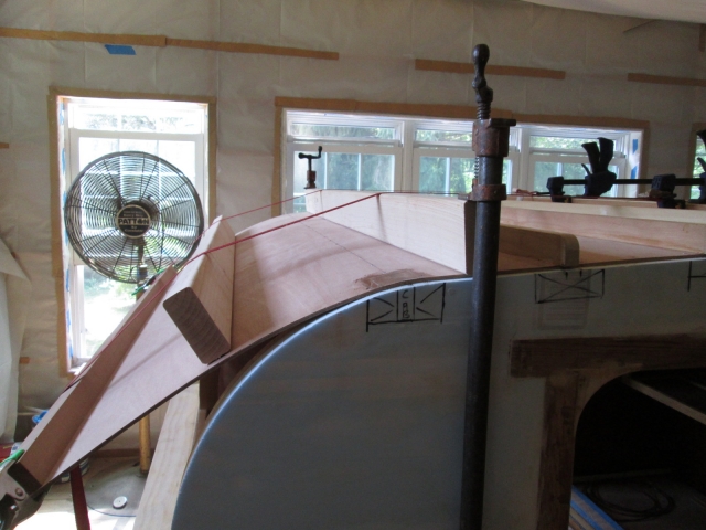

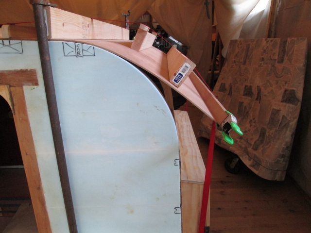

Since this is only a dry fitting the panel was trying to lift between the start of the radius and the first spar. On final installation I intend to glue the main portion of the panel up to the front cabinet face frame, and then do the front radius in a second stage. Once it’s glued on top I don’t think it will be an issue, but for now I added a 2x4 to act as a temporary brace across this area and clamped it down using pipe clamps hooked under the floor.

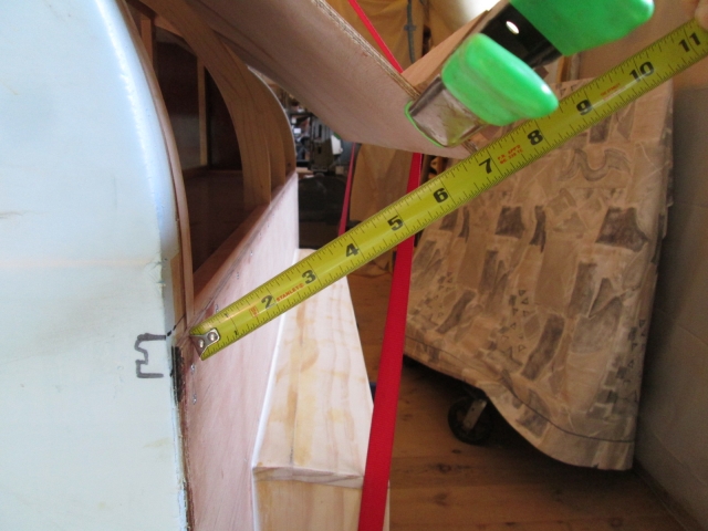

Then I sucked up on the straps taking the gap down to about 8-1/4 inches.
I’m a little concerned because despite the seemingly good progress, there is still a gap where I would like to put the next batch of screws. I can’t screw into the front riblets too close to the face frame because of a conflict with the pocket screws there.

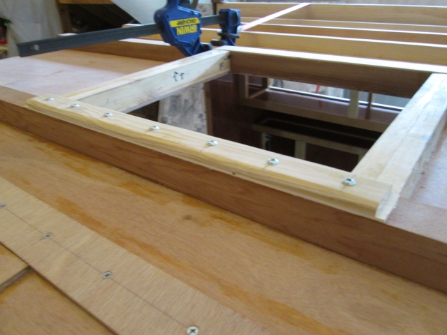

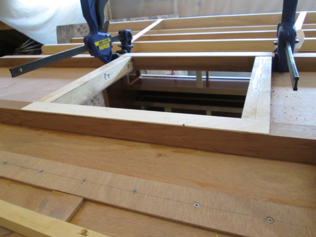

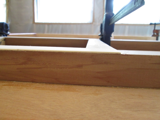

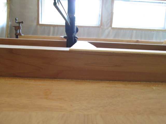

Next I shaved some wedged shaped shims from a 2x4 (actually, I ripped them on the table saw) to level out the vent spars in way of the vent fan mounting flange. Here is the dry fit.
I figured that the shims were thin enough that the spring clamps would ripple them, rather than clamp them flat. My quick clamps were occupied holding the ratchet straps and the spring clamps wouldn't grip it all with a backer added, so I just screwed the 2x4 off cut down as a temporary clamp bar to spread the load from the screws. Used the Kregg screws because they have washer face heads and wouldn’t split the backer like flat heads would.
I couldn’t reach the front easily, so will glue that one when the ceiling panel is back on the bench again. For now I just worked on it to get it fair, since it wasn’t perfectly fair coming off of the saw. Here is the rear shim after the glue set. I shaved the rear edge flush to the spar with the little matchbox plane and sanded the curb side corner down just a tad ‘til it was nice and flat with the vent riblet. Curb side looking forward first, then street side.

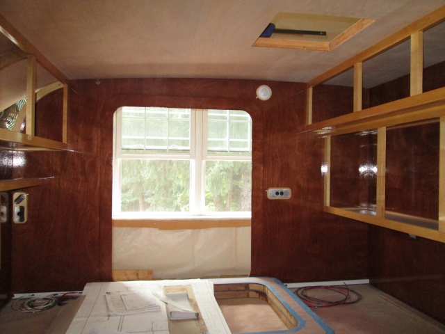

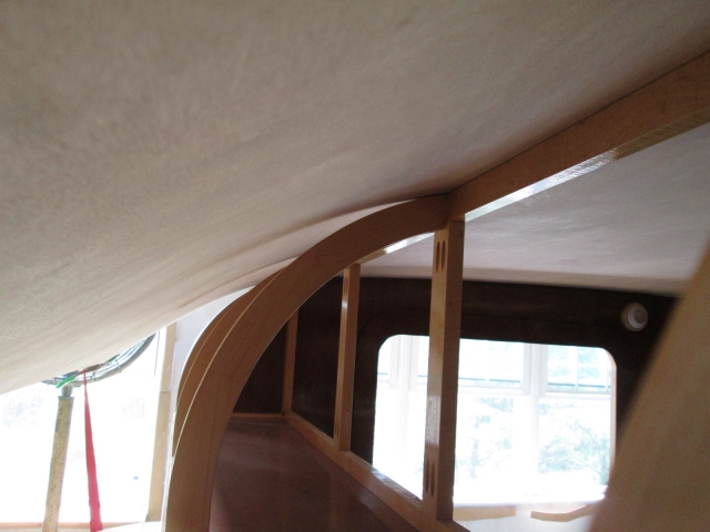

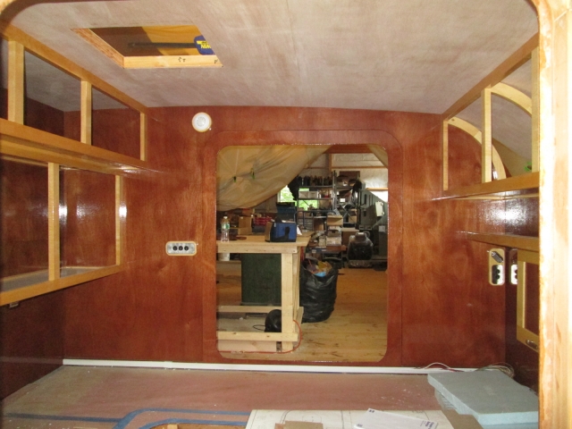

Here are a couple shots showing how nicely the ceiling is fit to the bulkhead, cabinet face frames, and side walls. First looking thru the street side doorway at the curb side, and then looking thru the curb side door at the street side.
I got inside and traced around making reference marks to show where I will need to mask off the glue areas. I will hold the tape back from these marks enough to be sure that the finish dives under, but still leave plenty of glue surface.
Before leaving for the day I added another temporary backer and sucked the ratchet straps down a couple more clicks, now at about 7 inches to go.

KC, that plywood splitting was the exact problem I had on my wooden trailer , and it only got worse over time ... A little late , but if you glue a sheet(or fabric) to the top of the plywood , it will absorb the tension load and not split as badly ... Within 6 months my un-canvassed top had split in many places... and that was not out in the sun , but under my shed... :frightened:
One of the many reasons of my dislike for plywood ... :x
Re: The Poet Creek Express - Foamie Hybrid
Postby KCStudly » Mon Jul 14, 2014 6:39 am
That gives me the idea that I could kerf thru a few layers, or, I haven't given up the idea of using hot wet towels yet.
I'm not so worried about the outside splitting a little between fibers as I am the whole thing bursting open like the Grand Canyon! It will get the foam glued over it eventually, and the outer canvas skin; that should stabilize and protect the wood once it is all assembled.
I suppose I could lay some glass and epoxy over that front section once it is glued and screwed permanently. :thinking:
