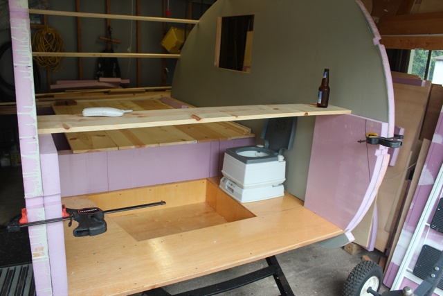

GPW,
I don't have a plan, that's why I am asking...
But I did notice the board is very weak in the middle. So I am going to have to come up with a support in the middle. Other than that, all options are open.

Postby eaglesdare » Mon Aug 08, 2011 9:26 am
been thinking about this. are you just having the counter top there? no wall under it? if so, you could just add 2 or 4 legs in the areas where more support would be needed.
not sure if covered foam would be strong enough because the legs would be sort of thin. but i suppose a lot will depend on how much you want to put on that counter.
if i were to do the legs, i think i might use wood. covered foam might work with a double canvas wrap, but i haven't done 2 layers so i don't know how much stronger that would be.
but a cool shelf unit could be built with foam which would work for holding that counter up. i sort of like the shelf unit build idea the best.

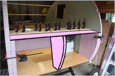

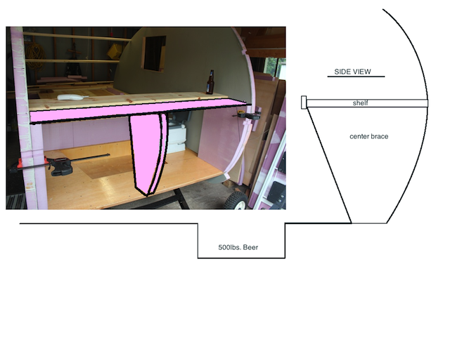

Postby GPW » Mon Aug 08, 2011 10:44 am
We learned from just putting the bedsheets over the foam that it became quite stiff and non bendy'... So a good shelf /countertop made from leftover 2" and canvassed on both sides , with a middle support (of the same material ) should be Plenty strong , and the least weight ... Same for the bed cover which could be made in two pieces to allow easy access to the storage under the bed ... No need for all that wood/weight ... just think of the weight saved to carry more Beer ... 8) And if you feel you need more support under the bed , just sub divide the storage under the high weight/ stress areas , more foam ,. more support .. I think we are heaviest in our mid sections (bodies) , so that would be the area to reinforce under a light weight foam bed cover... You could even make the under bed storage with adjustable dividers , like those fishing tackle boxes ... just a couple of small "rails" on either side to hold the divider plates ... each vertical added will provide lots of compressive support ... Another is to use some of those plastic storage crates the same height as the under bed support , they would also share the load ... and hold the gear too ..

As far as the sagging shelf goes, I think running a spar across might indeed be the easiest and lightest option. A length of 1X2 screwed to the shelf would prevent it from sagging. I've done that with the shelves that hold my tools (3/8"OSB - 12"X48") and they don't sag between the brackets. If nothing else, you could put the strip on top of the shelf as a backsplash of sorts. With a foam shelf I think that would have to be a must if you can't tie it into the structure in mid-span.

Postby GPW » Fri Aug 12, 2011 10:26 am
Maybe something simple like this .... Image
