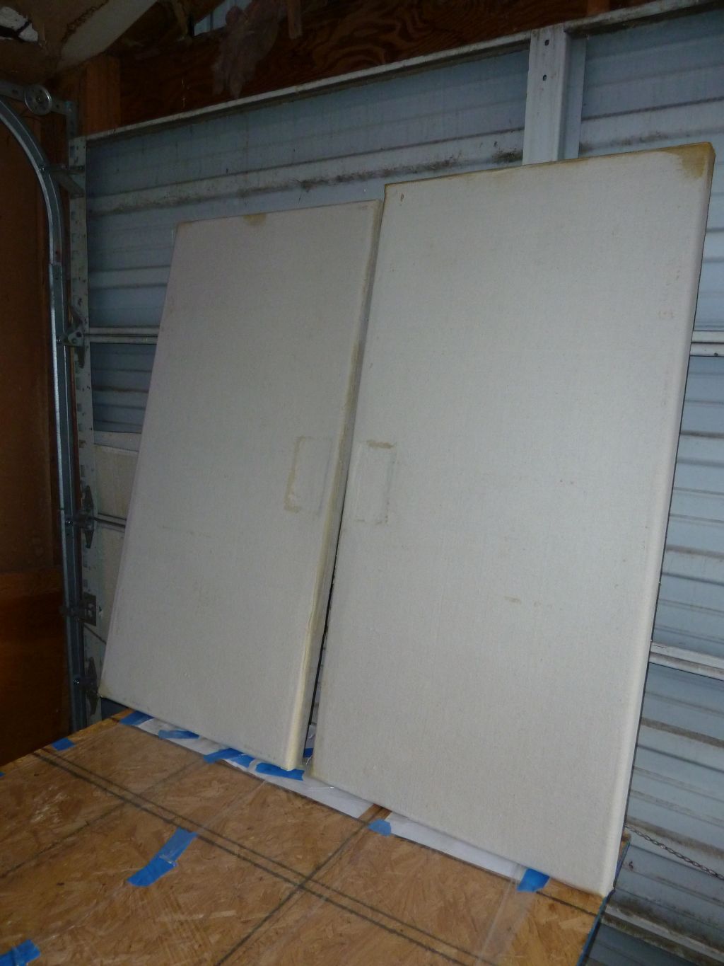

Thanks and hope so but we will see when we get caught in the first downpour :lol: Just finished putting canvas on the first door back there; used one piece of canvas wrapped it all the way around vs using two pieces of canvas (one on each side) like the other door. Much faster but probably just experience made it easier. Ordered an Astragal with weather-strip to go over the center gap, have a big roof molding to cover the bottom of the door gap, OSB floor & 2x2. The rest will be gasketed. Stainless knuckle hinges will be applied to those wood strips on outside door edge & 2x2 - the doors must weigh all of 5-8 pounds each :D
Taking a break before I do the second door - first one took around 2 hours so this next one will be done about dinner time.

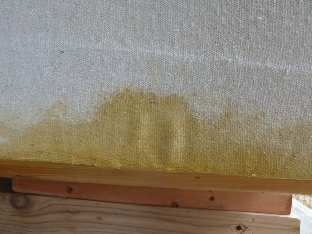

Checked the TD for bubbles - not showing any new ones :thumbsup: what a relief ! The small ones (finger-tip size) ironed out first pass.

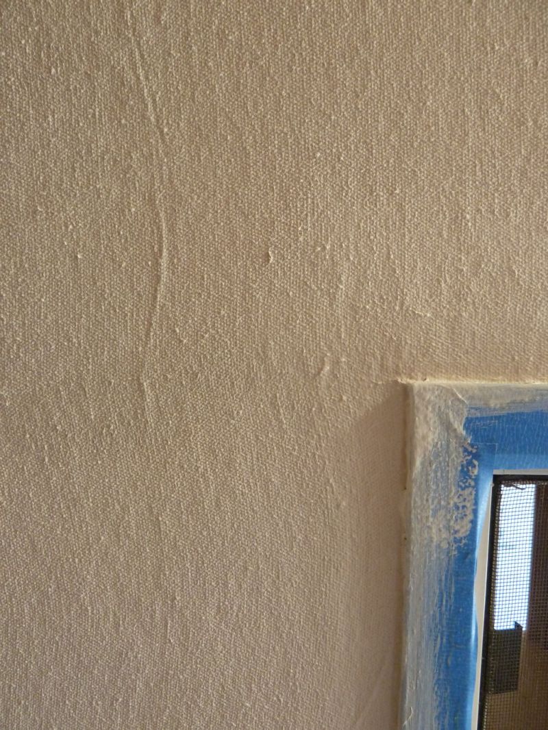

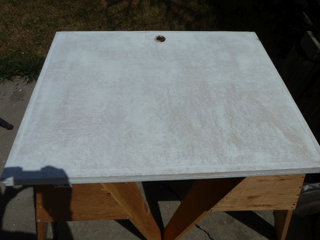

Sanding and fairing is underway. A light but thorough sanding followed with another paint layer does not eliminate the weave appearance but it does knock down all the stubble & pulls. Will fair out the canvas overlaps and try fairing the entire weave with a light watery spackle coat as a test and see how it looks when painted with Gripper.

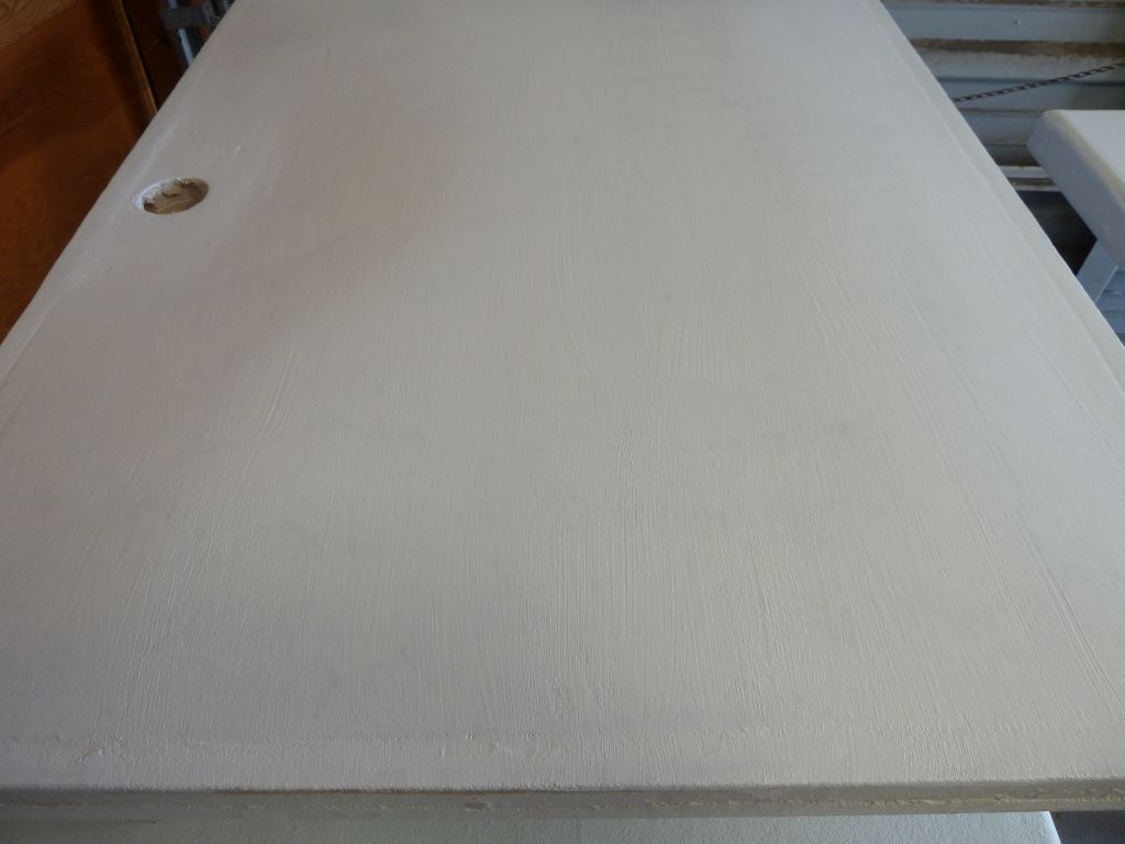

Did experiment with a skim coat of spackle, sanded it, painted gripper on top. Smooth finish without fabric pattern achieved. Need to sand & use a roller for the final exterior coat since the brush marks show now.
Mike, your answer is, YES, you can cover with canvas and get a smooth finish :thumbsup:
