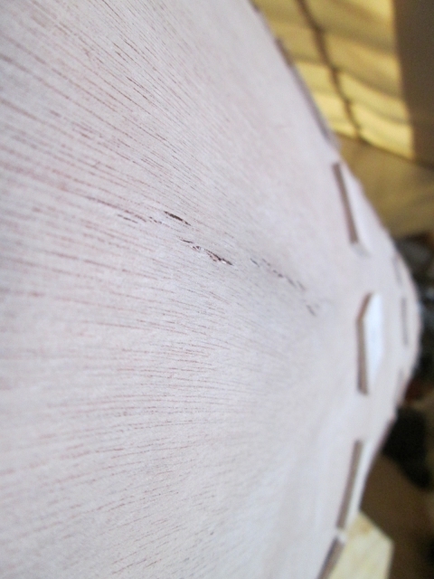

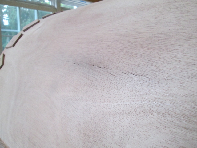

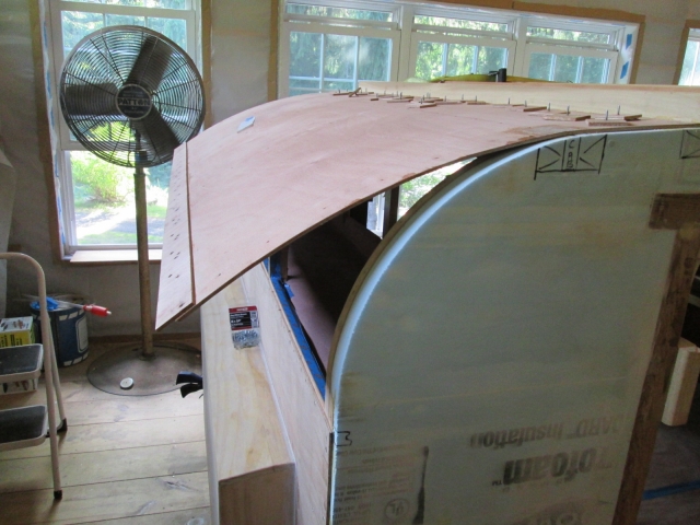

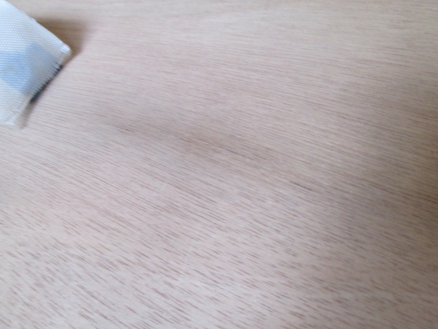

Last night I had a late start, but tried to remediate and reinforce that dreaded buckle. It shows up in the pics a little more now that it was dry.
So I unfastened and let the front radius relax again.

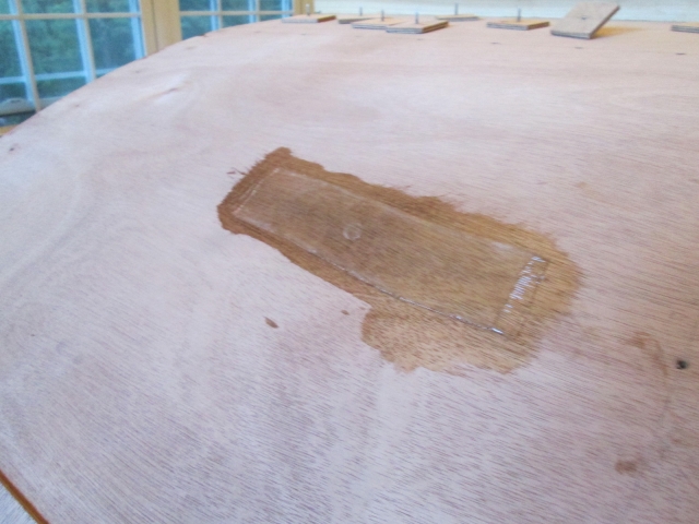

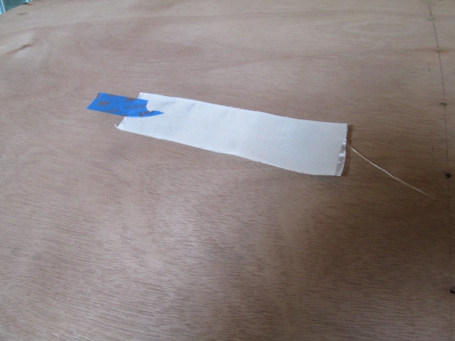

I tried to knead out the buckle on the curb side as best I could by hand. I was able to put a little heat into it just from the friction of rubbing my hand on it, but I'm not sure that did anything. The manual pressure did reduce the bump some and brought the open fibers back together, but the crease will still be visible on the inside. You can also see how I used a piece of blue tape to hold the fiberglass tape in position like a hinge so that I could paint the epoxy on then just flip it into position.
By leaving the tape on I could brush additional epoxy onto the outside, stroking away from the tape, without pushing the glass out of position. Once it was pretty well wetted out it was easy to pluck the tape off and finish the other end. The little white circle in the middle is where there had been a small round sticker stuck to the roll of glass tape. It seems that the adhesive from the sticker kept the epoxy from fully penetrating in that area.
I am hoping that this will help stabilize the area for the final glue up, and maybe help minimize the buckle effect. The epoxy needed 10 hrs to fully cure.

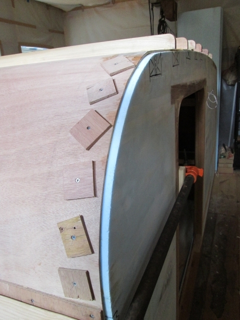

I figured I’d get where I wanted to be on the camper today, then switch and get dirty changing the shock absorbers on the Jeep. It worked out pretty well.

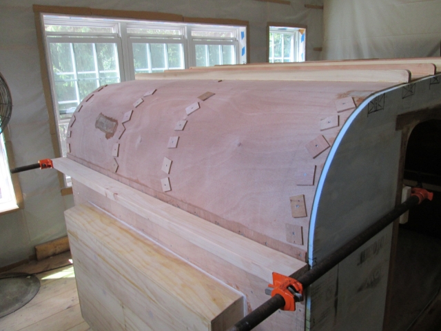

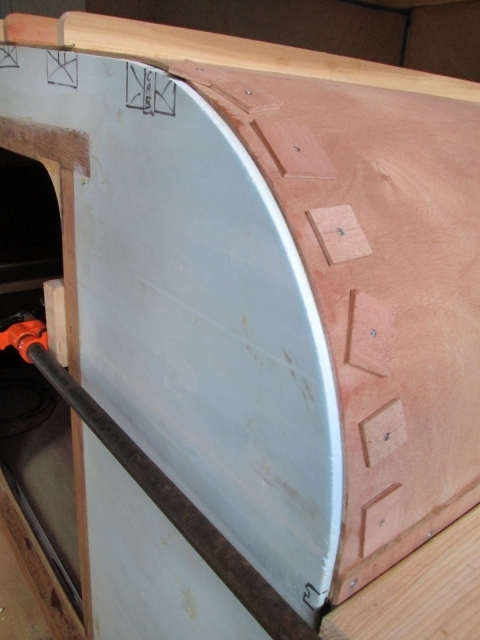

Karl gave me a hand gluing up the front radius of the ceiling. Except for the last bit, the last row of washers and the final flap at the bottom, he just pressed on the 2x4 strongback/spreader by hand and I shot the screws. We got all but done before either of us realized we hadn’t sprayed any water on it, but we hadn’t heard any popping or breaks, so no harm, no foul. I often feel rushed when working with Karl… but things get done, so...
The fiberglass patch really helped reduce the magnitude of the buckle, so I was happy that I went to the trouble. It is still there but is much less objectionable!
Scooped the excess squeeze out from along the sides and took a couple of pics to show how nicely the ceiling skin formed to the profile.

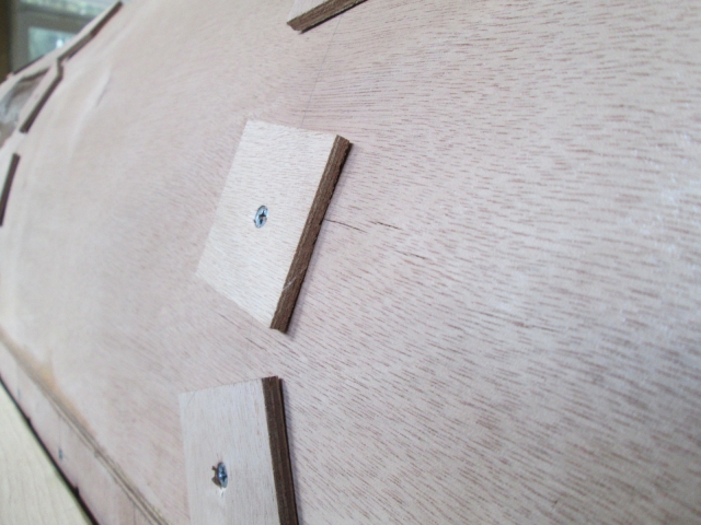

There was another much smaller buckle with attendant grain separation right near one of the wooden washers; which coincidentally was the location where one of the screws pulled straight thru the previous washer. Then Karl had to let off of the flap and it pulled all the way thru the panel. What you see here is a replacement washer to hold it tight until the glue dries. Nothing visible on the inside, so again, no harm no foul.
I’m definitely going to skin the whole front radius area over with glass reinforced epoxy before adding the foam; just to stabilize it all and prevent any future issues.
After waiting a little while for the adhesive to start to congeal, I climbed in and used the wooden chisel to ‘scrape’ the excess away and remove the masking.
Train kept a rollin’.
