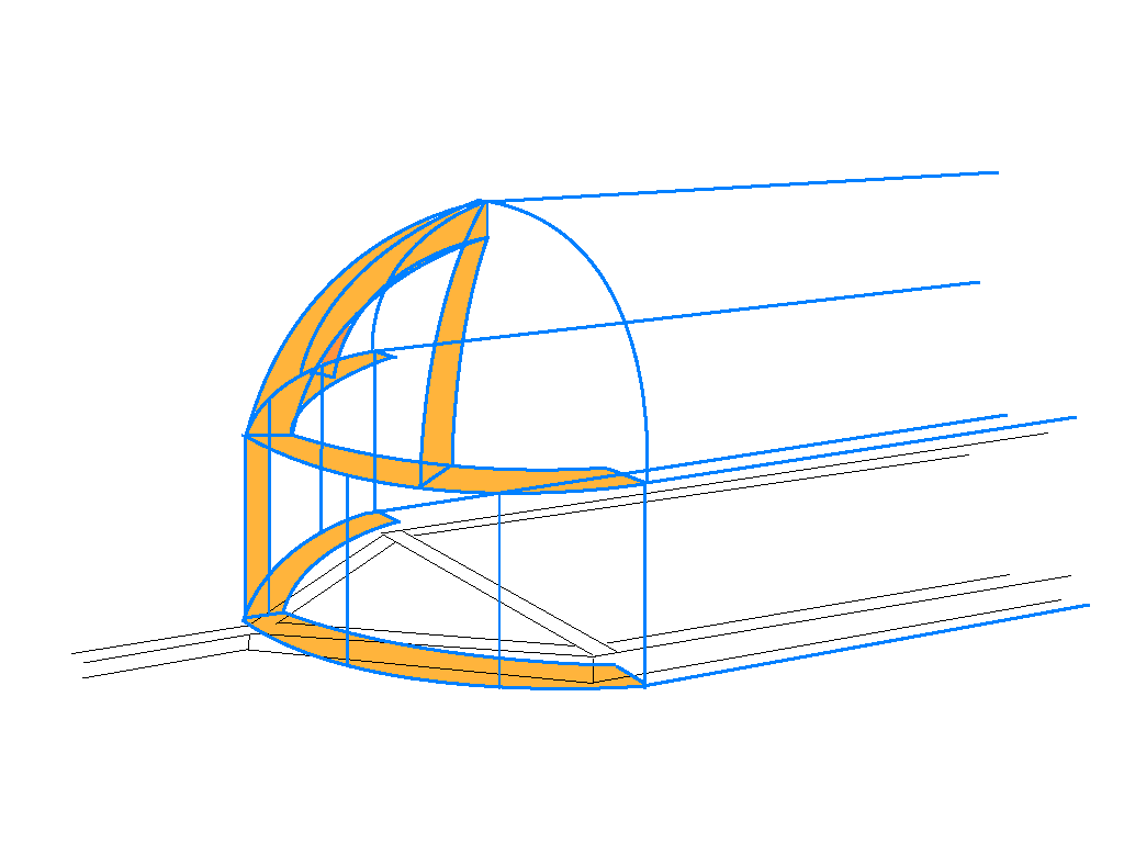

Further conversations with Vinnie.... he suggested making some nose former ribs to wrap the kerfed foam around ... Much stronger and easier to shape .... So I made yet another drawing ... :thinking: I’ll let Vin do the final drawing /design , since he’s the one with the machine ... Nose ribs ... there goes that other quarter of a sheet of plywood ... no waste now ... :thumbsup: 8) Two sheets is not bad , affordable to get “the good stuff” ... With the free trailer , it may be possible to bring the basic FS in under $1K ... that’s not too shabby as far as Thrifty goes ... :beer:

Ps. You can see by the drawing that the cabin floor hangs over the trailer frame on each side by 6” ... Adding the foam @ 3.5” thick , means the cabin overhangs by a good bit (~ 10” each side ) ... I didn’t think this is a real concern since the cabin is Light , and the Oak supports the floor underneath .... The wheels should almost line up on each side under the floor .... Hoping I can use the standard metal trailer fenders and just build a simple Foam wheel well above that ... Simple, light!!! The height of the floor above the fenders depends on the thickness of the Oak cross members... maybe a chance to cheat an extra inch or so for more clearance... I know I’ll need a little door step to get inside anyway .. entry being ~ 24” + off the ground ... Maybe a little back porch ... with steps ... could be a fold down , welded to the frame on a hinge .. :thinking:
Vinnie also suggested a small stylish overhang on the rear of the roof ... that could be practical too , and maybe offer a little drag reduction , depending how it’s designed... :thinking:

Just curious here, but have you figured out how to do the compound curves at the top of the nose ?
I was looking at doing a similar shape before I settled om flat panels - I was either going to cut 'orange peel' section (like the alum skin of your project's namesake, or use big blocks and carve the curves out of it.
If the latter, it seems like a great opportunity to show off your HW skills !
As far as the overhang, the only way I could see it being a problem is if you had a lot of weight loaded on the roof. Commercial RVs are always cantilevered like that and you can bet that the floor you're building onto will be much more substantial...

W2, Vincent was talking about doing compound kerfing , so I sent him the discussion here... He’s way better at “the Math” than I am ... :oops: “ Blocks would be OK with me , Fun carving big shapes ... electric Turkey (or Fish) carving knife makes it easy !!! But Lots of sanding left , but it’s soft so it doesn’t take long ... Very Messy !!! :o For hollowing out the inside I’d probably make a simple HW loop and just scoop away the excess... Here’s a trick I’ve used before on models .... Get a pack of cheap bamboo skewers for a dollar .... mark each one for the desired depth , and stick them up to that mark in the foam , all over ... When you’’re “scooping” if you hit a skewer tip , you know to stop and move on ... best leave a little extra thickness , just in case you get carried away ... After that , remove the skewers and sand the inside with a rubber block wrapped in coarse sandpaper , the rubber bends to the curves , so no gouging ... Made many full fuselages in the past that way ... works Fine !!! :thumbsup:

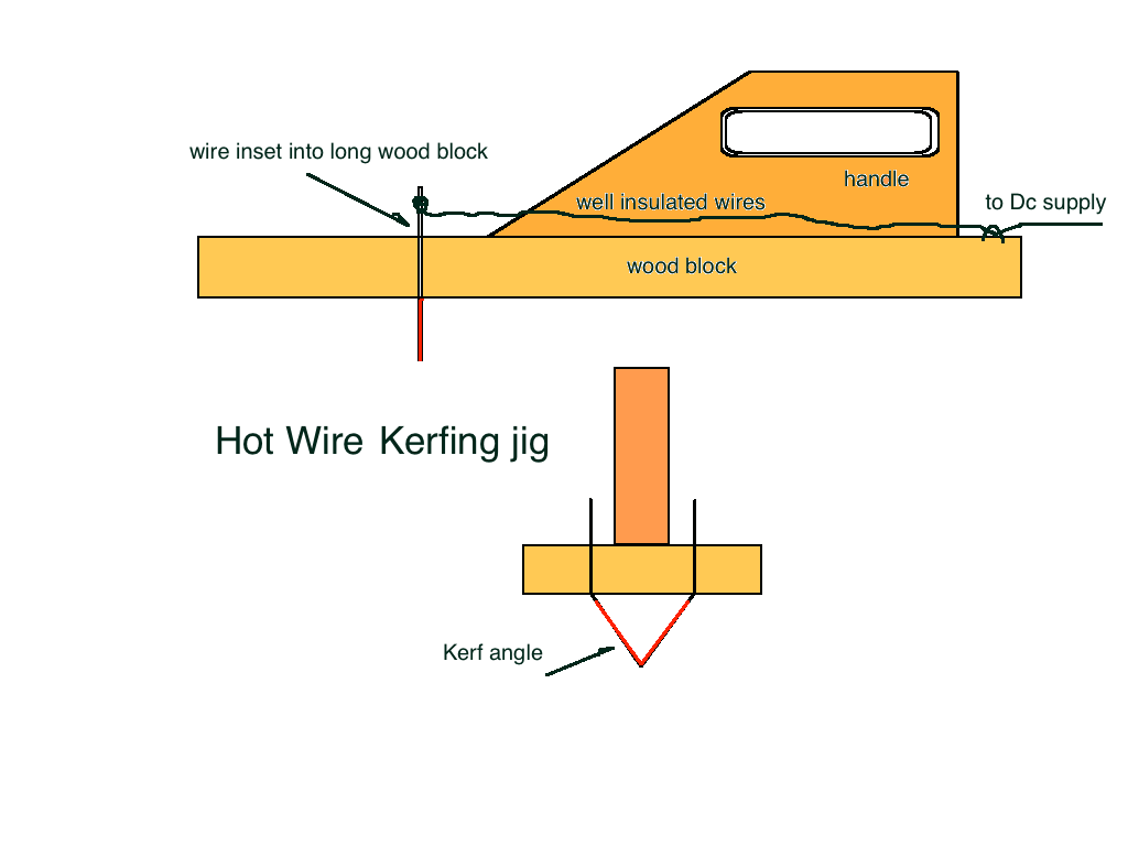

Postby GPW » Mon Oct 01, 2012 9:29 am
Since lots of kerfing will be the order of the day ... came up with a kerf cutting tool to make the job easier ... long , for sliding along an edge guide ... handle to keep hands away from Heat and electricity ... :thumbsup:
