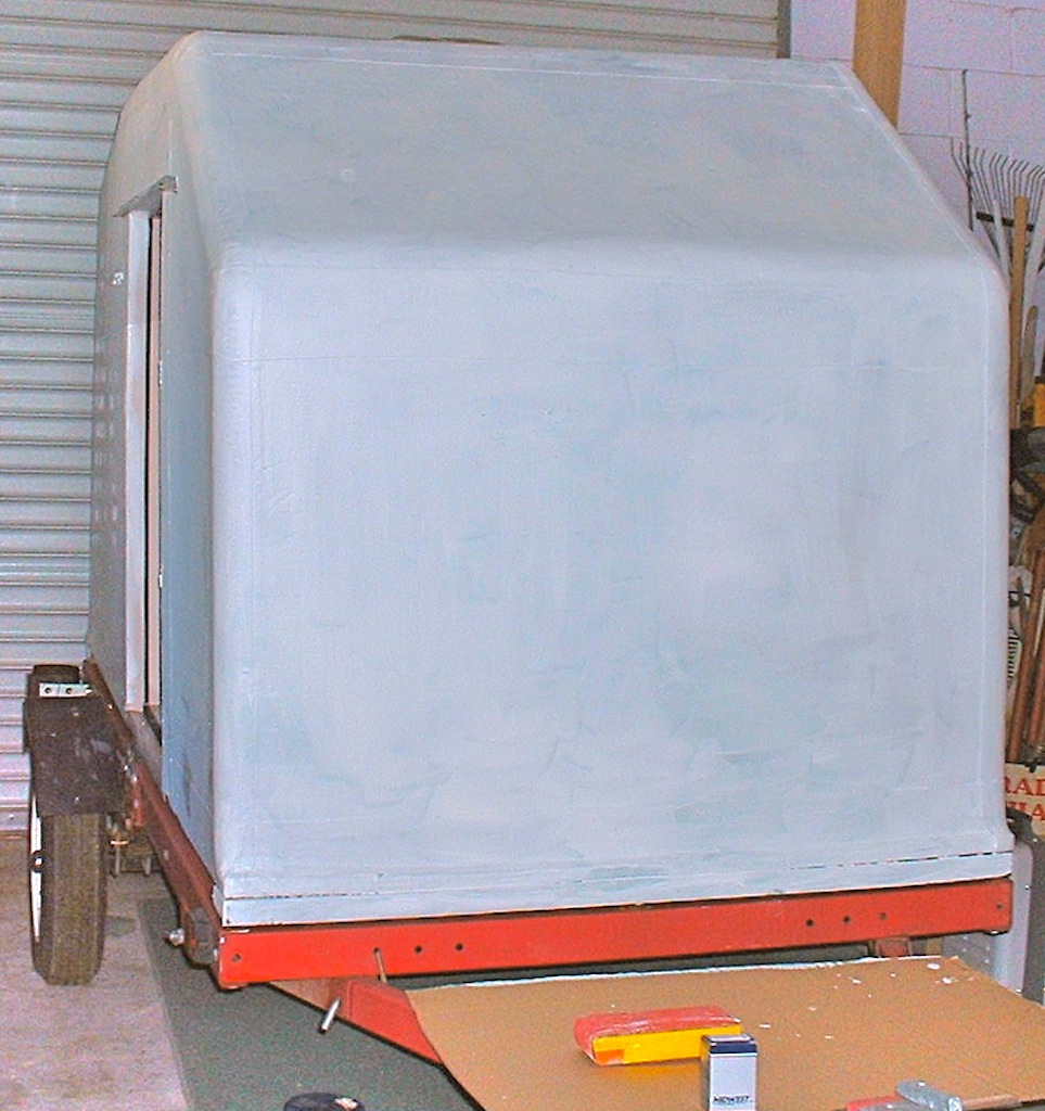

Bonnie , it really wasn’t intended to be pretty , just making darn sure the window is sealed ...The window is stout , made of 1/2" plexiglass... very secure (security) ... didn’t want ANY leaks (however small) spoiling that ... ;)
This morning , we’re going to pull it out the Studio and give it a little “wash” (clean off the sanding dust, we do want a CLEAN surface to start priming on ) ... Pretty day in store for us .... Great weather (fortunately ) for doing this ... :D

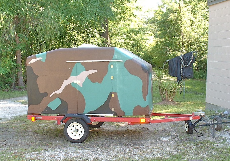

Well now, a little Cleaning goes a long way ... :o :roll: :lol: Cleaned up much better than I expected ... just a couple little rust spots on the frame to attend to ... mostly on the brackets ... Once it gets a chance to dry out , we’ll pull it back inside and prime those spots with some Rustoleum primer , then a coat of red Rusto’ enamel over that ... That oughta' do it !!! . Tape off the frame with masking tape and newspaper and we’re ready to paint the cabin ... :dancing

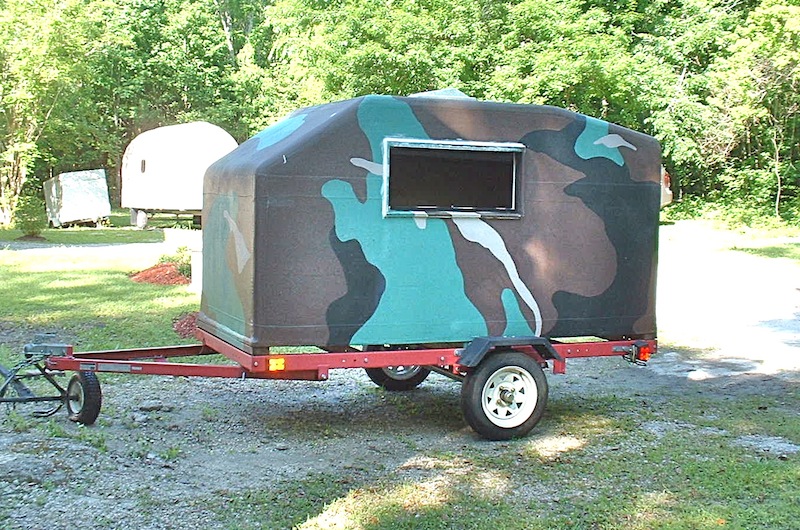

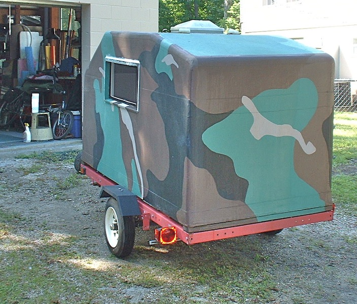

Bye Bye Mr. Camo ...
Re: FoamStream...
Postby GPW » Sat May 03, 2014 9:18 am
No More Camo ... :o I Kinda’ miss it already ... but the new paint will be Much Better... :D

Postby tsmyth » Sat May 03, 2014 3:14 pm
How did you get the radius on the corners of "MR> CAMO" foamie? Wwhat is the radius dim?
thanks,
t
tsmyth
Posts: 32
Images: 28
Joined: Thu Jun 21, 2012 8:20 am
Location: Port Richey, FL
Re: FoamStream...
Postby GPW » Sat May 03, 2014 3:44 pm
T, belt sander and Big sanding block made by gluing flattened sanding belt to board ... It was messy !! :o TLAR method!!! ;) ~ 2” R
Oh , and found out (the hard way) Never drop the Gripper on a weathered HF fender ... Even if you wipe it off right away , it still stains the black fender .. :o I’ll have to paint those for sure ... :duh:

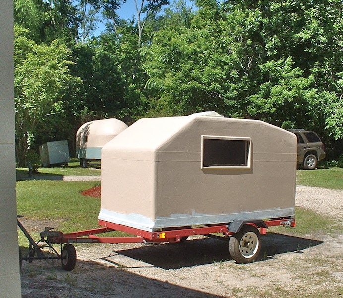

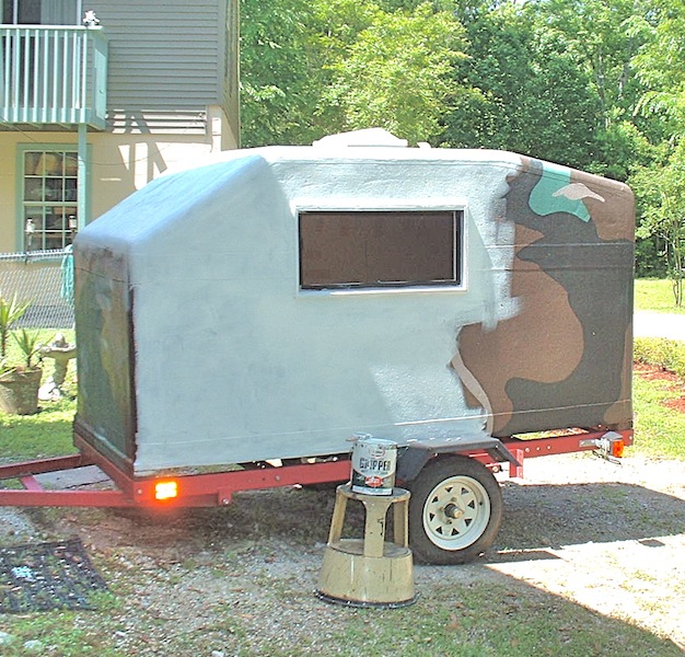

Got Everything primed now , and a first coat of color around the door and windows .. (the jambs) ... Just a Perfect day for painting (weather) , got my paint clothes on ( again) , and just waiting for it to get a little lighter outside ... This will be Fun !! 8)
Re: FoamStream...

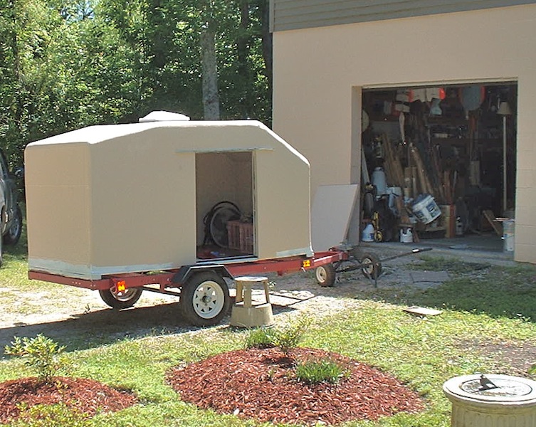

Postby GPW » Sun May 04, 2014 11:08 am
Hours later we return to the scene... The first and second coat of the top color has been applied .... :D Now curing in the Sun.
Re: FoamStream...
Postby lthomas987 » Sun May 04, 2014 11:17 am
Now that it matches the house maybe you can hide it in plain sight!
