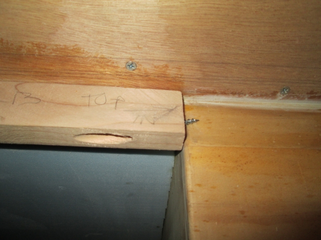

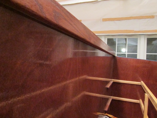

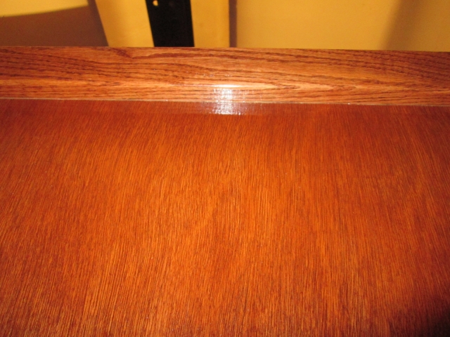

On Monday I PL’d the cabin side hinge spar into place. After masking the top rear edge of the bulkhead, I put a 1/8 inch bead of PL on the rear edge of the ceiling skin and another in the corner between the rear edge of the ceiling skin and the top edge of the bulkhead. A dozen or so 2-1/2 inch long coated deck screws go down thru the spar into the cedar frame of the bulkhead. These screws are well counter sunk into the spar so that I can fill the heads prior to covering. The dark swath in front is where I wiped the excess squeeze out up with a spirit damped rag, after scooping up the bulk with a stick.
There was a lot less squeeze out on the galley side, which I was grateful for. All it needed was a little cleanup with the stick and a quick wipe before removing the tape.
Because the screws go down thru the spar on the leading edge (with the rear edge hanging off the bulkhead a little), and the profile is curved here, the spar rocked forward a little; no big deal. Where the seal will wrap up around the hatch side spar (where I did the round over), I need to fit a little inside radius block on each side to fill in what would otherwise be a gap in the corner between the top of the walls and the spar. I started fitting this little piece of maple by matching the angle of the spar. It’s shown behind the little shim here, but will sit out flush to the outside of the wall once it is cut down and the inside radius is cut.

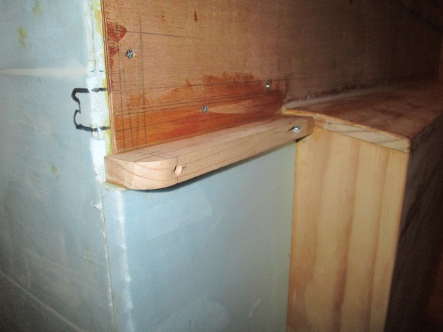

It was a little late to start sanding for another coat of poly on the hatch (translation – I wasn’t that ambitious), so I revisited the rock guard situation. I decided that if I lower the top of the guard to be just below the top of the locker bump out, that would solve a bunch of headaches. Jumping ahead a bit to show the big picture, I have marked up this pic to show the concept. The front rock guard will actually consist of two pieces, one on either side of the locker. Each will be formed with two bends in a Z-shape. The side-to-front bend will be formed in the break press using a round nosed die to match the 3/4 inch radius at the wall edge, while the inside corner at the locker will be a crisp bend, either on the pan break or using a sharp nosed die set on the press.
This will allow the forward leading edges to be screwed to the side of the locker, and will eliminate the extra blocking crossing over above the locker.
Side note: Karl is making good progress installing a 45kw generator shed behind the barn to provide adequate 3 phase power to operate the 100 ton press and 1/4 x 10 ft shear that has been purchased at a recent auction. These should be available to use by the time I am ready to make the rock guards and Karl is eager to try out his new “toys”, um, tools, so he is looking forward to helping here.

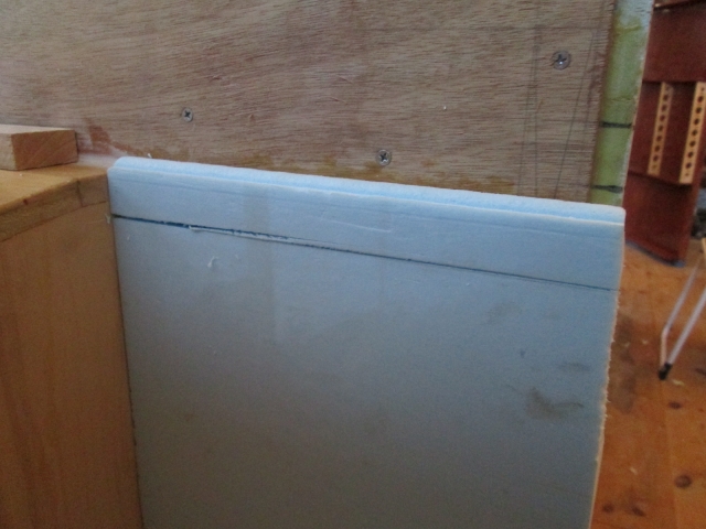

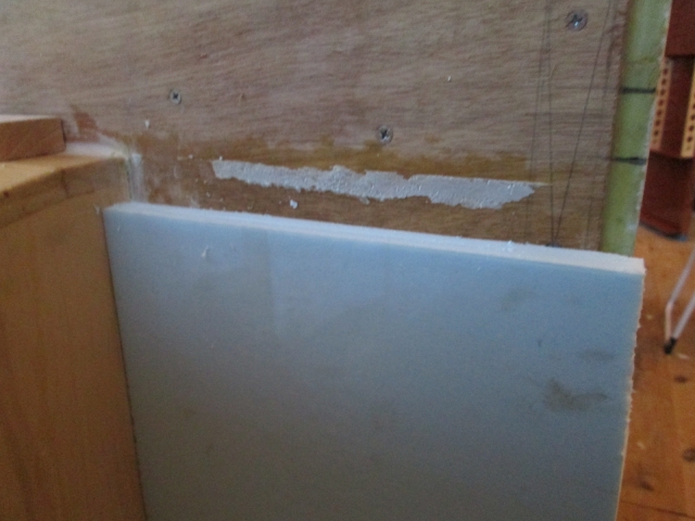

Anyway, I had to back up a little on the first layer of foam that I had already glued to the front. I wanted to leave the guard just down enough from the top of the locker so that there is a little space for caulk between the vertical surfaces (below the slight radius edge of the locker) and the tops of the guards. I just need enough blocking for a row of screws along the top edge of the guard, so 1x2 on edge will do, matching the 1-1/2 inch thickness of the foam. Here I have used a blank piece of 1x as a gauge and straight edge to draw a line where the foam needed to be trimmed back.
Next I used the same piece of wood below the line as a cutting guide for the extended razor knife, making a few passes to make a clean square horizontal cut. Then a couple of passes slipping the blade down vertically between the plywood and foam to get this.
Dry fitting the blank. Still need to do some more scraping and sanding to remove the foam remnants and glue residue.
(The front foam runs wild here and has not been faired back to the wall yet.)

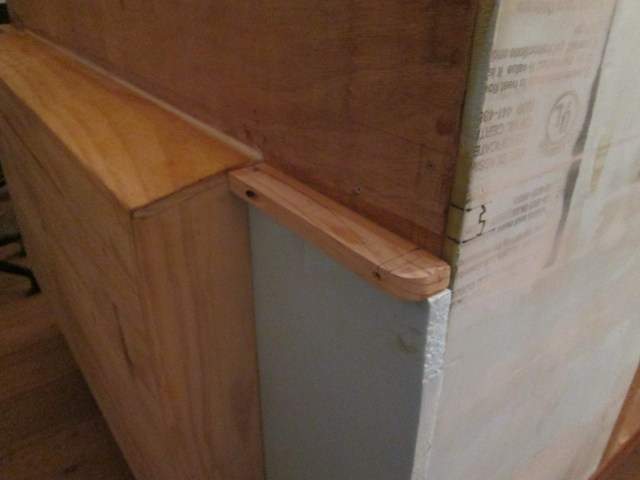

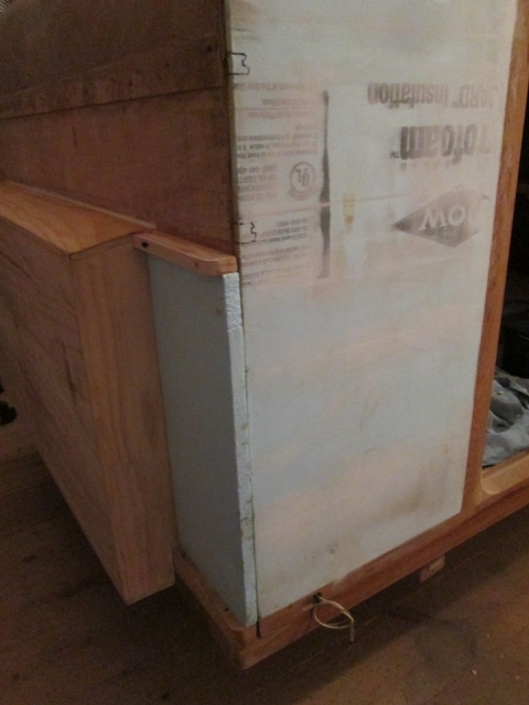

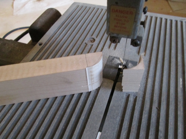

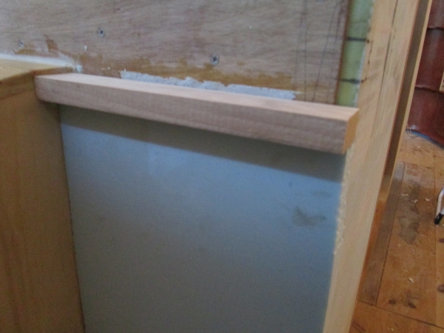

Again, rather than using the router with the big 3/4 inch round over, I laid out the corner radii, rough cut on the band saw and sanded to the line with the small block. For these one-z two-z operations it just seems quicker than doing a set up. On the curb side I remembered Karl’s little jig saw, and gave that a try.
It was slower due to the finer blade (which probably needs to be replaced) and I didn’t realize until after that the table was tilted a couple of degrees, but it got the job done well enough.

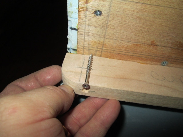

With no easy way to clamp the blocking into place for glue up, I played around with the Kregg making sure that the inboard screw would not go thru the locker. Here I am holding the curb side blocking over the locker to show how the screw will go thru the edge.
On the outside I used a trim screw to find the blocking, shown here lying on top over the pilot hole. Also note the rounded front corner of the block, matching the wall to roof round over.
Glued and screwed.
I’ll have to make a slight adjustment to the foam pieces that have already been dry fit above these locations, but that is no big deal.

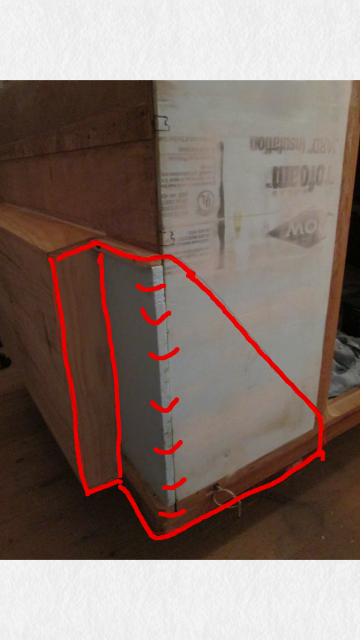

Tomorrow I will look closer at letting in some diagonal blocking strips on the side walls, for the tops of the guards there.

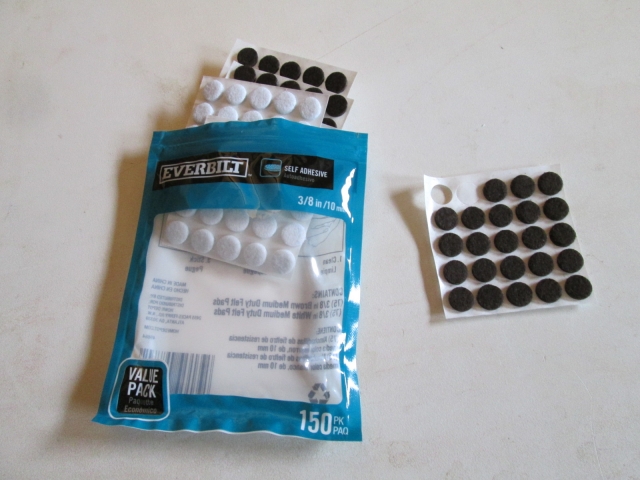

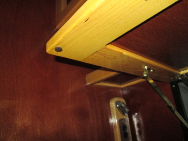

A small detail that I have been meaning to get to; felt dots for the inside of the locker door to keep it from rattling and chafing.

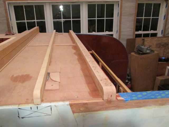

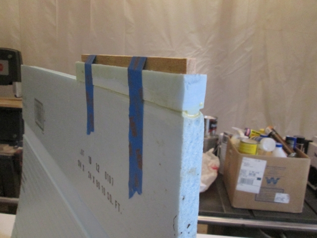

Next up, extending the first layer of foam that I had previously fit over the roof panel splice backer and kerfed for the front radius. When I got there today the loft was only at 36 deg F (brrr). My little recording thermometer indicated an overnight low of 30 deg F, so I was a little late taking my glues and paints home with me (that hot box idea is sounding better and better). I went to use GS but it wouldn’t come out of the can. Tried GG, but it was like molasses. So, even though the heaters had only gotten it up to 45 when this pic was taken, I went ahead and used TB2. After all, it is just to hold the piece on long enough to get it fit and glued onto the front wall.
The little scrap of wood is just a backer to spread the clamping force of the tape out. Did this two times, one for each piece on either side of the locker.

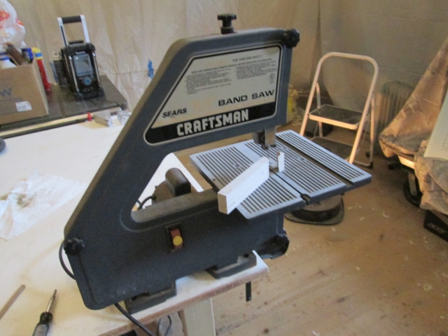

Next up I did a little tune-up on Karl’s little detail bandsaw. Cleaned out the mouse turds (it had been stored in his enclosed CT), cleaned the wheels so the blade would track well, adjusted the table square, and cleaned it up a bit. The little blade was better suited to cut the inside radii for the hatch seal corner blocks.

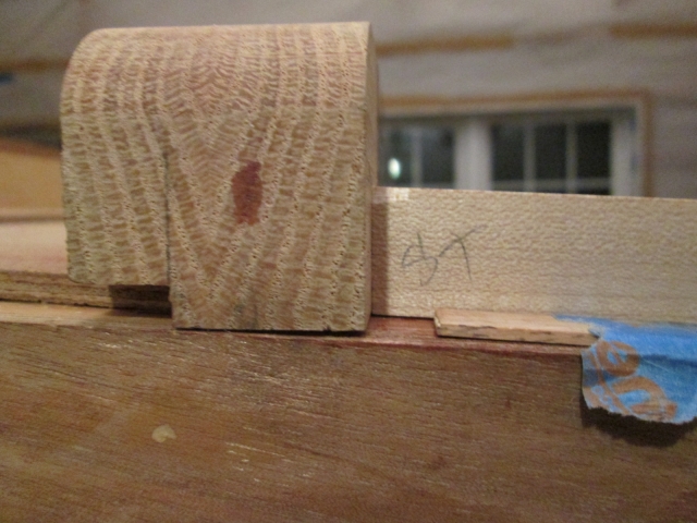

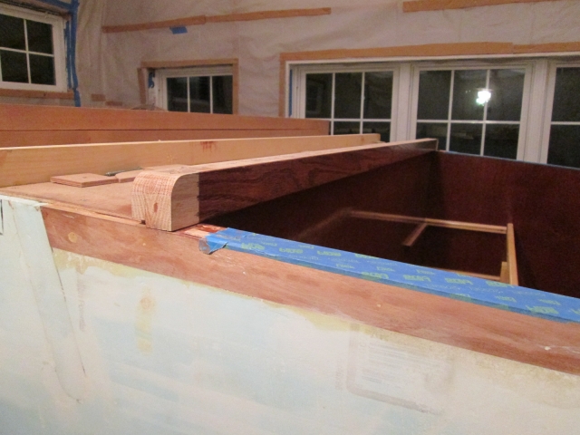

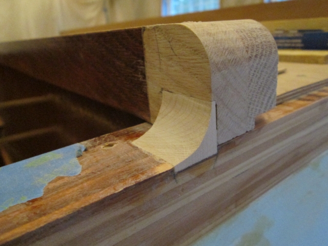

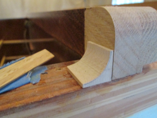

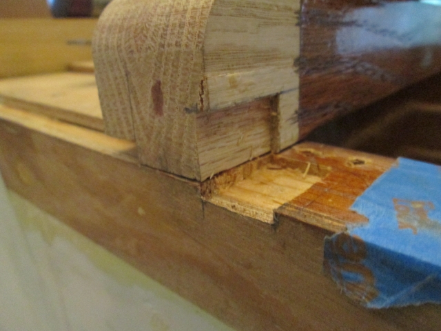

Here is the curb side block sitting in approximate location on top of the wall behind the cabin side hinge spar.
After stepping back the thickness of the tangents and marking out the rabbets, I hand chiseled them out.
In this pic of the street side recess you can see that I had a little splintering of the grain on the spar; had to glue that back into place.
All in all I was happy with the result. Here they are after gluing and a little hand sanding to fine tune fair.

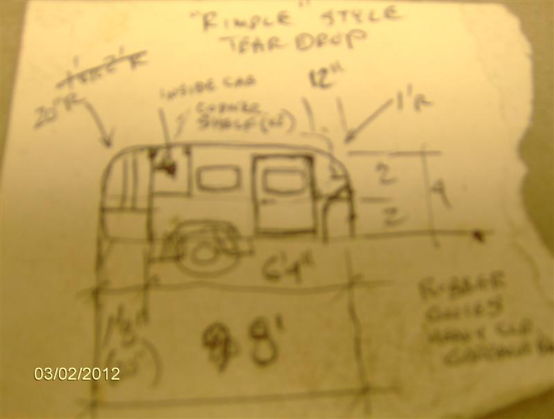

KCStudly wrote:...Looking back at my very first concept sketch.
Image....:)
Looks like you have the determination, and skills, to pursue your plan from A to Z.... I lacked both, starting with my first concept
tigerII teardrop.jpg (71.51 KiB) Viewed 891 times
but as Dirty Harry stated, "a man's got to know his limitations...." http://www.youtube.com/watch?v=_VrFV5r8cs0
