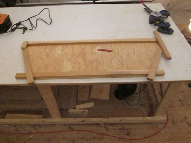

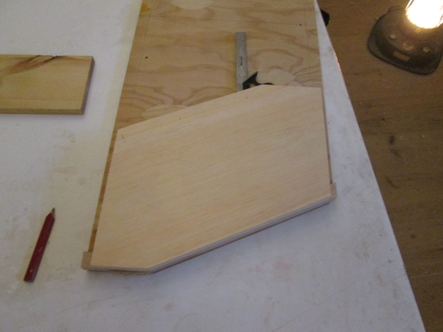

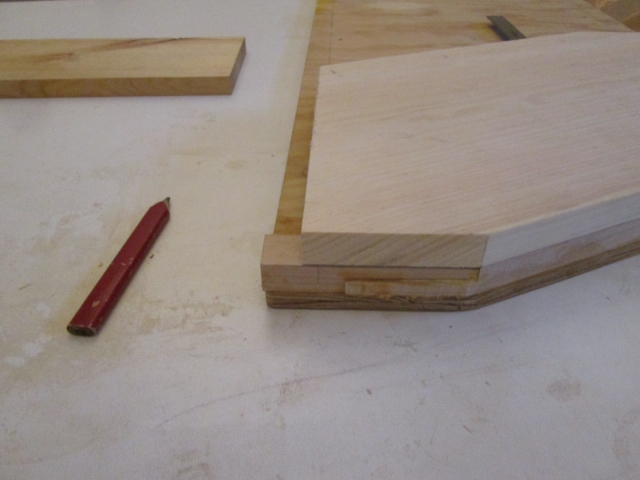

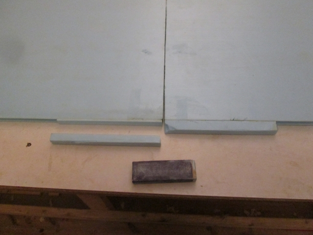

Back a few days ago I glued the bits that I had cut off of the tops of the front wall foam on either side of the locker on to the lower edges of the first two pieces of ceiling foam, shown here with the two outside edges butted together for the picture op. The one on the right (the curb side) is shown as glued, while the one on the left (street side) has been cut down leaving a sliver to match up with the rock guard blocking installed previously.
Here is a dry fit after sanding the edge until I got a good fit.
It was at about this time that I realized it probably would have been much less work and time to have just squirted some GS in the gap, trimmed the excess and been done with it. Narrow minded thinking No. 1.

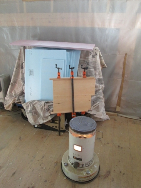

Now it got cold. I am really opposed to hauling my TB2, and PL, and GS, and poly, and paint, and wood filler, and epoxy, and etc., etc. home, and to the car, and into work (so it doesn’t freeze in my car during the day) and up to the loft and repeat every day. It’s hard to predict which products I may want for each session, or what the temperatures will be (i.e. which products will be an option for me to use). So I finally got it in my head that I would build a “hot box” or warming cabinet. Nothing too complicated, just a cabinet with a shelf that would fit a couple of one gallon cans, my glue bottles and a few smaller items with a 40w incandescent lamp to provide some heat. Maybe use some extra foam to insulate it, and practice my skinning technique by gluing some bed sheets on the outside.
Talked about my plans with Karl (he suggested that I just use an ice chest cooler, or build something that could be used in the build later… I briefly considered turning my cooler slide tray into a built in custom cooler), and the guys at work (Larry also, had independently suggested using a cooler), but I wanted something that would hold all of my stuff neatly w/o having to rummage thru each time I was trying to reach for something.
So I went and bought a couple of 1x10’s to build the cabinet (needs to hold some weight), and a 2x8 1 inch thk sheet of Fomular 250 (pink, the 1 inch matching some stuff that came as packaging for Karl’s new 3 phase panel giving me enough foam to cover all sides and only buying one sheet). I also got a metal octagonal box, simple ceiling fixture, cord grip connector, associated jam nut, and 2 pack of bulbs. I even salvaged the plug and zip cord off of the shop radio that got fried by Karl’s electrical troubles.
Karl again pondered if there wasn’t some way that I could put the effort into something that could be used later, but I had the plan in my head already and the materials in hand.

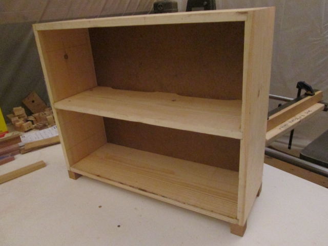

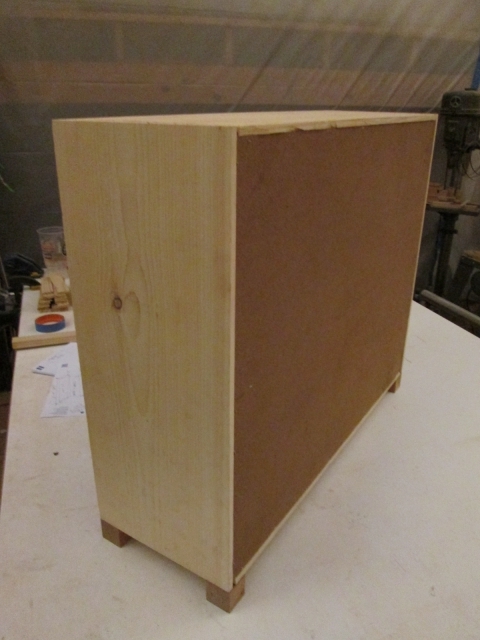

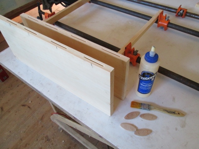

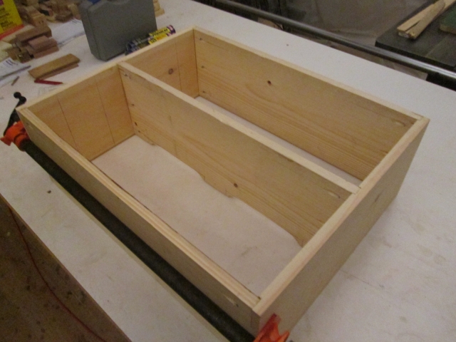

Spent an evening cutting, rabbeting, dadoing and dry fitting the box. This is the back side. I used the band saw to cut a pair of slots that would allow the air to circulate between the lower and upper shelves.
The next night I ripped the middle shelf down to allow for the thickness of the back and rabbeted the back edges so that the rear panel (some scrap melamine) would fit recessed/flush. Drilled 3 pocket holes in the underside of each end of each shelf, then glued the shelf section up with PL (only 45 deg F in the loft at that point, so not TB2). Glued and screwed.
I had considered putting the middle shelf up higher, but decided there was no need to store the rectangular mineral oil can in there (in fact that would be more of a fire hazard) so just centered the shelf to fit round gallon paint and poly cans.
On the ride home I realized that the one gallon plastic jugs of TB2 are taller than the metal paint cans and probably wouldn’t fit standing up. Doh. Trying to decide if I should stay the course or make a change, Karl’s words kept ringing in my ears, “sure would be nice if you could build something that can be used later in the build”.
Later at home that night it struck me. It was right there in front of… almost on the tip of… my... tongue... box. I should be building my foam walled tongue box. The tongue box would easily contain all of my goodies, and it needs to have a hole in it for shore power and solar charging connections anyway, so easy to pass the lamp cord thru. I was hung up on the cooler aspect of building an insulated box. I didn’t even remember the tongue box because I had put that off mentally until the cabin is fitted to the trailer, when I can make sure the box is built streamlined to the front locker bump out. End of narrow minded adventure No. 2, almost.
So tonight I at least finished the shelf so that it had a back on it and some feet, rather than it being a total waste.
Not my best work, but sturdy and functional; I’ll probably load it with stuff that has been laying on the floor off the end of the bench next to my other supply shelf.

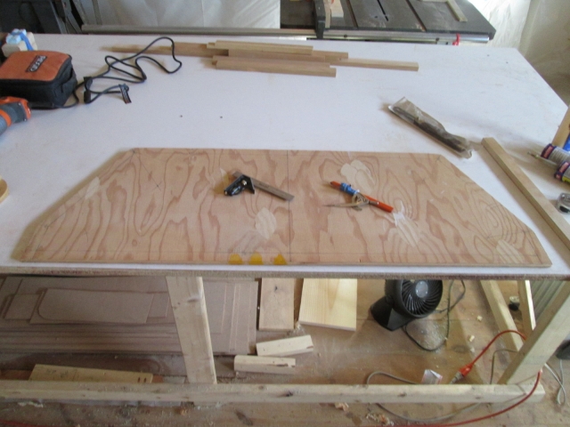

That done I decided to start building the tongue box (TB). I had to modify the original 1/2 inch ply floor piece that I made way back when in order to accommodate the locker bump out and keep the TB from getting too close to the trailer jack handle. That took a rip on the table saw. The locker came out about 3/8 inch narrower than the original plan for the TB, so I had to nip a touch off each side of the rear section; used the powered miter saw.
The lid of the box will be sloped in a continuation of the shed angle on the locker, so I did some careful measuring, allowing for the air gap between the two. Decided if I err on the short side a little; the TB can be shimmed up, if need be, to suit the line of the locker. If all else fails when everything comes together and I just can’t get things to line up the way I want, I can modify or rebuild later.
Rounded the front corners of the TB floor piece and started scrounging thru my cedar 1x2 drops to see what I could piece together for the top rim/lid sealing surface.

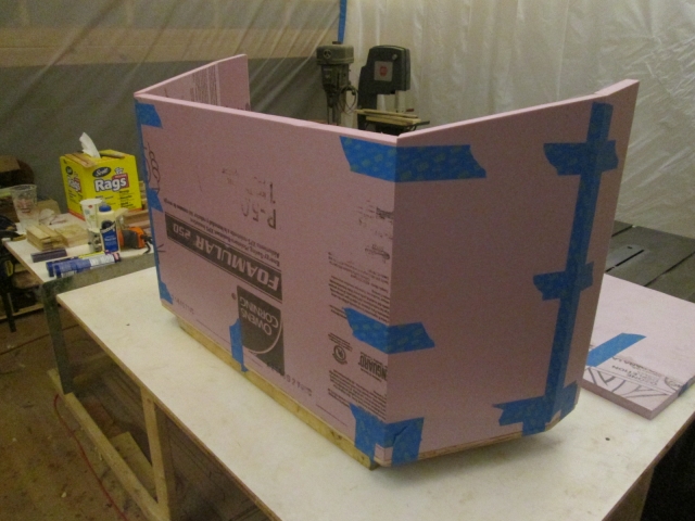

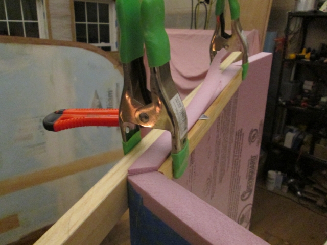

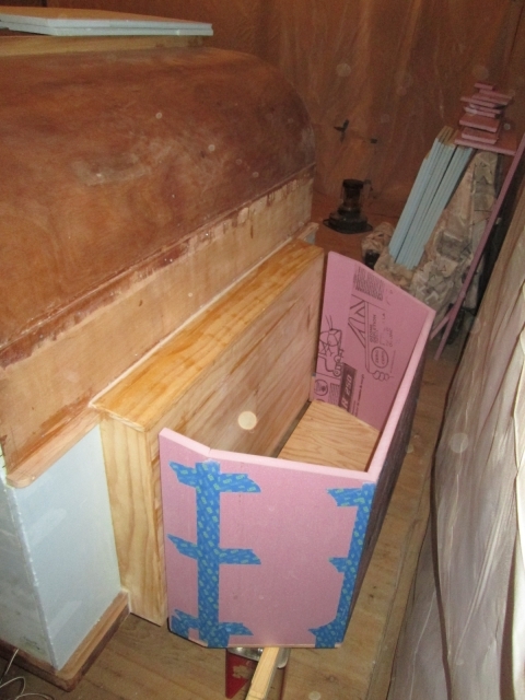

Tongue box build up.

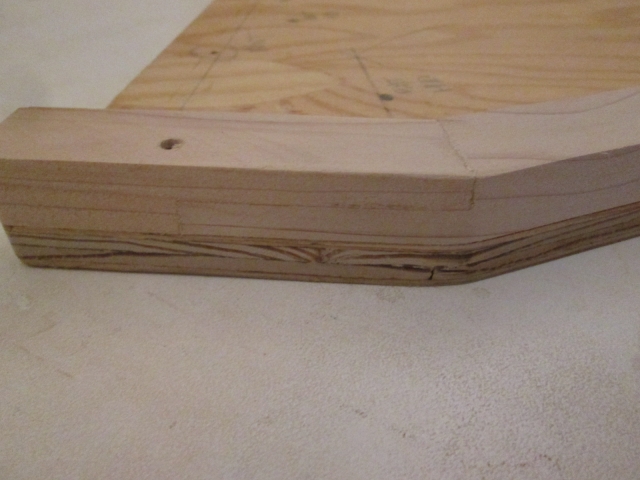

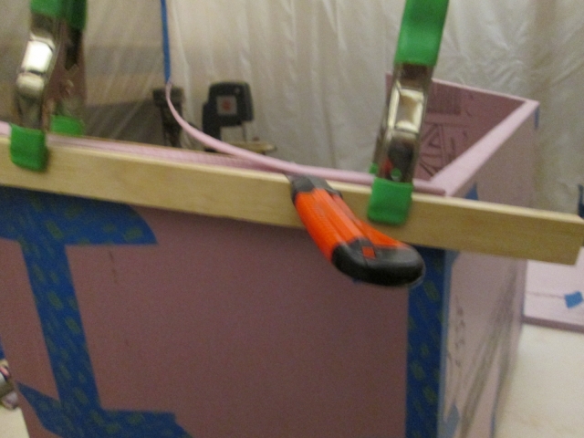

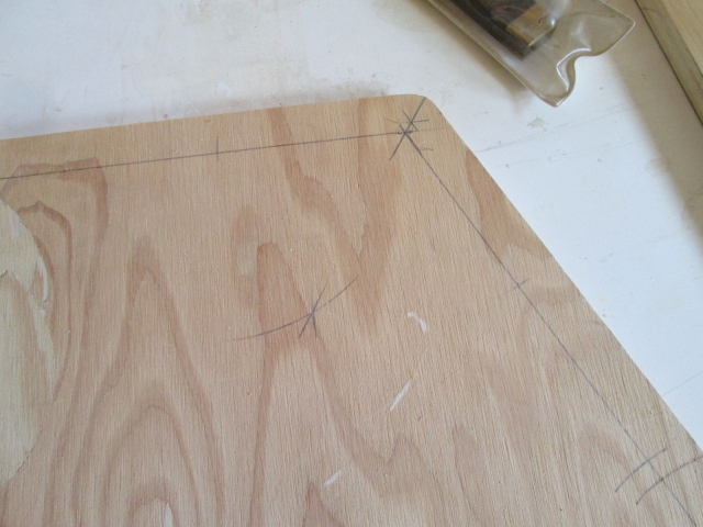

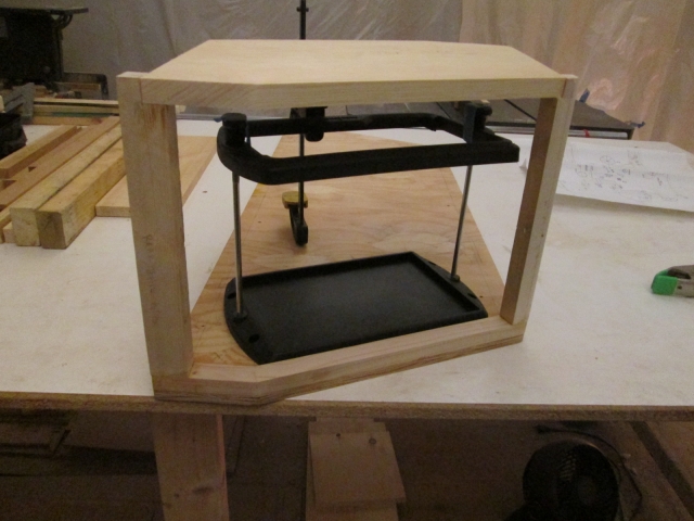

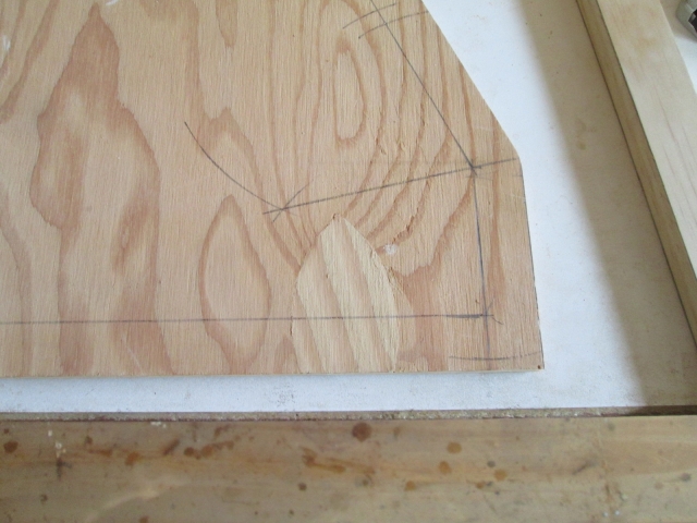

After resizing the floor of the TB and easing the corners, I used the sliding square to gauge off a line 1 inch from all of the edges; and the compass to bisect the front and side corners. This went a long way toward setting saw blade angles and determining the tip to tip and inside corner measurements for cutting the foam panels.

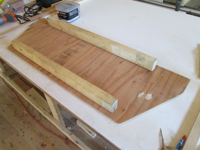

The plywood floor had a bit of a bow in it, so I screwed a couple of 2x3’s to the bottom as temporary stretchers. I may add a couple of smaller permanent cleats later.

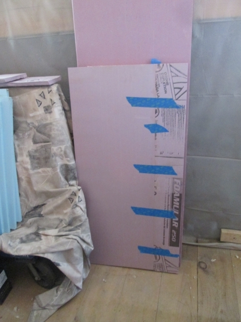

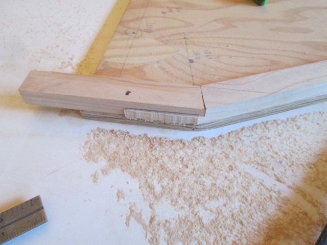

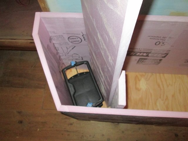

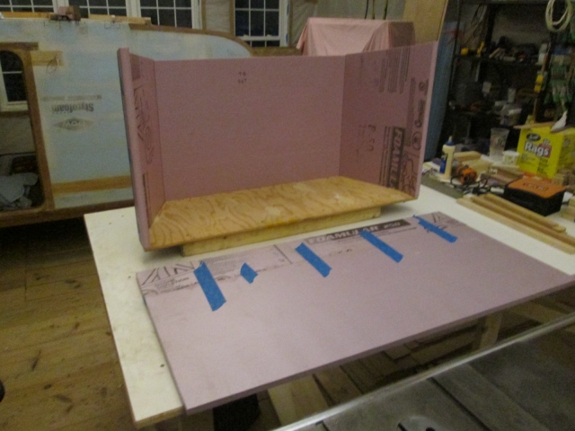

Next I harvested the foam from the shipping container Karl donated, but that stuff was pretty beaten up. One of the larger pieces was still in okay shape, but had a couple of sizeable dents, and a little wave pattern along about 1/3 of the face on one side. I opted to use this for the back where it would not tend to show and I wouldn’t have to worry about working it over enough to be presentable. The back wanted to be just slightly over 24 inches tall, so rather than adding a sliver, I cut away some of the damaged area and used a 6 inch wide piece to extend it back to the needed size. I used the tape hinge method to glue the panel up with PL Premium. Again, not too worried about having to sand the joint smooth; the harder PL would make this tricky.
I used the bevel gauge (a nice Rosewood and brass handle tool made by Crown that Yvette’s father had gifted me… he was a talented wood worker and furniture maker/hobbyist) to transfer the shed angle from the front locker onto the floor of the TB. By drawing a line across from the front to back width of the floor at this angle and comparing that to a perpendicular line, it gave me the difference in height between the front and the back directly w/o having to do any math. I was able to bevel the rear and miter the short side pieces that are perpendicular with the rear directly to this angle, but the angled side pieces that follow the angle of the A-frame tongue could be a little harder to figure… so I didn’t. I used the layout on the floor to measure the inside edge to inside edge and cut the beveled edges to this width. Then I matched one edge, the taller rear edge to the narrow side piece height on its front edge. Then I matched the front edge of this angled side panel to the rear edge of the beveled top of the front panel, and struck a line between the two marks. This turned out really close when I taped it all together for a dry fit up.
The back still needed to be cut to final width at this point.

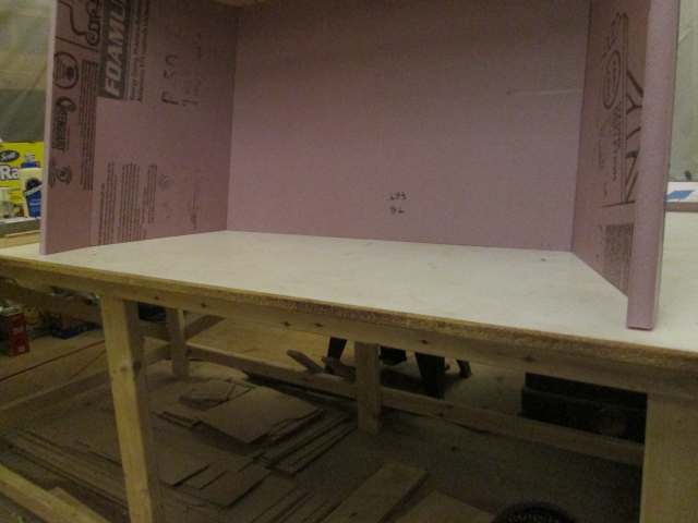

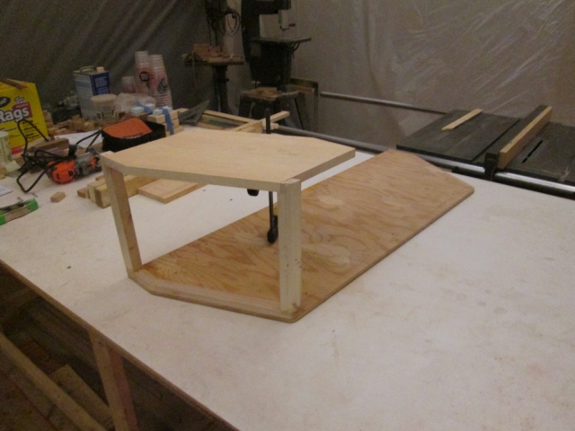

To adjust the tops of the angled sides I clamped some guide blocks on ‘connecting the dots’ and used that as a hard edge to trim to.
I want the angled top of the box to be all one plane (flat and fair) so that the top rim frame lays flat and has a good glue bond. To check progress I flipped the dry assembly over and checked it against the flat surface of the bench.
There’s a little gap under the rear corner on one side, but not too bad.

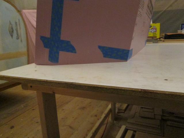

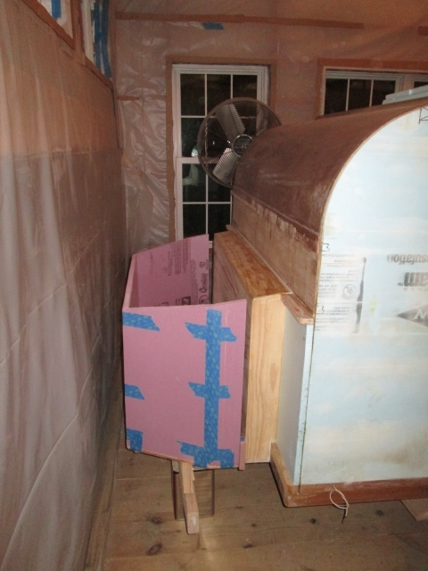

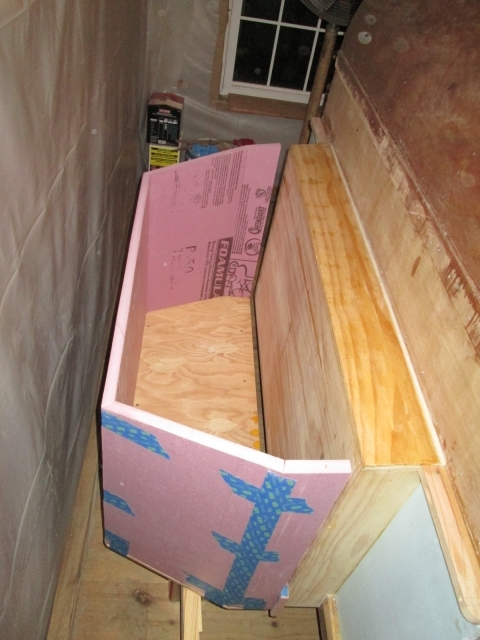

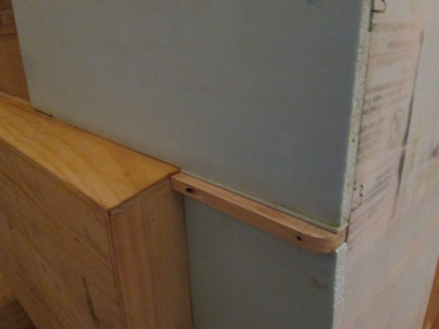

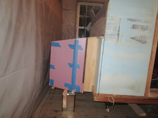

Then I could not resist the urge to mock it up in place, still w/o the back panel.
In this last one, shot straight on, you can see how the shed angle of the locker carries right thru the TB.
Today I cut the rear panel to width, dry fit it with tape then splayed the whole thing open on the bench. (Didn’t get any further than that because the weather was decent and I had to take the opportunity to do leaf removal at the house, one of the dandy fall clean up chores we get here in the northeast.
Before I close this up and make it harder to work on, I need to figure out a few things. I want to build a false floor, or partial false floor that will cover the battery, charger, circuit panel and solar controller (that I will remount from the portable panels). Also, the battery will need to be vented in such a way to prevent moisture intrusion, and I need to select the bulkhead fittings for the shore power and solar panel connections. Many of these things will need blocking. I am also considering following GPW’s lead and using chipboard as a lining to toughen the inside prior to skinning with bed sheets. If so, I will apply the chipboard in the flat before gluing the corners up.

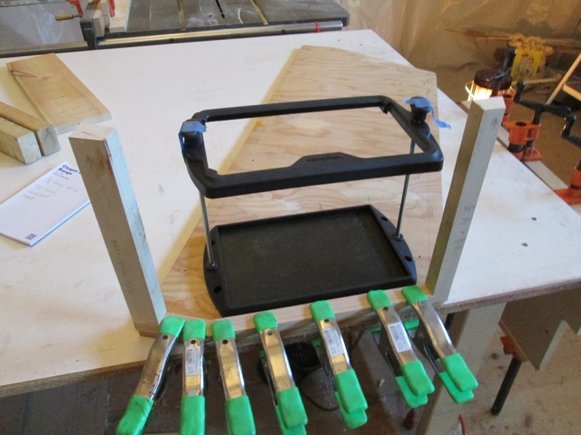

Postby KCStudly » Fri Nov 28, 2014 12:00 am

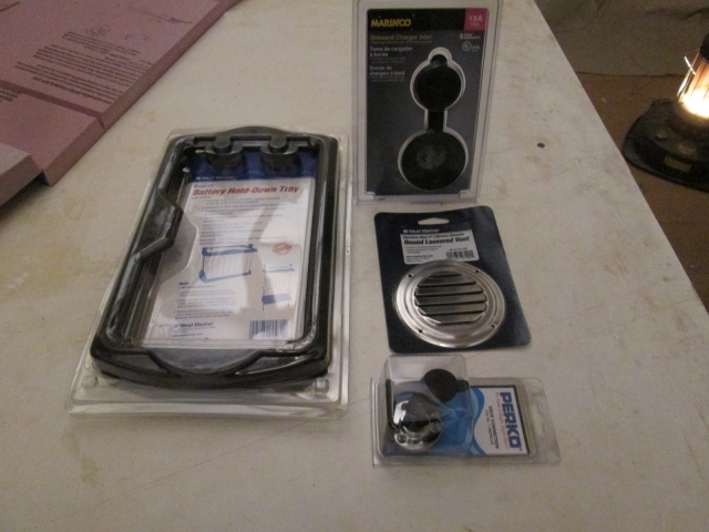

Yesterday I went by the West Marine store and picked up some things for the tongue box/battery compartment. There is a marine spec battery tie down; a 120V/15A shore power charging connector with rubber cap; a Perko through hull connector for the solar panel leads; and a 4 inch round stainless steel louvered vent cover.
The louver will be located on the back of the TB and I will make a baffle to go between the louver and the battery space to help keep moisture out.
I spent the rest of the evening contemplating possible arrangements trying to determine where I will need blocking and what would offer the best accessibility w/o killing storage space.
I didn’t like any of the options that involved having the fuse panel mounted vertically; that just didn’t seem to offer easy access or full visibility unless I put it high up further toward the middle of the rear panel. If I were to make the box hatch lower in the front (more like a curved galley hatch) that would open up the front of the box improving visibility to the rear of the box, but I like the simplicity of the flat hatch lid and the fact that it will be fully out of the way when opened and leaning back.
I considered making a board to mount the fuse panel flat over the battery, which I liked because it would make the panel much more accessible, but I didn’t like the idea of having to keep all of the connections flexible so that the board could be shifted out of the way to service the battery. Also, I have been struggling mentally with the less preferred practice of keeping the battery charger and fuse panel in the same compartment as the battery (let alone concerns about moisture coming thru the vent).
So, despite the fact that it complicates the build quite a bit, I think I have decided on a better design in the end. This next pic depicts a mock up. The plan is to partition off a corner of the TB for a separate battery compartment that is accessible thru a hatch on the lower side of the box. By making the battery compartment just high enough for the battery and to lift the leads and hold down clamp, there will be a natural and permanent shelf on the inside of the TB to mount the fuse panel, charge controller and battery tender; and they will be separated from the battery. This will also make it much easier to vent the battery compartment w/o worrying about moisture. The whole battery compartment can be glassed, I can put vent/drain holes directly into the floor of the box (in addition to the higher mounted louvered vent) and I won’t have to worry about making the access door seal water tight. Imagine this mocked up center divider only being a couple of inches taller that the battery and a solid ledge over the battery. The access door would be on the left, as viewed, and the access door, being only a little taller than the battery, would be hinged at the front corner (bottom left in pic).
Like I said, it adds some complication, but it solves a lot of things and, IMO, is a better design solution. Now I just have to work out all of the details.

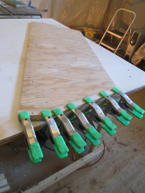

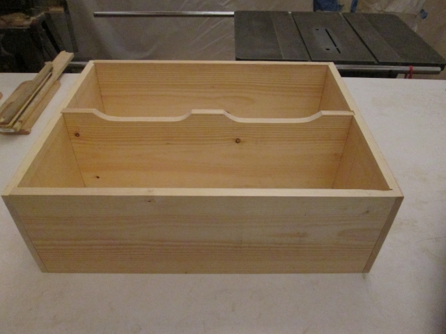

The 1x10 drops I had left over from the shelf unit weren’t quite wide enough for the top of the battery compartment (the “electronics ledge”) so I biscuit joined a couple together into a blank to be ripped down again later. It has been a while since I used the biscuit joiner last.
Clamped it up with some strips to protect the edges from the clamps and parked it in front of the heater.
Next, since the battery hold down tray has a raised lip around it, there was no reason not to add a rim along the outside of the battery compartment. This will help stiffen the edge of the TB floor and will give some added thickness for the battery compartment door. Here I have ripped the stock to the same 1 inch width as the foam, have formed a mitered half lap joint at the rear corner, and am dry fitting. The rough edge will be trimmed later.
Here it is after trimming to length and gluing up.
Next up I started making the jambs. Ripped some scrap 2x3 down to 1x1-1/2 actual then angle ripped the front jamb to match the front corner of the box. Just dry fitting here.
Before finishing the tops of these to join with the ledge, I ripped and cut the ledge to shape. It may seem like a big piece of wood, but I want to be able to sink screws anywhere I want for both the electrical components and any wire training items (such as ‘P’ clips, zip tie anchors and/or loom track).
The ledge will primarily be supported by the jambs and the 1 inch foam divider between the battery compartment and the main part of the TB. However, I also allowed for a 1/4 inch dado in the front and rear panels of the TB. You can kind of see that here at the rear by comparing the edge of the ledge with the pencil line representing the inside edge of the foam on the floor of the TB beyond.

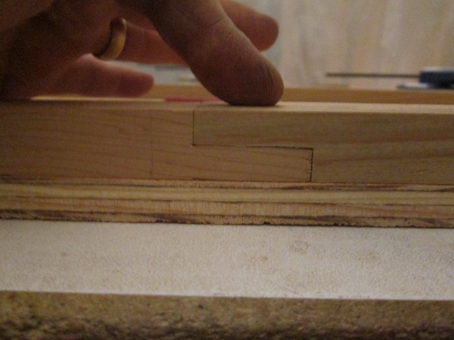

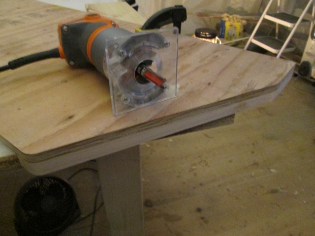

Next I flipped the floor over and used the top bearing flush cutter to trim the rim, matching the rounded corners of the floor.
The half lap in the rim came out pretty tasty, if I do say.
I used the same techniques as previously to mark and round over the front corner of the front jamb.

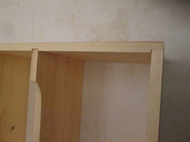

Here, after notching the tops of the jambs for the ledge, I have glued and Kregg screwed them down into the rim. The ledge is just dry fit for now, with the far edge being propped up by a quick clamp.
Before I get too much further I will need to drill the vent and mounting holes in the floor of the box. Tomorrow I will likely work on the blocking piece for the shore connections, the foam for the divider/ledge support, and possibly start modifying the box foam to suit these changes.
