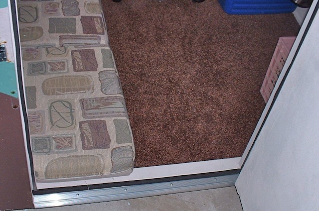

The little details ... got the weatherstripping on , not the straightest job in the world ,looks like it was installed by a drunken sailor :oops: but it seals nicely ... and found some “ Stair edging “ to finish off the floor edge ...
Also installed the other window , which is one of those front door peeper things ... Keeping it simple till I can find just the right window for the passenger side ... Image

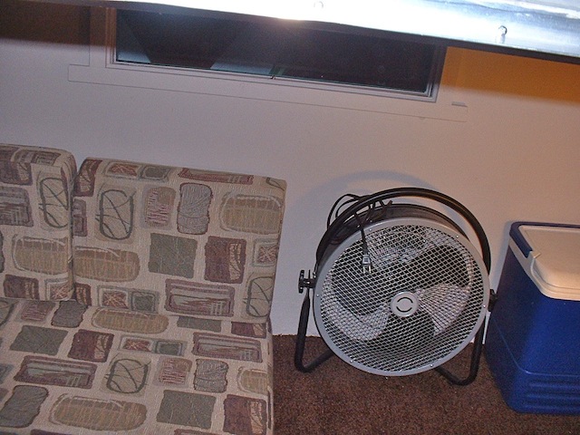

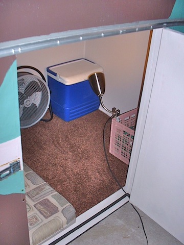

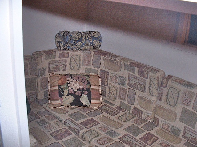

GPW wrote:Just some inside pics ...decorating Image
Still lots of room for more goodies...

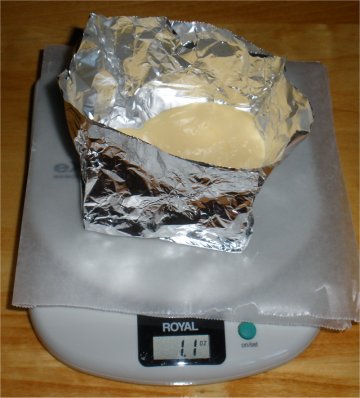

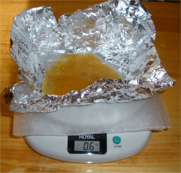

A question arose some time back (sorry I can't remember the poster) regarding the weight of adhesives, wet vs. dry.
The only applicable adhesive I have on hand is a couple of bottles of Titebond II so my test was limited to that only.
A one-ounce measure of Titebond II was dispensed and weighed both wet and dry.
The wet weight as shown on the scale was 1.1 oz which included the tare weight of the aluminum foil and wax paper; 0.1 oz) and the dry weight was 0.6 oz (the tare weight is assumed to be the same as the same materials were used.
The final jist is Titebon II will lose 50% of its weight.
