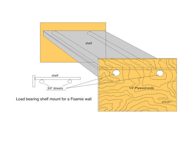

Postby GPW » Sat Sep 17, 2011 6:31 pm
Here’s one suggestion ... http://tnttt.com/album_ ... c_id=78197
Postby chartle » Sat Sep 17, 2011 6:43 pm
GPW wrote:Here’s one suggestion ... http://tnttt.com/album_ ... c_id=78197
Where does the 1/4 inch plywood go, inside or outside the foam?

Postby GPW » Sun Sep 18, 2011 6:19 am
CH, the ply goes on the inside and serves to spread the load across a large area of the surface...
Norm I can see the necessity on a larger trailer for stabilizers... On these small ones , it may not be needed ... Maybe !!! Or maybe just one ... if you’re trying to save weight ... and you’re planning on unhitching the Trailer .. :thinking:
