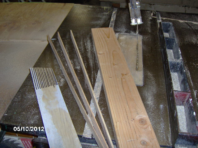

Postby KCStudly » Thu May 10, 2012 8:30 pm
Here are the slats and feather board I sliced up. If you look closely you can see the sawdust on the saw table. (WooHoo!)

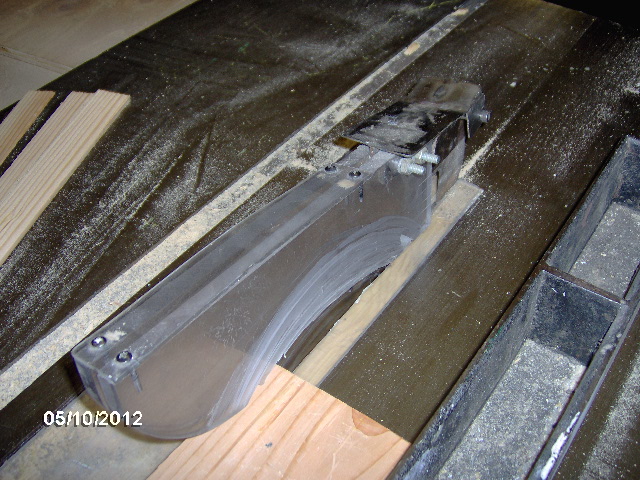

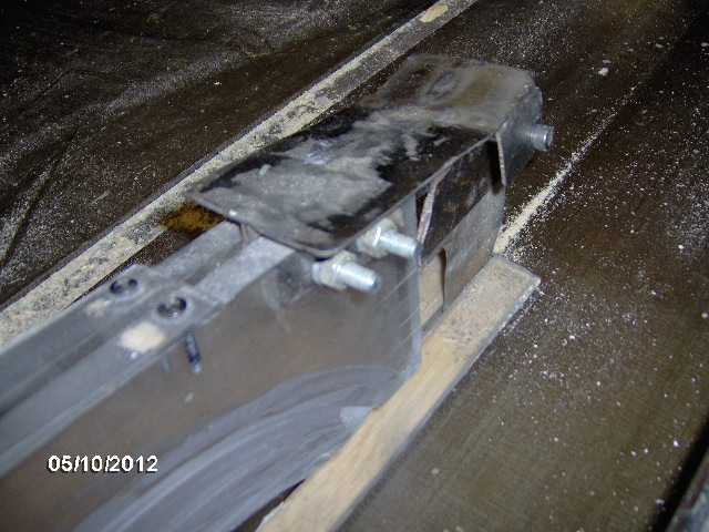

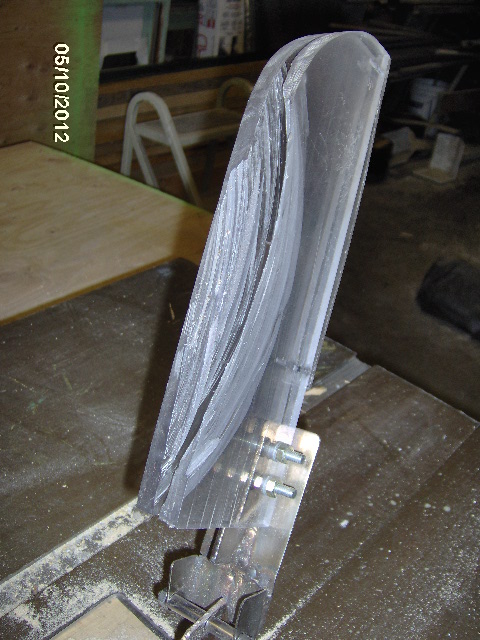

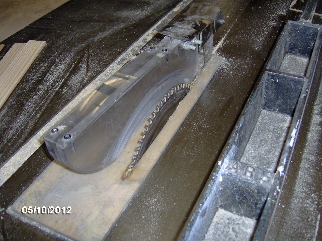

And some pictures of the crappy guard on the saw. The pivot bolt is too wide and low preventing the fence from being able to move closer than about 3/4 inch to the blade without bending over the splitter. The pivot bolt is loose so the guard flops from side to side getting chewed up by the blade, resulting in jagged edges on the underside that fetch up on the edge of the board when you start to push it toward the blade. The splitter itself isn't bad, but the guard is so sloppy that it tends to bend the splitter over, causing the board to bind or push harder than it should. I'll have to get this fixed before any serious work commences. I'm in good standing with the chairman of the safety committee (he is me) so I should be able to get this squared away in short order.
