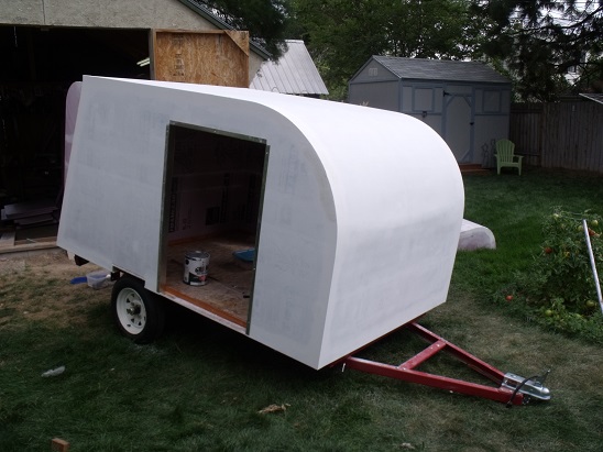

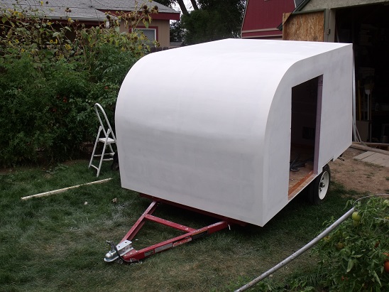

Been fairing, sanding and painting. I found that I could not tell how far I was sanding into the foam while fairing the edges so I decided to paint the trailer with Gripper since Gripper does not like to sand so well. Now if I see pink I know I am sanding into the foam.
3
DSCF2374 small.jpg (109.12 KiB) Viewed 2116 times
1
DSCF2371 small.jpg (123.58 KiB) Viewed 2116 times
2
DSCF2372 small.jpg (133.54 KiB) Viewed 2116 times

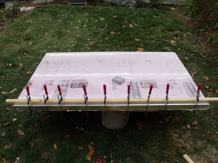

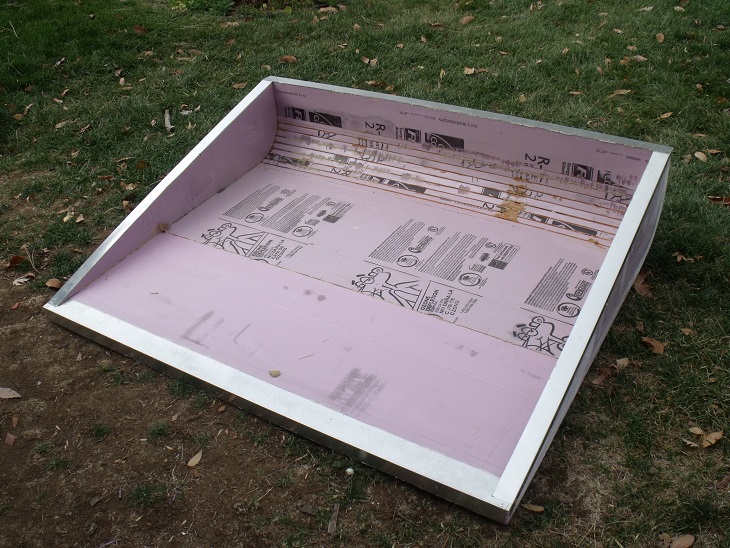

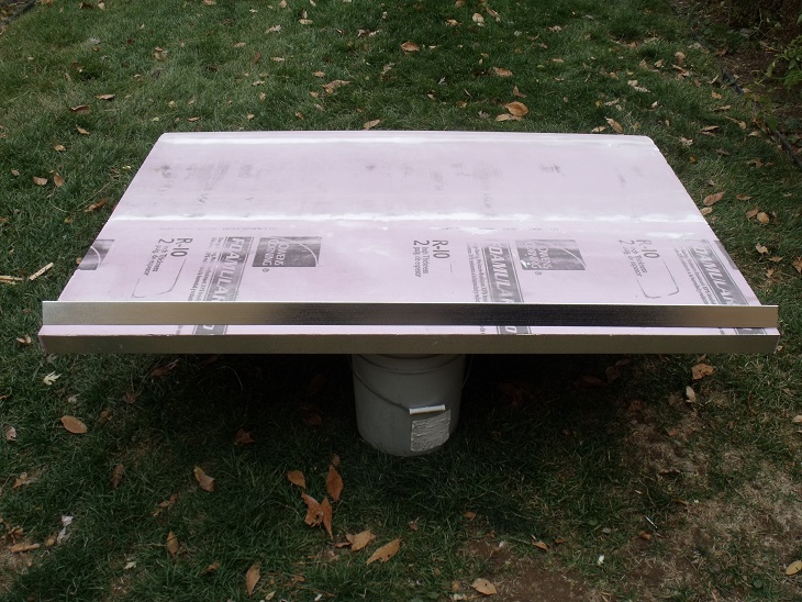

Trailer building around here is starting to slow down. Too much other things going on and now the weather is changing to cold. In fact it snowed here this morning. First fall of the year. I did manage to get the bottom edge of the hatch glued on. I used 2"x3" flashing and installed one inside and one outside, overlapping the two on the bottom. Makes a strong channel for edge protection and a hard point for latches and maybe lights.
Inside
DSCF2403 small.jpg (224.16 KiB) Viewed 1909 times
Outside ready to be attached
DSCF2405 small.jpg (209.13 KiB) Viewed 1909 times
Outside attached
DSCF2406 small.jpg (215.9 KiB) Viewed 1909 times

That looks real good. I must say, your "discovery" of using flashing for edge protection moves the state of the art ahead by a lot... I'd have done things differently if I were intelligent enough to think of it. :? :shock: There'd be no trim pieces around the sides. I think it worked out OK but that was more work than I needed to do. :NC :( :o
