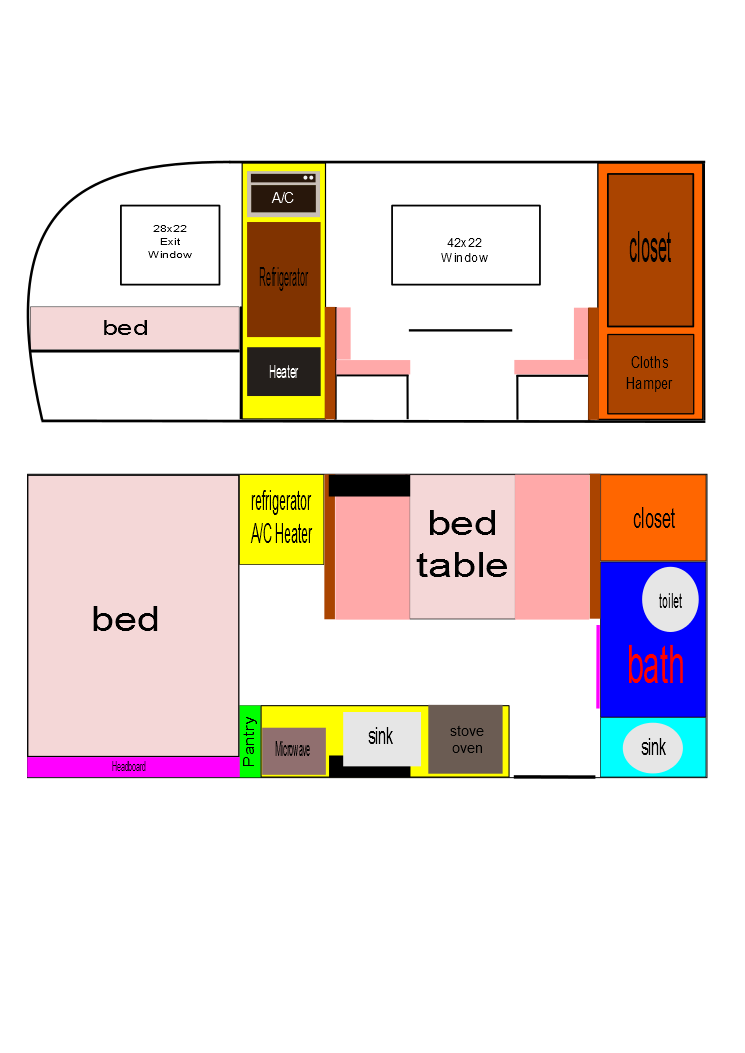

Postby ghcoe » Sat Mar 01, 2014 10:54 am
Still in the developing stages, but this is what I have so far. :twisted:
I first had to come up with what we really wanted in a trailer.
1. We wanted something small, easy to tow and get into small camp sites. It's a foamie, so it should be light and easy to tow. Body is 7 feet wide so should fit nicely behind tow vehicle. Height is 6 feet from floor to ceiling, again should fit nicely behind TV.
2. We wanted a bed that was set up for full time use and not a convert a bed. We are just tired of converting sitting areas and sleeping on small foam pads. Also we did not want to be cramped in bed, so a Queen sized mattress was in order of course. The logical place was the front to allow for the aerodynamics for the front. Bed is at bed height to allow for next.
3. We wanted good storage for common items for trips. Good storage areas under bed with access from both sides as well as inside. Also, good sized closet in bathroom with cloths hamper under it.
4. We wanted a common area. Since we wanted to stay small and have a full sized bed we had to compromise on the common area. The dinette will serve as the common area. For two people this will be fine. For six it will be a bit crowded.
5. We wanted the ability to sleep extras just in case. The dinette will convert to a full sized bed and another full sized bed will store up against the ceiling. Don't worry, this area will be beefed up some not just foam. I have a great plan that the Europeans use in some of their plans.
6. We wanted a bathroom. Just in case we want to boondock. A lot easier to have a bathroom with shower if your not on the system.
7. Of course heat, A/C, water storage, cooking areas.
I took designs I found I liked from other trailers.
I like the old Burros and the newer Casita trailers http://www.casitatraveltrailers.com/.
I also like the European designs. They are just better at design, inside and out. Their models are more car friendly too http://www.buerstner.com/int/caravans.html.
I will probably be building this one on a EZ loader boat trailer. I like the EZ because it is easy to move the axle back and forth on the frame. I am hoping to drop the hallway down up to 6" to allow for more head space in the trailer as well.
Well there it is as it is now.

Postby wagondude » Sat Mar 01, 2014 12:34 pm
So if I am looking at your plan right, your door is street side? Not a problem boondocking, but in a developed camp, you would be stepping out into your neighbor's yard. It would also make loading/unloading dangerous if you were not parked in a driveway.

Postby ghcoe » Sat Mar 01, 2014 2:33 pm
No, the plans are flipped. I caught that too, just have not gotten around to reversing it.

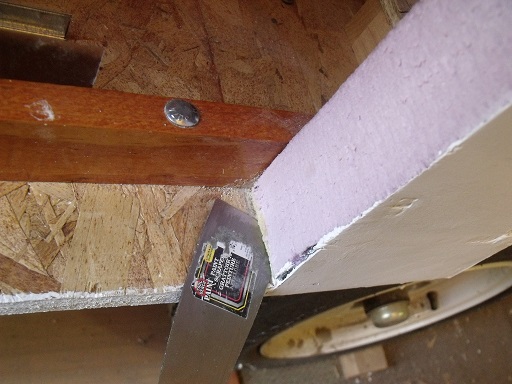

Postby ghcoe » Sun Mar 30, 2014 8:32 pm
Worked on the trailer a bit today. Went ahead and put a threshold in. I used a 1"x2" flashing piece cut to be 1/2" wider the threshold. I made it slightly wider because I want to slide each end up under the walls. first I had to cut a groove for the flashing to fit into on each side. I used my sharpened putty knife to make the cuts.
Groove
DSCF2852 small.jpg (102.43 KiB) Viewed 1830 times

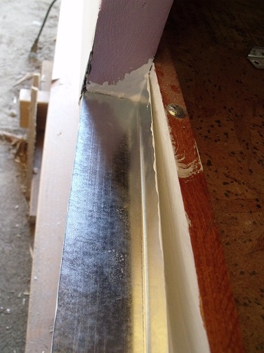

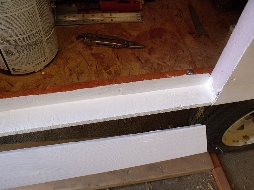

Then I applied Gripper to the threshold. I made sure to get it heavy on each end where the flashing will slide under/behind the wall. This is to make sure I get a good water tight seal there. I also painted the back side of the flashing so I have a Gripper to Gripper bond.
Gripper for glue
DSCF2853 small.jpg (101.56 KiB) Viewed 1830 times
Then I slid the flashing behind/under the wall on one side and then slid it back under the other side by a 1/4".
Sliding in the flashing
DSCF2854 small.jpg (114.44 KiB) Viewed 1830 times
Then to clamp and wait. It is still a little cool here so I will give it a few days to dry.
After this I will be adding the door frame and then I will add a tapered piece of plastic to shed water to the outside edge before adding the door.
