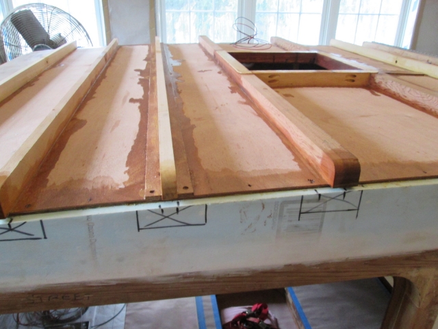

Yesterday, I thickened the pot up to 75/25 poly and made another round. The areas that had 2 or 3 coats of 50/50 still showed some grain, but also had signs of soaking along the grain a lot further than where I had applied it. Based on your feedback I expanded the areas being treated to include the roof seam backers and the corners where the spars meet the top of the ceiling panels.

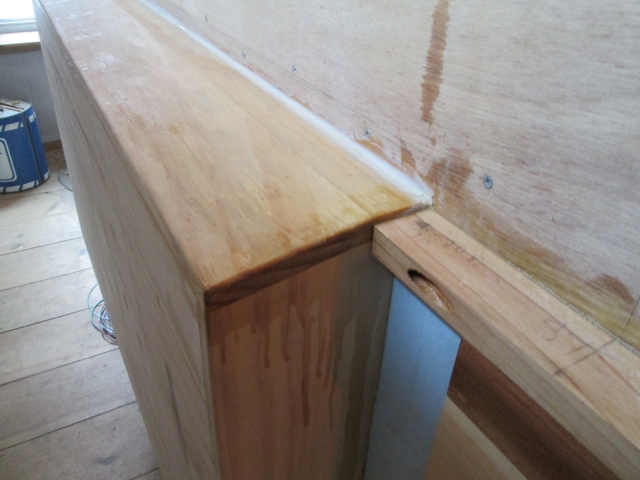

Hit the end grain on the top and bottom plank of the locker bump out.

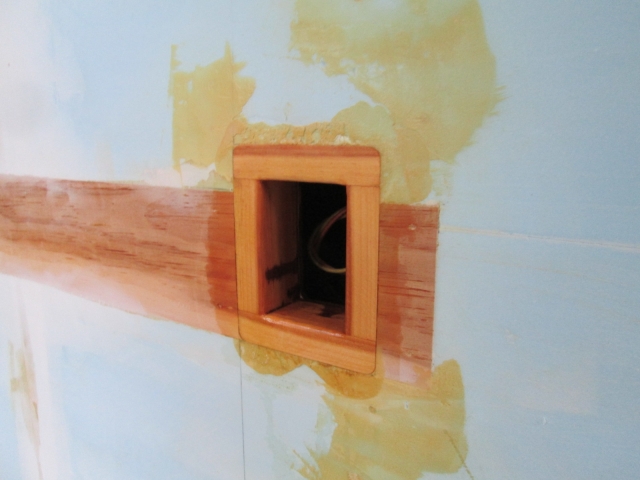

Hit the recess for the hatch actuator switch.

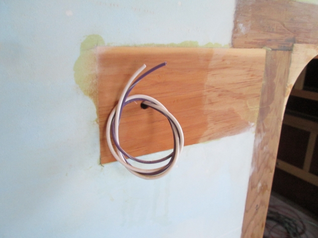

Dabbed the brush bristles into the wire holes for the porch lights and around the area where the screws will go to hold the lights in place, even though these will get sealed with goop at install.

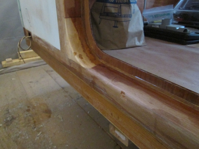

The top of the front wall splice was pretty well coated with epoxy from the glass reinforcing, but the lower edge wasn’t so I hit that area well.
Then I went back and hit all of the previous areas again; vent fan frame, ceiling edges, spar ends, marker light recesses, and door seal flanges (shown here).
