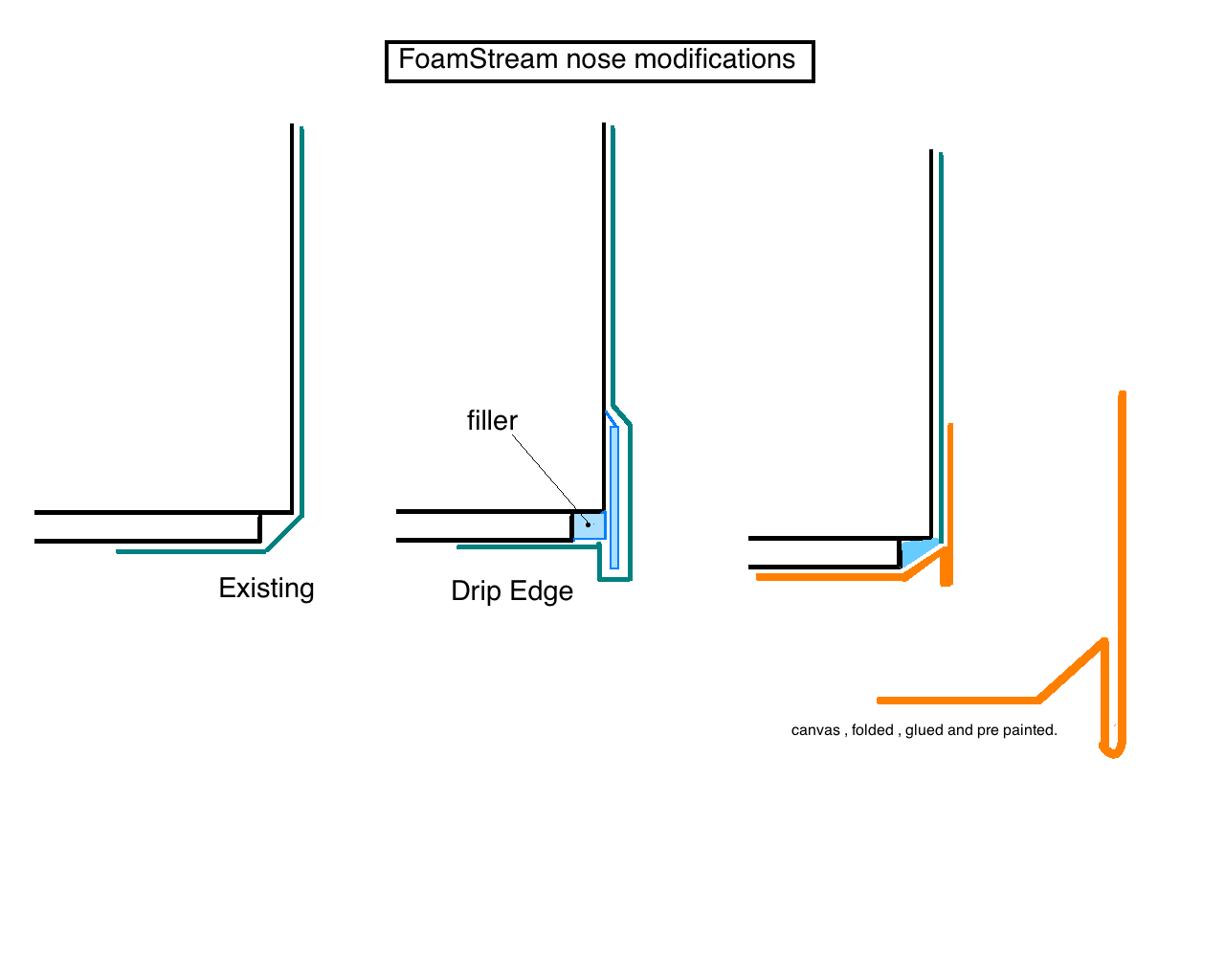

Naturally since I sprayed the foam in the kerfs on the trailer nose , it Rained , and pretty heavy too ... and just checked , the inside is DRY , not a hint of water wicking in ... so that’s a “Good Thing” ... :D A quick and easy Fix !!! The essence of Foamie construction!!! Now , we’ll clean and neutralize the mildew, and then glue the de-laminated spots back together , I’m making small plywood pads that will serve as clamps for the plywood re-gluing ( + waxpaper) ... then repaint and then were done .... and just in time for Hurricane season too (June 1 ) ... the sole reason the FS was built ... and aside from the current repair, I’m ready this year ... "Justin Case" ... :NC
Note: I am temporarily ignoring the small damaged canvas area at the very nose .... that’s all foamed in now so no problem with rot or water intrusion . The reason for the delay is to further explore possibilities for a simple “drip" edge style addition to the nose , and possibly sides too ... It has to be SIMPLE , and effective , yet be able to be installed successfully by anybody . Currently thinking about Eternabond tape or something similar like a piece of folded canvas ... until we find something better ... :thinking:
Re: FoamStream...
Postby GPW » Sat May 16, 2015 7:14 am
.... and furthermore ... since really heavy canvas is available , a bent folded canvas strip might do the job , as seen in the Orange drawing included . That would be as simple as it could get , but still be flexible and effective... Thrifty too . 8) Sometimes it’s the SIMPLE things that work Best !!!
