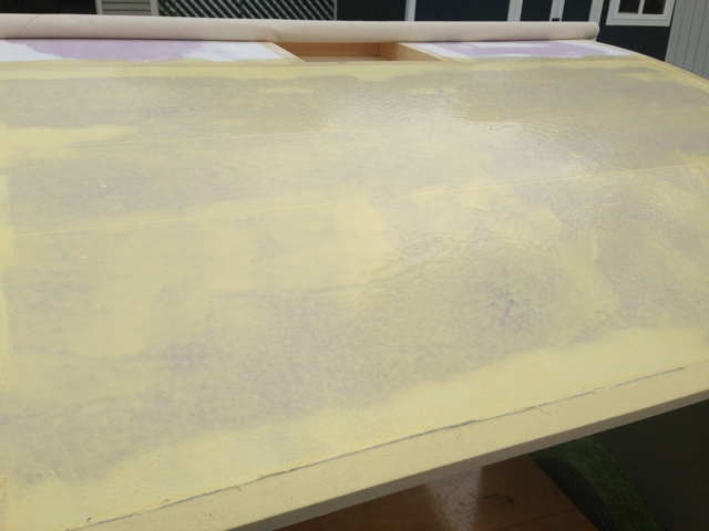

Postby dales133 » Mon Aug 10, 2015 10:33 pm
Hey GPW quick question if i may.
Whats the least wasteful way to apply the tb2 to stick bed sheets on?
Im using heavier canvas on the sides and my roof is going to have aluminium floated over it so im going with sheets instead.
If i was to use a roller what sort of slieve would work best without wasting a ton of glue getting soaked into it.foam or those fluffy ones.
Or could i just brush it on?.
Thanks in advance!

Postby mikeschn » Tue Aug 11, 2015 6:46 am
Dale,
For large areas like the sides, I use a roller. I've tried the adhesive rollers, but prefer the standard rollers. Use 1/4" nap or 3/8" nap. Yea, your going to lose a little bit of glue due to the roller sucking it up, but you need the roller for speed, and ability to apply glue thick enough. I used 3/8" nap on the outside of the Mad Dash, and put the glue on nice and thick, and it worked well. My 10 oz canvas even shrank a little bit, giving me a nice taut finish! I used the glue full strength.
Re: FoamStream...
Postby GPW » Tue Aug 11, 2015 6:52 am
Dale , just a standard roller works fine ... or a brush (more work) ... Remember to thin the T2 a little to get it to roll easily ... You can see how well it worked for Mike ^ .... me too ... You want 100% coverage of the glue , no dry spots ... The Glue is one of the cheapest components so don’t stint on that ... ;)

Postby dales133 » Tue Aug 11, 2015 7:07 am
mikeschn wrote:Dale,
Thanks to both of you
With the old second hand bedsheets for the roof theres obviously no point in washing and preshrinking them but how wet should they be.
Should i mist them with water prior to fitting to the glued up ply?
GPW wrote:Dale , just a standard roller works fine ... or a brush (more work) ... Remember to thin the T2 a little to get it to roll easily ... You can see how well it worked for Mike ^ .... me too ... You want 100% coverage of the glue , no dry spots ... The Glue is one of the cheapest components so don’t stint on that ... ;)
