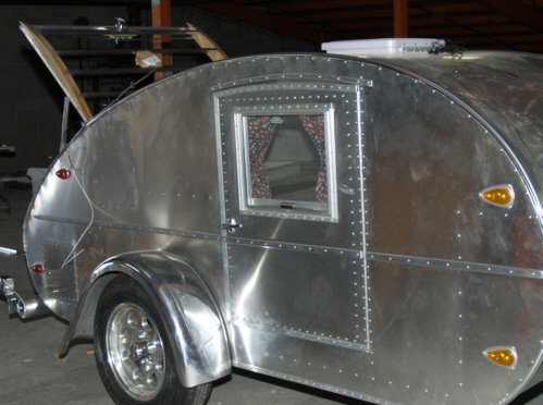

question for the experts of this "covered foam" construction method.
would the strength be compromised by using some type of covering on the top and sides that woul d not be a "wrap". Like a thin aluminum, vinyl, or even 1/16" or 1/8" laminate finish wood.
I'm thinking this would be easier to glue to the foam but if the stength is mostly in the shell that becomes sorta one piece once all the glue is dried into the cloth, then the lanimate coating would not work as well.
swampjeep
Posts: 203
Joined: Mon Apr 04, 2011 7:51 pm
Location: waterford mi
Postby mikeschn » Wed Apr 27, 2011 5:26 pm
Glued aluminum would not stayed glued for long. With the thermal expansion and contraction the joint would quickly be broken. And if you didn't have your aluminum sides screwed into something, you would lose it in the wind.
If you want to use aluminum, you are far better off building a wooden framed structure, and attaching the aluminum to that.

Postby swampjeep » Wed Apr 27, 2011 7:31 pm
Thanks for the answer on the alum. I had not thought about that, but like alum siding on a house, I see what you mean.
any one have any idea about a wood laminate?
main question is does this take away the strenth provided by the "shell" or if it would still be as strong with the foam all glued together and a coating on the foam.

Postby GPW » Thu Apr 28, 2011 5:32 am
We know home siding expands and contracts, whether vinyl or Al ... But makes me wonder if the Al and vinyl do that at a similar rate (they both require a loose mounting on a house , so they can move ) ... Wood doesn't .. many found that out already ... but the foam might ??? More for testing ...
Postby lm248 » Thu Apr 28, 2011 5:40 am
GPW wrote:We know home siding expands and contracts, whether vinyl or Al ... But makes me wonder if the Al and vinyl do that at a similar rate (they both require a loose mounting on a house , so they can move ) ...
Vinyl expands and contracts a "lot" more than Al.
