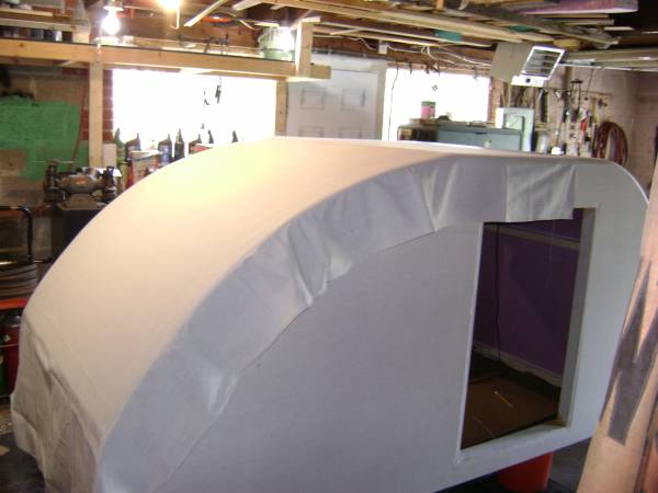

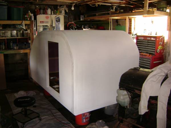

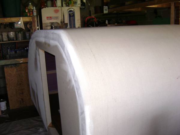

Last couple of days, I completed skinning the TD. Trimmed all edges best I could, ironed the whole thing. Skin came out tight and smooth. Hint, if you are using canvas drop cloths from HD, and need to cut them, brush a bit of watered down TBII along the cut line and let it dry before cutting. This will prevent fraying of the fabric. All I have to do to finish the exterior is paint, install the window, and make a door. Then I can mount on the trailer and finish the interior. I'm heading out now but here are some pics of progress.Image

Postby eaglesdare » Thu May 12, 2011 12:00 pm
great tip to prevent the fraying! gpw also recommends pinking shears.
but your tear is looking really really good! so you are not going to cover in the diluted t2?

Postby pat g » Fri May 13, 2011 7:06 am

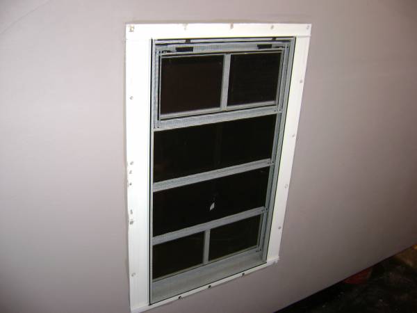

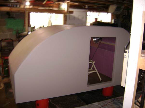

after reading all the discussion about paints and sealing, etc. I just went straight to a good quality primer. The thing soaked up almost a full gallon of primer in one coat! Pinking shears? I forgot all about that. That actually would give character to the seams. Yesterday I got on the first coat of color. My wife picked out a kind of grey beige to match my S-10. I think it looks good. Gonna be busy the next few days so I'll be updating with new pics and progress early next week.

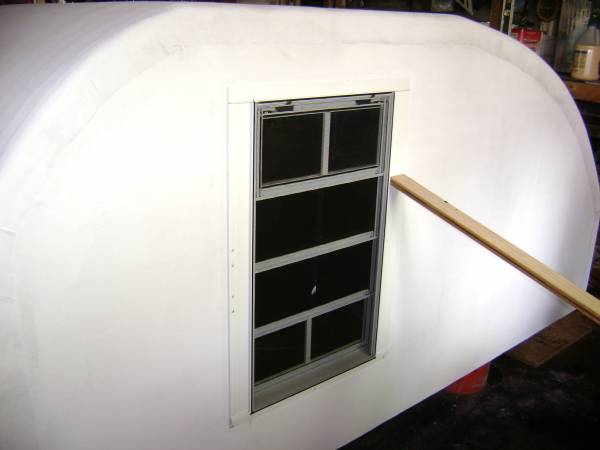

Postby pat g » Mon May 16, 2011 8:20 pm
Hey All,
Did not get to do too much today but I did manage to get the window installed and add wood to the door for hinges and a latch. Gotta let the glue dry before covering the door.
