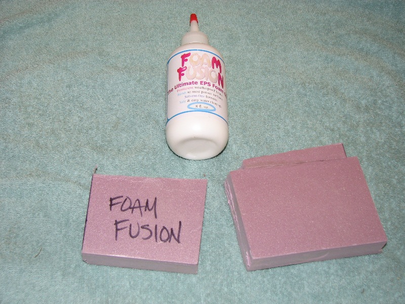

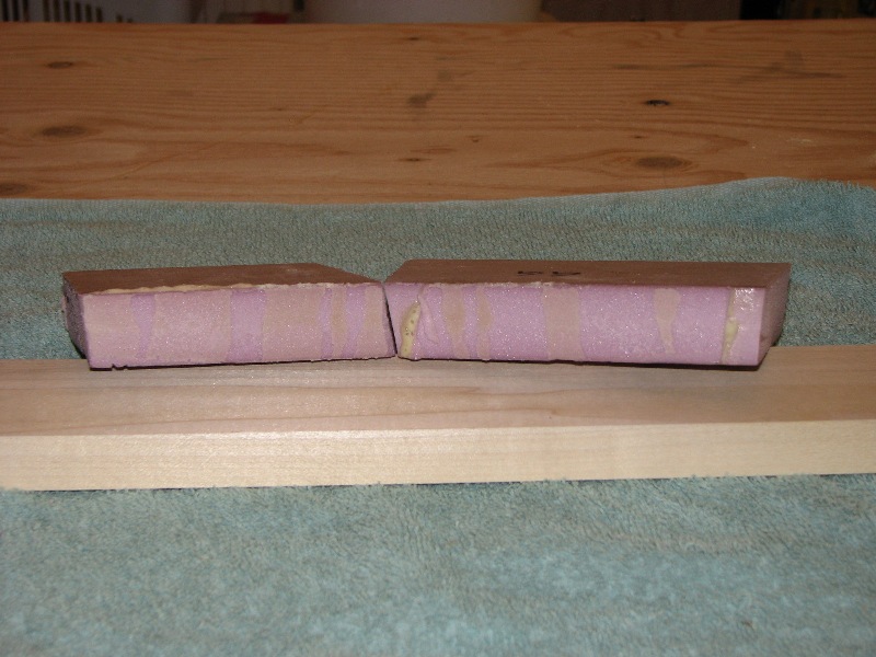

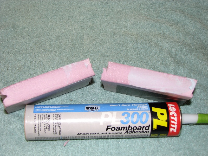

To anyone who was interested in the performance of the products in the website mentioned at the start of this thread, I promised some pics of glue-ups using different glues and testing them to failure. These glue ups were edge to edge and I get different results from the four different glues tested. In each case, I am using 1" pink foam. I used a good amount of glue and clamped them for 24 hours then let them cure for an additional 24 hours. I then pulled on each test piece until it broke.
Here are the results
The first glue up is The Hot Wire Foam Factory's Foam Fusion
It is the only sample where the glue held and the foam broke.
Next is GG
The two edges you see in the picture were the bonded edges. The joint held until the glue broke.
Next up is PL Foamboard adhesive
The results are similar to the GG results. The joint held until the glue broke.

I've decided that I will use the Hot Wire Foam Factory Foam Fusion for any glue that I need in my Road Foamie.
I've also face glued two pieces of foam with it and have not been able to break the pieces apart. :thumbsup: :thumbsup:
