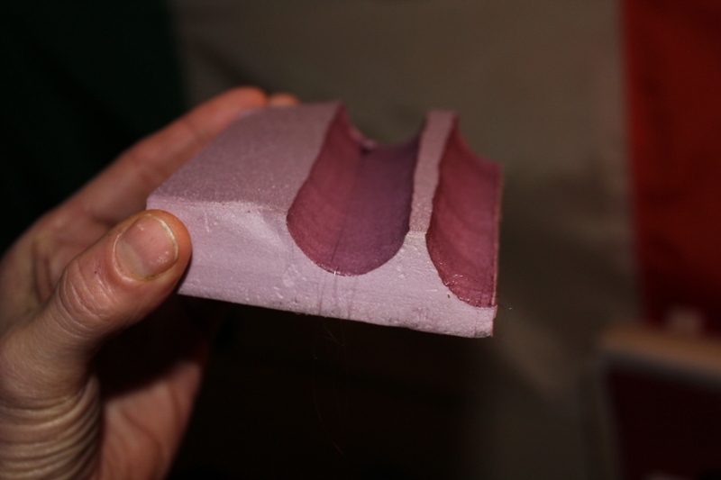

Postby allan1 » Mon Jan 23, 2012 11:43 pm
smaller pics next time ... couple others in gallery. What a versatile process. Woodworking in foam! :D Crown molding for the inside, baseboards ... hmm, an art deco or craftsman theme maybe.

Postby atahoekid » Tue Jan 24, 2012 12:11 am
allan1 wrote:smaller pics next time ... couple others in gallery. What a versatile process. Woodworking in foam! :D Crown molding for the inside, baseboards ... hmm, an art deco or craftsman theme maybe.
What exactly did you do/use to make those cuts? That is awesome :applause: :applause: :applause:

Postby allan1 » Tue Jan 24, 2012 9:03 am
[/quote] What exactly did you do/use to make those cuts? That is awesome :applause: :applause: :applause:[/quote] A Weller trigger style solder gun. There's a pic of it and a couple more in my album. It's a bit crude in that the wire has some play to it - smaller diameter than the holes in the gun and it's awkward / heavy to hold for accuracy. Could be okay for crude cutting though. A better way to insert wire is to not pass through hole in nut but through the hole tapped into the side of the barrel - snugger fit. Too bad that the output is still AC, it could have been adapted as a power supply but much too dangerous for accidental shocks as is :thumbdown:
