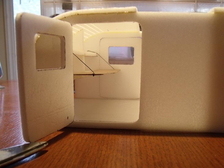

The wife was looking at my model tonight and asked why I had two doors? I told her that it was so it would be easier to get out if she needed. She said climbing over me was half the fun... :shock: Well It was funny that she asked because I was contemplating on just making one door and putting in a larger window on the other side. So it looks like I may be changing the big plan some. Too late for this model for now anyway.
Been working on my drop down door/shelf on the back and trying to figure out the prop rods. I knew this model would come in handy. I had not even thought of the prop rods. I though... oh I'll just stick them in there when I am ready.... Now it's, where the heck am I going to put the prop rods. I designed the back so tight I did not think to give them room..... :roll:

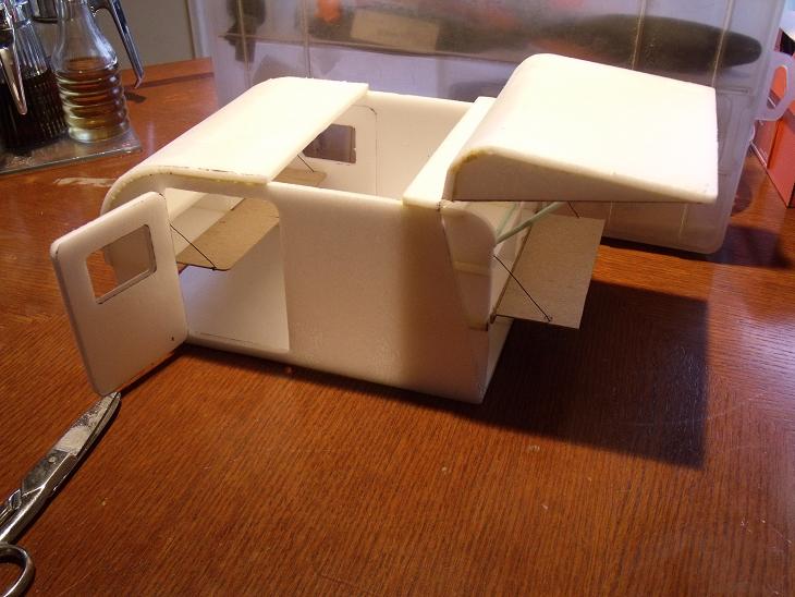

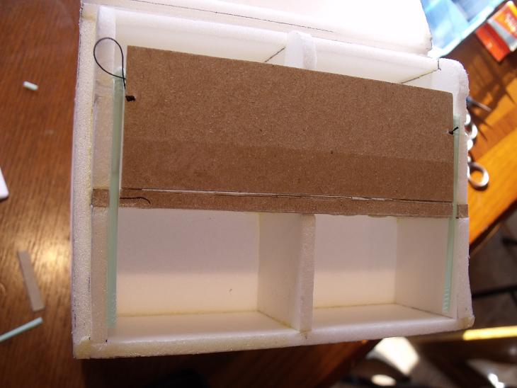

Postby ghcoe » Sat Jan 19, 2013 3:50 pm
So I have been thinking about the prop rod situation and think I have come up with a doable idea. This would in fact help with a couple of other build problems/ideas I was working on too so this should be a win, win idea.
So in my plans I was to build a rail on the top shelf to kind of have something to keep items from falling off and have a upper chain/rope attachment for the shelf support. I was already working with the idea of a conduit or PVC pipe for the upper rail so I just built on that and was able to come up with a hatch support rod, upper chain/rope support and upper rail all in one. :D
So the idea is to drill holes the same size as PVC into the up right shelf supports near the upper shelf height. A T and maybe a elbow would be used to attach the hatch supports to this rod that will act as a upper shelf rail. Then the shelf support will also attach to this rod. The hatch supports will swing down and sit right beside the shelf when in the down position.
