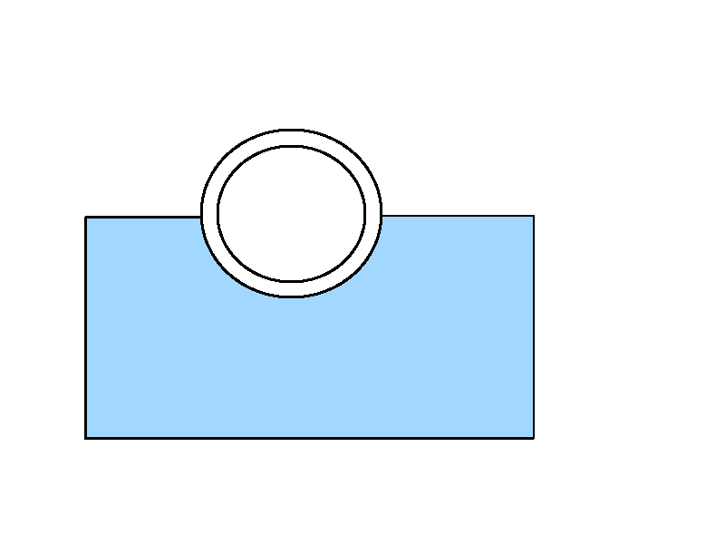

JST, that frame is Super !!! :thumbsup: Makes me think of coming up with a hot wire tool to cut /channel the foam to accept the PVC better , glue it all up solid ... :thinking:

GPW wrote:Makes me think of coming up with a hot wire tool to cut /channel the foam to accept the PVC better , glue it all up solid ... :thinking:
That's a cool idea and it would make a smoother edges and seams, you can see where all my round pvc is but I can live with it's still pretty comfortable compared to my last this one has the bed long ways instead of side ways.
I cut the foam snug and then ran a bead ok calk down each of the edges, it went through a pretty good rain storm at the CRA gathering last summer and only had on tiny drip by the roof vent and no tape lost. I'll fix the drip when I panel the inside and canvas it and it should hold up to about anything. We hit 65-70 pulling it and it pulls like a dream.

In some instances , we could cut a half circle channel , and laminate the PVC between 2 layers of foam .. leaving the ends to be "plugged in" .. A wall with a built in frame in the middle ... many possibilities ... 8)
