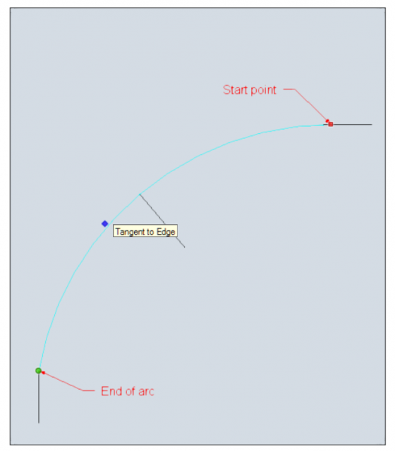

Teri, I'm still going thru the tutorials and playing with the basics. I seem to have a problem stopping the line / cursor at a measurement. Always seems to be either just short of or longer than the measurement I want, very sensitive or too much coffee. Need to get further into the tutorials to figure out how to get that arc between the curve front and the curved roof. I'll keep at it all least for awhile.

Olddog1 wrote:Teri, I'm still going thru the tutorials and playing with the basics. I seem to have a problem stopping the line / cursor at a measurement. Always seems to be either just short of or longer than the measurement I want, very sensitive or too much coffee. Need to get further into the tutorials to figure out how to get that arc between the curve front and the curved roof. I'll keep at it all least for awhile.

Hi Lamar,
For EXACT line lengths, start the line, drag the line in the direction you want, TYPE (numerical value) in the length, and press ENTER. Presto! An EXACT Length!
Curves are a bit trickier. Start the curve very close to the end of an existing line or curve BUT NOT at the end point. Put the other end of the arc close to the end point of the other line or curve and when you move the cursor to describe the "bump", at some point the temporary curve will change color (Cyan on my computer) and a pop up (assuming they are turned on) note will say Tangent to the start or end line or curve. Not that the curve will probably be only tangent to only the start or end point. If the curve is still unsatisfactory draw another curve from the "kinky" end. Again, NOT at the end point. See below:
Note the start point and also the end of arc point. The arc drawn is tangent to the line AT the start point near the endpoint. The end of the arc isn't tangent to the other (vertical) line. By picking different end points and drawing an arc from the other line or existing arc you can make a reasonably smooth curve.
If you ZOOM in to the arc start point, you'll see an orphan line segment that can be erased.
For truly smooth curves, download the RUBY script for drawing Bezier curves. However, that's an advanced topic and I suspect you brain is about to explode already. :lol: There are many flavors of Bezier curves in case you didn't know. :R
