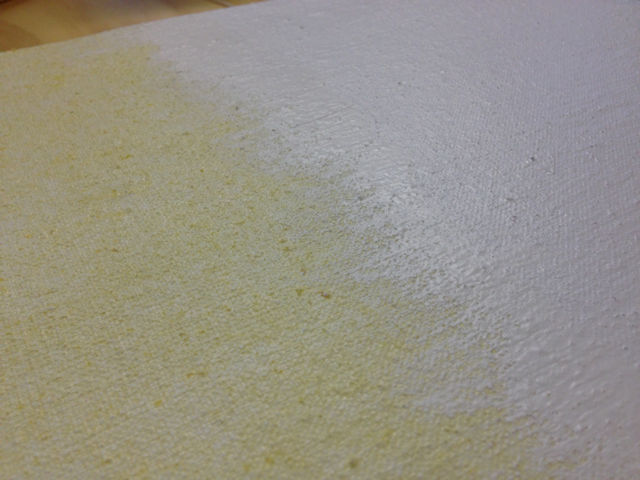

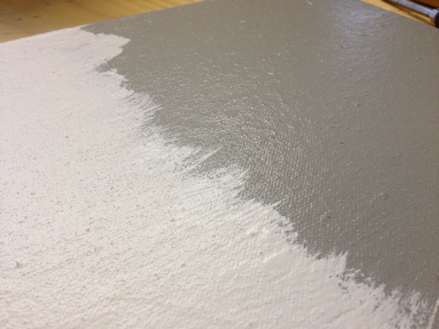

Well, here's the final results. They all look good, and I think any one of the finishes would do well to protect the foam and wood underneath...
Gripper on the left, garage floor paint on the right
TBII on the left, gripper on the right.

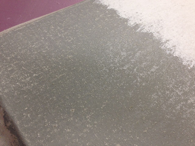

Postby mikeschn » Mon Jul 13, 2015 4:40 am
I sanded the 3 samples... They all sanded nice and smooth. The dark gray shows best what happens to the paint after you've sanded. It certainly needs another coat!
