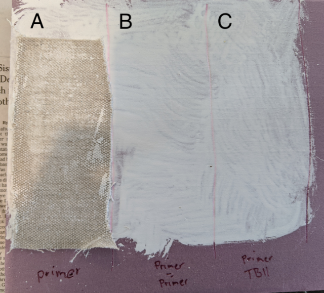

I painted a fragment of pink foam with the Valspar primer and applied some also to some canvas and pressed it into place as shown in panel A in this photo:
After drying for 24 hr, I glued more pieces of canvas to the dried primer with Valspar (panel B) or TBII (panel C) below.

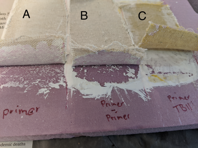

After drying for another 24 hr, the glued strips were ripped off to test adherence to the foam. In both panels A and B the glue remained adhered to the foam since the failure showed foam at the fracture surface. In contrast, the TBII adhered poorly to the dried primer. I thought maybe this bonding could be improved by sanding the primer surface. I reglued the canvas to the sanded primer surface using TBII again. It still failed to adhere to the primer well (panel C).
I have never been able to lay my hands on Gripper so I cannot compare with the Valspar primer. I conclude that
the Valspar primer binds very well to foam and it binds to dry primer very well also.
I am concerned that TBII adheres very poorly to foam primed with Valspar, much less than it does to unprimed foam.
Is this a feature of Valspar or am I doing something wrong here?
It would seem that Valspar bonding primer should not be used as an undercoat if TBII will be used to adhere canvas.

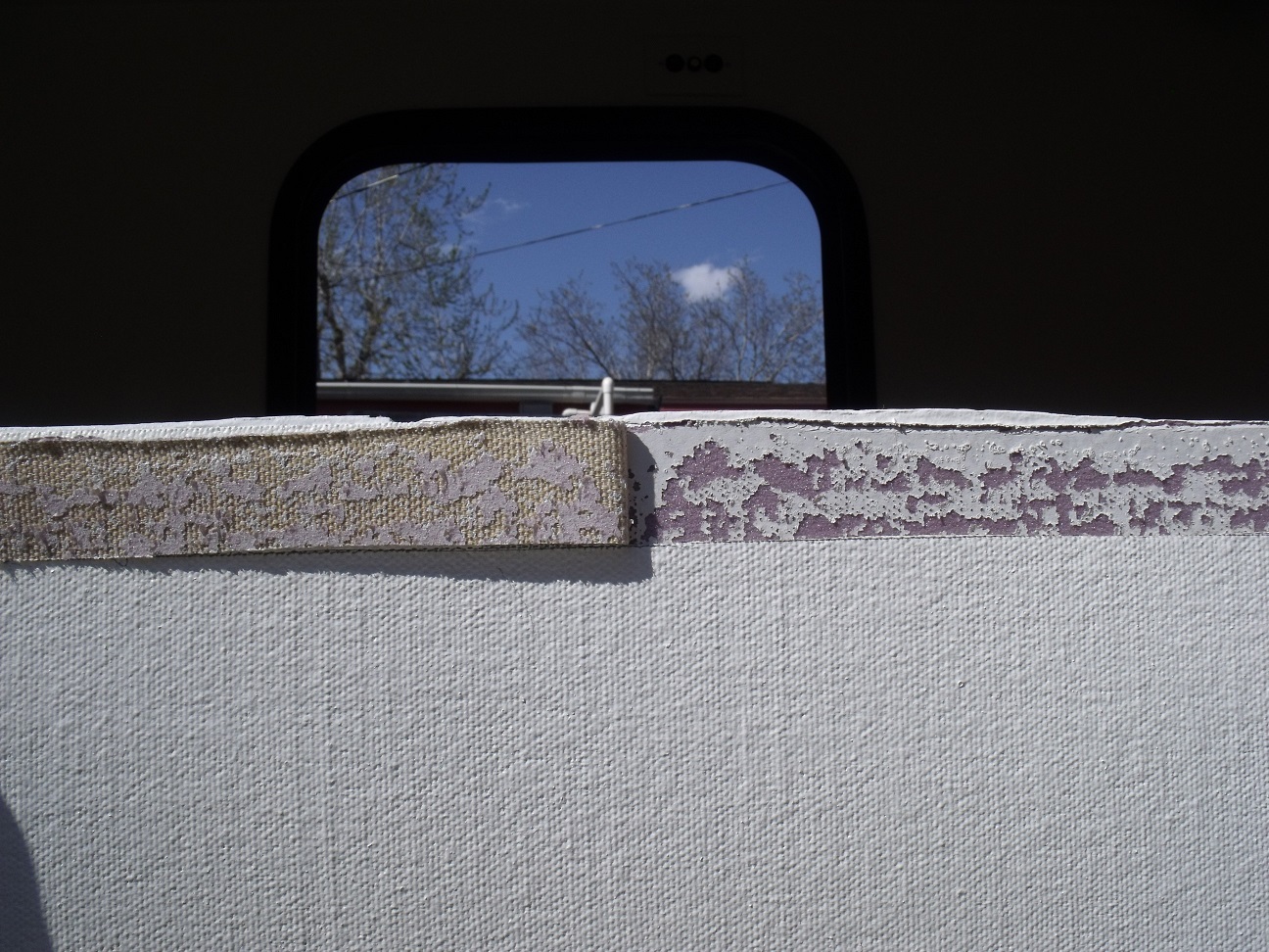

Postby ghcoe » Sat Jul 04, 2020 2:27 pm
Not sure. I used the Valspar Bonding Primer and the TBII seemed to bond well to it. This is a picture of canvas being peeled off before making a window opening larger. I could not tell you the dry times though. You can tell that the TBII bonded to the primer enough to peel the primer off the foam, and the primer was bonded to the foam enough to peel a skin off of it. I wonder if diluting the TBII 50/50 might make a difference? I also use a roller to press the canvas into the glue. Good testing. George.
George.

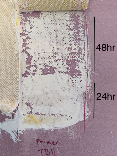

Postby tomhawk » Sat Jul 04, 2020 3:59 pm
I had planned to try diluting the TBII and reattaching. However when I ripped off the rest of the canvas this is what I saw.
The portion marked 24hr was what I had seen when I ripped a portion of the canvas yesterday. The portion marked 48hr is what was produced ripping more of the canvas off today.
24 hr more had passed since I looked before. The canvas attachment to the primer seems to have improved as time passed. I presume the the TBII bonding process gets better over an extended time.
Perhaps another conclusion might be that one should not put the canvas, newly glued by TBII to primed foam, under stress for at least 48 hr.
George, did you wipe the primed foam with isopropanol before gluing? That might be another variable.

Re: poormans fiberglass overfoam prime or no
Postby ghcoe » Sun Jul 05, 2020 12:40 pm
tomhawk wrote:George, did you wipe the primed foam with isopropanol before gluing? That might be another variable.
Thanks,
No. I just wipe the foam down before priming.
The TBII might not be totally dry in 24 hours and could take a few days if not a week or so for a full cure. You have to think that the glue is sandwiched between foam, which does not breath and wet/damp canvas, which might feel dry on top, but is not at the glue line.
George.
