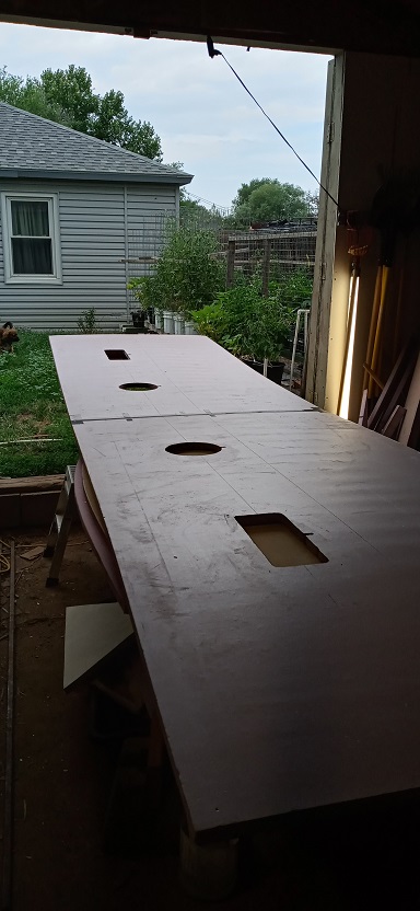

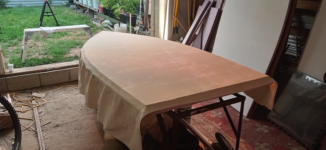

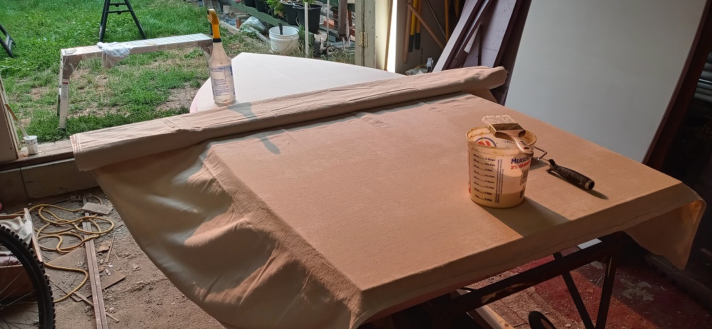

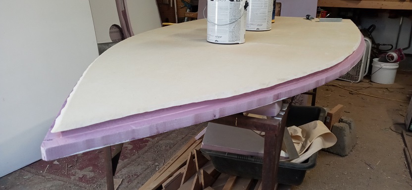

Progress this week.
I was able to finish priming the floor and attach the canvas to both sides. Since I was not intending to canvas the floor I did not order enough canvas so I had to use a Harbor Freight drop cloth for this process.
Applying canvas
20210724_184017_HDR s.jpg (461.55 KiB) Viewed 1510 times
Canvas applied
20210724_190609_HDR s.jpg (453.3 KiB) Viewed 1510 times
Canvas trimmed
20210725_071214 s.jpg (346.97 KiB) Viewed 1510 times

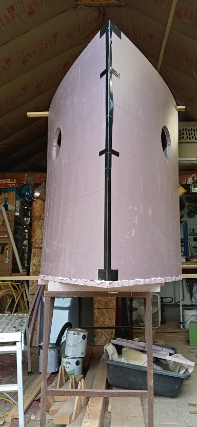

Re: #5
Postby ghcoe » Sun Aug 15, 2021 6:59 pm

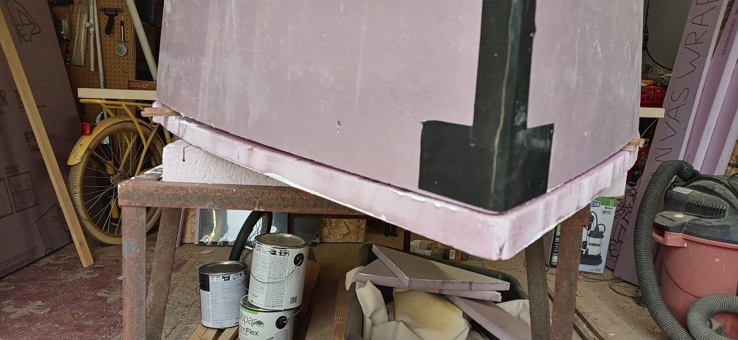

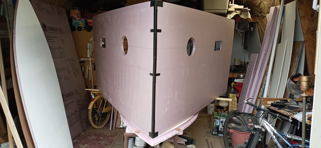

Getting a bit behind here I see. Well here is the progress since last time.
The walls come to a point in the front so I used duct tape to hold the pieces together on the outside. I then applied Gorilla Glue along the seam on the inside before I bent the walls together back together.
Attaching sides
20210731_103612_HDR s.jpg (350.55 KiB) Viewed 1436 times

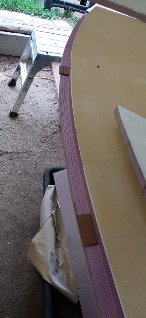

I added some spacers on the edge to hold the walls up from the bottom of the floor dado.
Spacers
20210731_105706 s.jpg (427.52 KiB) Viewed 1436 times
Then the walls are set up to get ready to glue to the floor.

Re: #5
Postby ghcoe » Sun Aug 15, 2021 7:11 pm

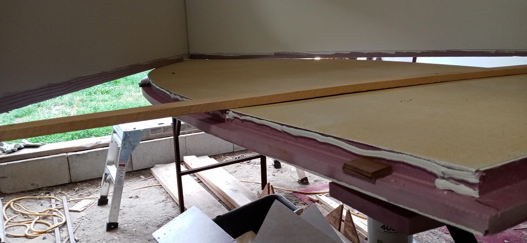

First I run glue along the inside edge of the wall dado.
Glue applied inside edge of dado
20210731_110355 s.jpg (427.27 KiB) Viewed 1433 times
Then I set the nose down into the dado and then bend the walls along the floor profile. I use clamps to hold the walls in place on the back and then check to make sure the nose is slid back all the way. Luckily my measurements all came in so I must of done something right...
Curving the walls to the floor
20210731_111610_HDR s.jpg (438.66 KiB) Viewed 1433 times
Now that the walls are where I want them I apply glue into the crevasse that the shims provided for me.
Gluing the crevasse
20210731_111901 s.jpg (407.62 KiB) Viewed 1433 times

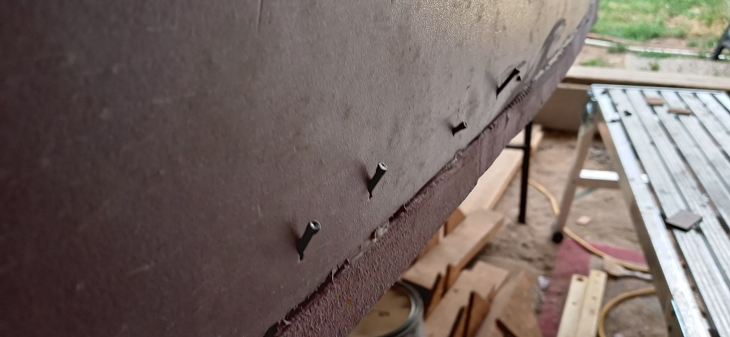

I had a couple places where the walls did not want to butt up to the floor properly so I had to add a few finishing nails to hold the walls in place as the glue dried.
Nails
20210731_113805_HDR s.jpg (383.43 KiB) Viewed 1433 times

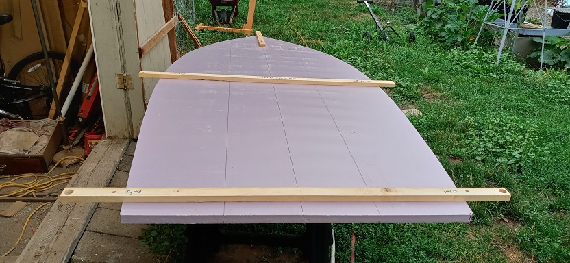

Postby ghcoe » Sun Aug 15, 2021 7:38 pm

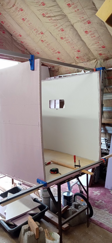

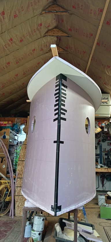

After the walls were dry it was time to raise the roof...
I applied some 1"x2" to hold the roof in place as I installed it and as the glue dried.
Getting ready
20210801_075602_HDR s.jpg (411.19 KiB) Viewed 1431 times
Usually I set the roof on top of the walls, but I on this build I decided to install between the walls. This will help hold the curve of the walls at the top since the foam does want to go straight.
Almost there
20210801_075857_HDR s.jpg (380.17 KiB) Viewed 1431 times
Getting closer
20210801_075932 s.jpg (340.59 KiB) Viewed 1431 times
George.
ghcoe
Posts: 1982
Location: SW Idaho

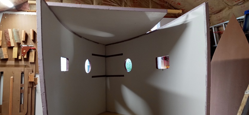

Re: #5
Postby ghcoe » Sun Aug 15, 2021 7:46 pm
Once the roof was in place I applied glue and then clamped it all together.
Roof installed
20210801_081907 s.jpg (306.6 KiB) Viewed 1428 times
Here is a shot of the temporary roof supports once the roof is installed. They will hold everything even as the glue dries.
Temporary supports
20210801_081917_HDR s.jpg (372.02 KiB) Viewed 1428 times

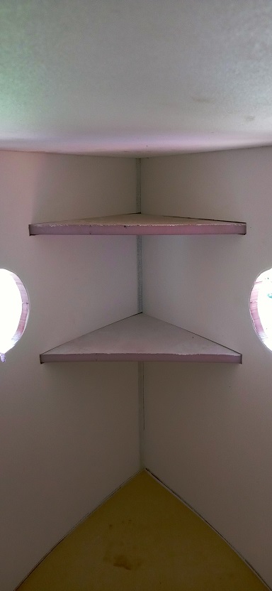

And then I popped the shelves into the shelf dados. They fit perfect! They will also give a lot of extra strength to the front section of the build.
Shelves
20210806_162653 s.jpg (309.58 KiB) Viewed 1428 times

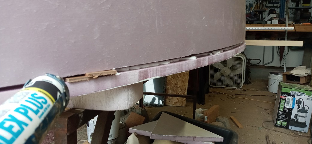

Re: #5
Postby ghcoe » Mon Aug 16, 2021 5:07 pm
aggie79 wrote:Very nice! Would you mind saying why you used two “glues” - Gorilla Glue and Latex Plus caulk? Thank you and take care, Tom
Sent from my iPad using Tapatalk Pro
No problem. My first build I experimented with Alex Plus and it worked great it just takes a long time to dry. I still have a block of foam around here that I glued together with it for a test.
I like to use Gorilla Glue Construction Adhesive because it has a good grab and hold when putting pieces together. Alex plus does not.
Gorilla Glue Construction Adhesive cures much faster too. Usually full cure in a few hours. Alex Plus can take days to cure fully to the middle.
Gorilla Glue Construction Adhesive is quite expensive though and at this point can be a bit hard to find at the stores. I figured I would try something different this time by using Gorilla Glue at the clamp points to get a good bond and Ales Plus at the other locations to save on cost. In the picture you can see a little line of glue below the long line of glue. Bottom is Gorilla Glue Construction Adhesive and top line is Alex Plus. I unclamped the walls the next day and everything stayed in place. If I had just used the Alex Plus I think it would have come a part. I do however find that once the Alex Plus cures it holds just as good as the Gorilla Glue Construction Adhesive.
