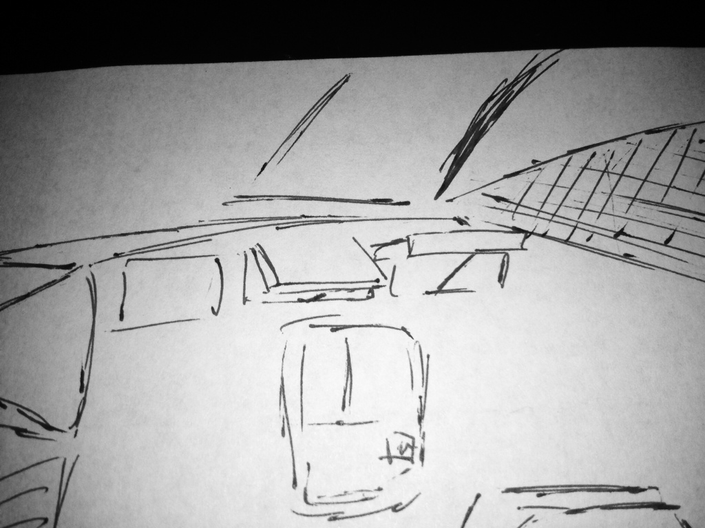

[ Really slow night... did a quick 5 min sketch of the tilt out panels and roof raised. Pardon the crudity, just trying to show the panels in all three modes... closed, halfway open and fully open...]
The commercial doors will get curtains inside. The lifting roof will have fixed windows across the tail, with curtains in case the campsite will force us to park where the light would stream in in the morning. I'm a serious night owl, and would sleep in a 'cave' if I could manage it. Lori likes things open and airy, and is a morning person... :shock:

Do you “need” that many windows ... ? :thinking:

GPW wrote:Do you “need” that many windows ... ? :thinking:
I'm only thinking one per side, that sketch was to show the three stAtes.

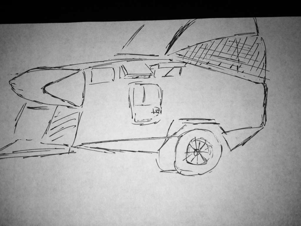

Decided to do a sketch with a Big canopy for the lifting roof...
overall profile. 5' roof at front section for scale.
here's where it gets exciting... (well, sort of...)
and canopy UP
This is mostly a design exercise to explore just how it would look with a really BIG canopy... I Love the huge space inside... and since it is a foamie... I'll have a simple frame inside and still be light enough to lift up manually. the windows in the tail are 18" across each pane... for scale. I still have to work on the lower wall section. I'm planning on a tip forward upper wall section hinged just above the window section. (so that the canopy overlaps in transit). I also have not sketched the filler screened panels which will hold up the canopy when it is raised.

Postby KCStudly » Sun Jan 25, 2015 12:28 am
So plexi windows to keep it light?
Will, that it were to be built, the side fillers be hinged in place, or how will you go about lifting it and setting it up?
I might be tempted to simplify the front. I can see the overhanging/forward jutting upper section being the same panel and line all the way to the floor, then there would be a couple less facets to have to cut, fit, and join.

Postby Ned B » Sun Jan 25, 2015 1:25 am
KCStudly wrote:So plexi windows to keep it light?
I'm thinking at this point, lift roof up, prop, fit panels, fold up rear wall/door, (latch door/wall and insert panels together) lower roof, secure.
as for the nose... this sketch is poor, essentially it would be a full 5' high vertical wall with a tongue box for batteries, and then the nose 'cone'. The nose cone section would be for 'soft goods storage' with an access door inside... (sleeping bags, etc...). the tongue box would be about 12-16" deep, at the widest, very similar to a certain TPCE nose box. :roll: Essentially a trapezoid, straight vertical walls. the Sketch got a bit fancier, but I was going to have the lower section be just the trapezoid snugged up against the front vertical wall.
and definitely plexi windows for weight control.

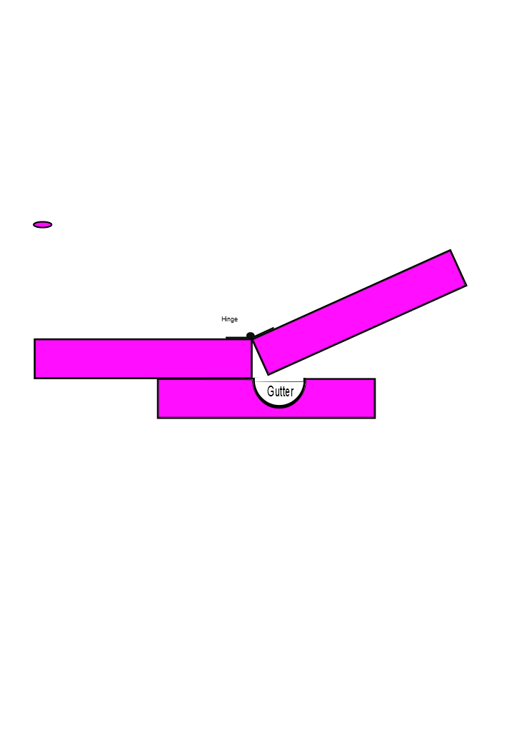

Is it just me or does the roof hinge directly over the bed area make anybody nervous ? Rain? :roll:
Re: Hybrid Foamie: Wild Wanderer in Foam-now with sketches
Postby ghcoe » Sun Jan 25, 2015 9:26 am
This is where my sub-roof gutter system would be good. Any water that may get past the hinge gets caught in the gutter before getting in. Then the water will flow out one side or the other. :thumbsup:
Gutter
Gutter explained.png (22.37 KiB) Viewed 2022 times
Something to think about for those large windows is Polycarbonate Twinwall. It is light, strong, and more insulative than plexiglass. It is used a lot in greenhouses construction.
