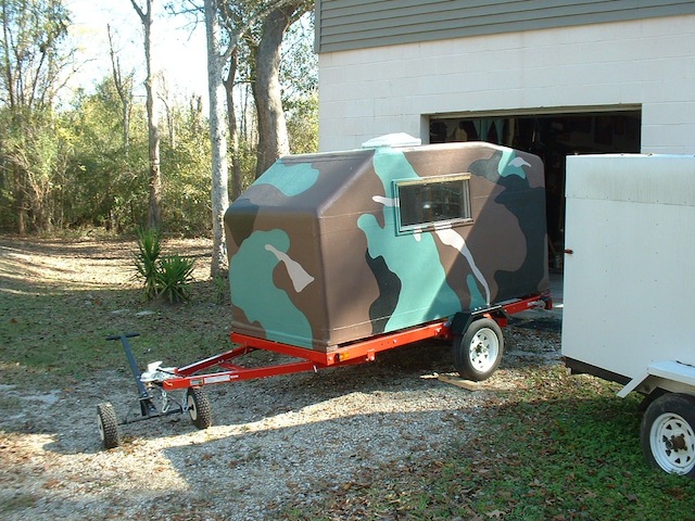

BTW here’s the final pics of Foamie #1
One more in the album clearly showing the spacers ...

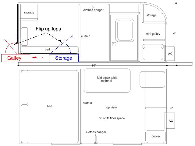

Was thinking with the new design , if I elevated the bed on a frame (van style ) , I’d have tons more storage room underneath and it would give me the possibility of a slide out Galley “drawer “ in the back ... for cooking outside ... Galley drawer Lid would flip up and protect the back of the Foamie ... Many possibilities ... everything square makes it easy to build ... :thinking:

Lessons learned going 6 wide:
1 trailer issues hard to find any trailer that wide so you have to deal with wheel wells being in the way hence my storage and elevation workaround.
2 not quite wide enough to invert the bed need 7' for that due to beds are 80" length
3 raising for the storage creates more height and wind drag so you have to start deciding what necessary evils you want to trade off
You see I went with storage space and wind drag because in a commercial sense I want to cater more to using this for say a 1 to 2 wk outing more than just a quick weekender so its a balancing the scale of end user pull to the web of design or web of usage.......

Love the galley idea. That would be so neat. You could incorporate wind screens in the door, maybe. Then it could all fit together. :)

Thanks Steve !!! Those are some good lessons too!!! ... Have to think about all of that !!! Just trying to get the Size right for now .. Too Big is just Waaaayy Too much trouble for me (proven) ... :o Already got Too small ... :oops: Need one that’s “just right “ !!! ;)
Bonnie ... interlocking Foamies ...like a wagon train ... keep the Injuns' away ... and Bears too ... :o
Two Galleys would be convenient for most anything ... Foamies are Light enough to carry all that without stressing the trailer ...
Just guessing a Foamie this size would be about 600-700 lbs. ... Probably easily carry it’s own weight in cargo/gear and still not be over the limit ... and still Light by most standards ... :thinking:

The only problem I see with it is you need to consider the AC front being a problem because if you are towing in the rain any front openings are extremely hard to make seal and keep water out when you take in account water and 60 to 70mph wind pushing it going down the highway.
Have doing some designing in my head today after looking at yours and look at my build and then consider the same type trailer at a 10' length and using a futon mattress (because it folds and foam doesn't) you could then have the bed area forward of the axle fold back and have the lower part of the trailer then accessible to use for dressing and sitting and a table area and then the bed floor raise up parallel with the front wall and just lower it for sleeping configuration. It would have over 5' clearance in the sunken part. Was thinking of taking cabin 7' wide turning bed sideways with this type of build but that would make impossible for most vehicles to see around it towing.

GPW wrote:Bonnie , If I were 30 years younger I wouldn’t mind climbing up to that TT roof , just too old for that ... :o Smaller TTT stored in the Garage would be plenty enough for me ... :thumbsup:
Droid using PaintBrush for Mac ,very close to MS Paint ... About all I can handle ... :oops:
now this is one fine looking foamie! :applause:
hey glenn, what is that trailer next to it? have i missed something?
