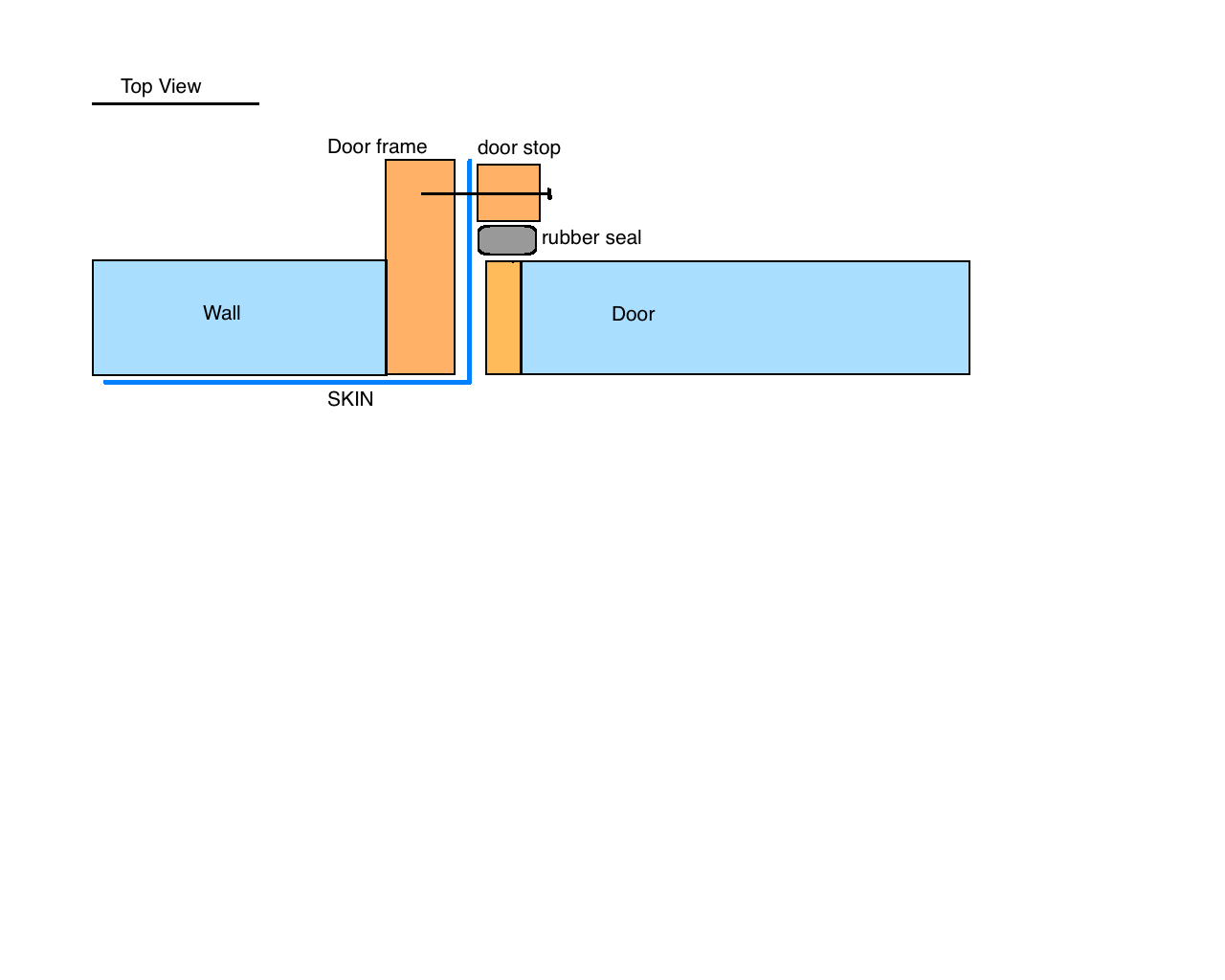

Postby GPW » Tue Dec 10, 2013 2:22 pm
Mary , made a sketch of how I did my door... looking down , you can see how the skin wraps completely around the door frame and then the door stop piece and gasket are put on over that ...I caulked the join of the covered frame and stop piece..then stuck the rubber gasket on ... been fine ever since , and we certainly have checked it with a critical eye... No leaks !!! I assume the foam drip cap thing up top does a good job ... that area is always dry, and even after some storms...
I didn’t think pictures would explain as well as a drawing ...everything’s already done, the good bits covered up... :o
door seal.png (21.69 KiB) Viewed 911 times

Tac, your doors look very similar to mine I admit i was in a big hurry and didn't take the time to cut out the extra material off but I guess i will now. I knew I was going to have to work on the doors but it will be after the new year have to wait till I get the money for the seal. Where do I get the seal? I have never bought any at all. Lots of fun.
Thanks GPW for the great drawing. I can really follow that. At least I see where to put the seal, but how do I attach it?

Postby GPW » Wed Dec 11, 2013 9:21 pm
Mary , I painted over everything... and the rubber seal with the little ridges, had a sticky backing on it ... didn’t stick well at first , so I added a couple staples in “stragetic” areas.. After the door was smushed on it for a while , it stuck OK ... :thumbsup: I used the same stuff on the house front door which had a small air gap , all better now ... and it stuck to the wooden door frame just fine .... Guess it didn’t want to stick over the freshly painted surface on the trailer door ... ? I got mine at Loew’s ..
