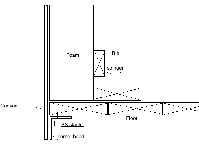

LC, it’a Always the rainy season here … Mold remediation is a way of life … you know !
One surprising point , we found it wasn’t the local deluges that ruined the underfloor canvas , but the everlasting Morning dew that wet the canvas every day … Keeping canvas moistened continuously , softening TB2 used to attach it and allowing the water to eventually soak into the floor (OSB) …. and attracting Ants … :frightened:
The simple Drip edges made of drywall corner edges only 1 1/4” deep works perfectly to keep the floor dry underneath …
Once again here’s the drawing ..using the drywall corners ( Thanks to Steve ,George, and Tac for the info) :thumbsup: Easy, inexpensive , and it WORKS !!!

Okay, back to your response.....thanks for that image.....I bought a handful of drywall corners to try in different tests....even a bullnose....and I have a stapler (not a red one)....
So, Drip Edge....on the build list....
