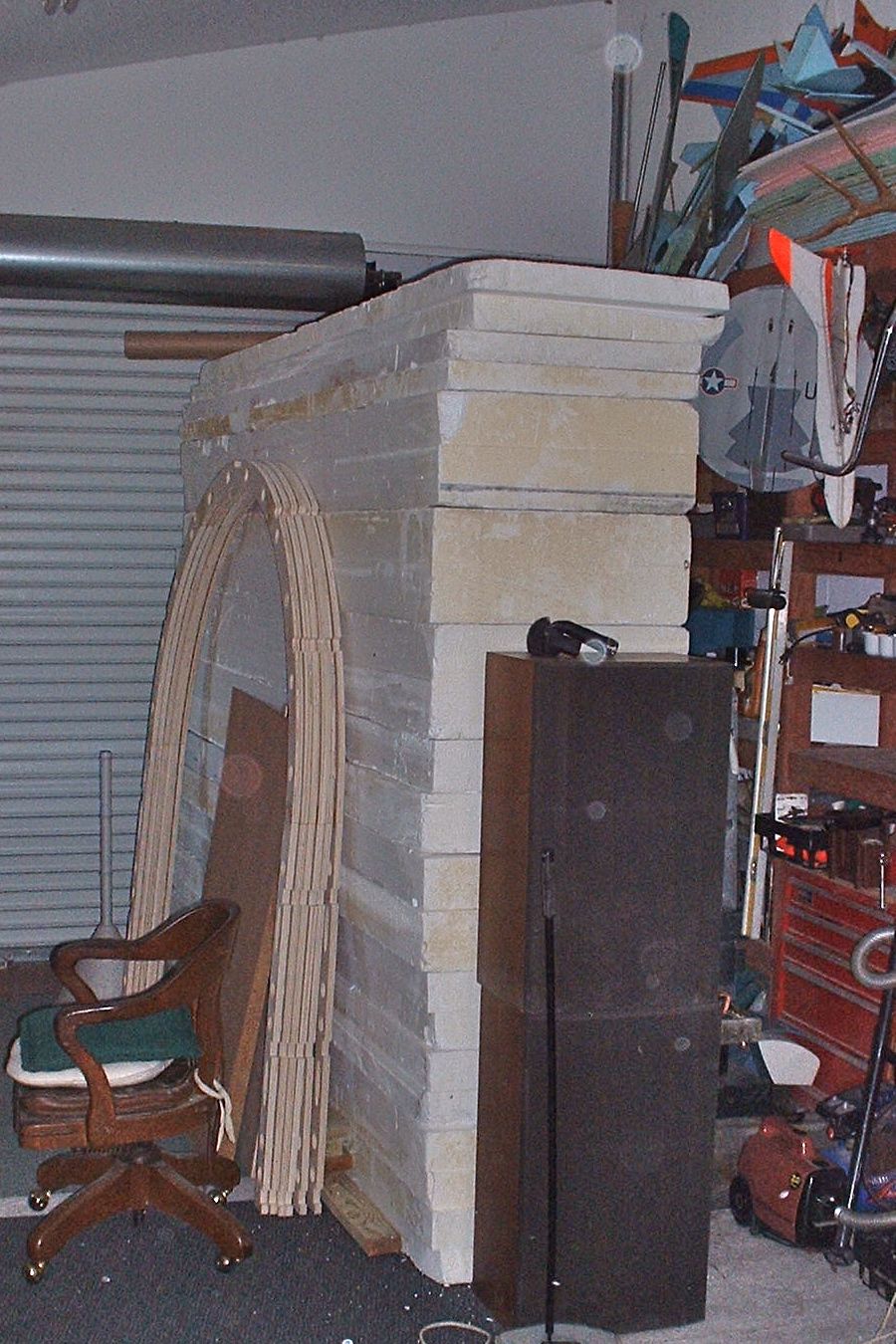

Scheduled to slice the Foam on Saturday (with helpers) ... Making the big "cheese slicer” HW table cutter ... all temporary, 2X4s clamped to a big folding table ... multitasking , those 2X4 will be 2 of the cross braces on the trailer floor later ... Not only going to slice the FS foam , but the foam for the Paddleboard project too ... all in one go ... Another major step going to be out of the way ... :thumbsup: I’ll be sure to take pictures and schmaybe’ a video ... :pictures:
Re: FoamStream...
Postby GPW » Sun Nov 18, 2012 10:19 am
Well , as things would go , the big cheese slicer idea worked , except we kept breaking the wire .... So out came the trusty old HW bow and we managed to get all 9 blocks sliced up , using the 2X4s as templates ... enough for the FS and the two paddle boards ... about 3 hours time .... sorry no pics , it was a frenzy of cutting , getting close to dark ... and then the mosquitoes came out ... :o
Anyway, here’s the finished stack of sheets ...

Postby Wobbly Wheels » Sun Nov 18, 2012 12:33 pm
That's getting to be an impressive pile of materials: you gonna start building sometime soon ?!?
J/K...looks like great progress to someone who's standing still.
What do you figure was breaking the wire ?
Could get enough heat out of it ?
Wobbly Wheels
Posts: 1080
Re: FoamStream...
Postby GPW » Sun Nov 18, 2012 12:49 pm
Soon as I get the trailer prepped and install the floor .... then skeleton , then foam .... from measurements/calculations , I should have a little extra... :D
Started with a G-string (guitar) , then tried .032 Music wire .... neither worked, both broke in short order , probably too much Heat I could only turn the Variac up a tiny bit ... The HW bow had solid Stainless fishing leader wire ,thin , and worked the whole time with no problems :thumbsup: ... I have to experiment more with this ... :thinking: Maybe even spring for some real nichrome wire ... what I was supposed to be using all along ... :oops:

Postby Wobbly Wheels » Sun Nov 18, 2012 1:29 pm
Maybe gut a thrift-store toaster or toaster oven ?
That's got to be cheaper than buying the wire just for the purpose...and you'd have the rheostat, too.

Postby cpinetree » Sun Nov 18, 2012 4:17 pm
GPW wrote:Soon as I get the trailer prepped and install the floor .... then skeleton , then foam .... from measurements/calculations , I should have a little extra... :D
Nichrome wire can usually be had from a heat and AC shop, ask them to give you the old coil element from an electric heater when they replace a bad one.

Postby GPW » Sun Nov 18, 2012 5:23 pm
Pretty cheap to begin with , no time for straightening coils ... http://www.amazon.com/Nickel-Chomium-Re ... s_indust_1 And I’d have it on hand ... ;)

Postby pete42 » Tue Nov 20, 2012 9:37 am
Glen we used aircraft safety wire for our HW crosscut saw looking rig and a train transformer
when we built most of two airplanes safety wire was what we had on hand worked great
but the nichrome wire from amazon may be cheaper.

Postby GPW » Tue Nov 20, 2012 10:01 am
Pete , I’ve thought about this and the only conclusion was there was some “give” holding the bow with hands , whereas the “slicer” just put too much pressure at once on the wire ... :o
