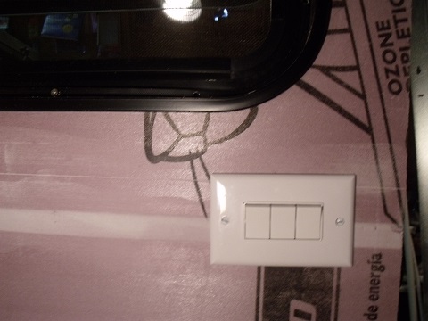

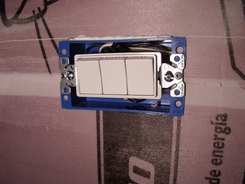

Then I wired in the switch. Since this is all low power LED lighting I just used speaker wire, its cheap and easy to use and able to handle the power needed.
Light switch
Installed the light cover and test the wires to confirm proper polarity and operation. All is good. 8)
Ready for testing
George.
