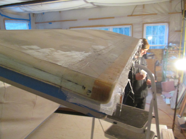

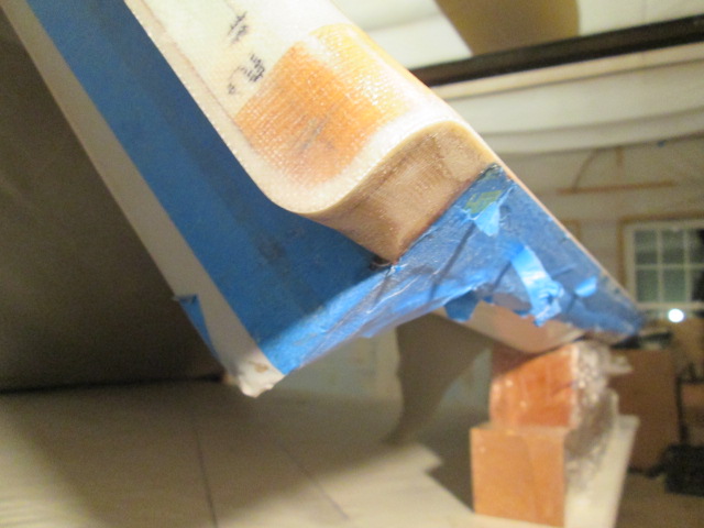

The filler work I did yesterday was just a tad soft still when I arrived today, which I attributed to the cold overnight temperatures (high of 48), but I figure it will continue to cure solid eventually. After pulling the screw out of the hinge hole repair… with the wax it came right out… and doing some sanding, it was time to lay up the hinge area. This would also be a test of my ability to lay dry on dry on a slanted surface.

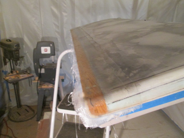

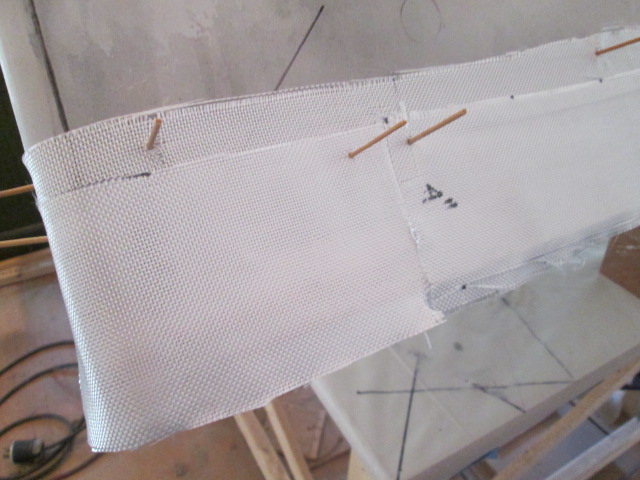

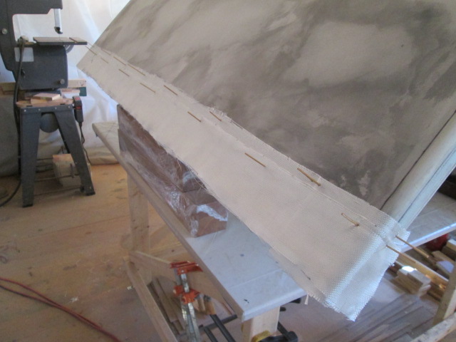

I had previously cut 60 inch long strips at 5 and 4 inches wide so that I could stagger the plies, hopefully allowing me to step lap the main lay up later. The plan was to hang the strips off of the front of the spar some to allow a clean trim. In hindsight I should have put sharpie lines on the foam to help guide placement of the cloth.
Anyway, I tried tabs of blue tape first to keep the cloth strips from sliding off of the hatch, but it didn’t stay attached to the foam well at all.

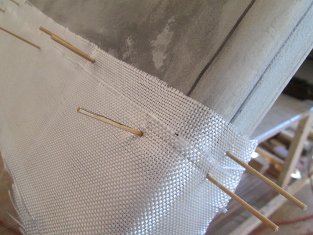

Then I spent some time cutting bamboo skewers down and sharpening them into hardy toothpick size. I had plenty more skewers, but the newer package was fatter in diameter and I didn’t want the extra length getting in the way anyhow.
The skewers worked pretty well to hold the cloth in place. Here you can see how I staggered the plies and alternated the strips with a short piece added on each end to make up the difference in length between the 60 inch cloth and the 64 inch wide hatch, plus wrapping the sides. You can also see how I pressed the plastic wrapped cedar 4x4’s back into service to help prop the hatch up into a slightly flatter position.
After wetting it out and pulling the skewers out, I propped the hatch up even further as a hedge against having the whole layup slide off. Probably wouldn’t happen, but the top layer was still able to squirm around a little under the squeegee.
The dry on dry technique is a lot less controlled than the PMPP; lots of stray stringy bits to contend with. I did end up lifting the front edge of the cloth and brushed some wet along the oak in a few places that didn't wet out readily at first, but it looked pretty good to me when I walked away from it.

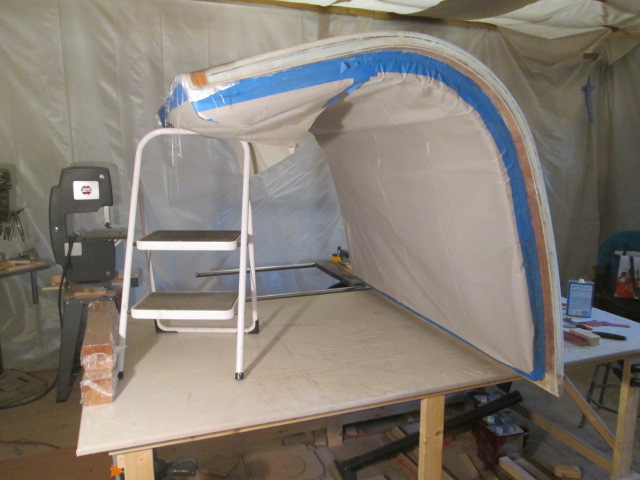

Here’s another shot from the curb side.
And one from the front underside.

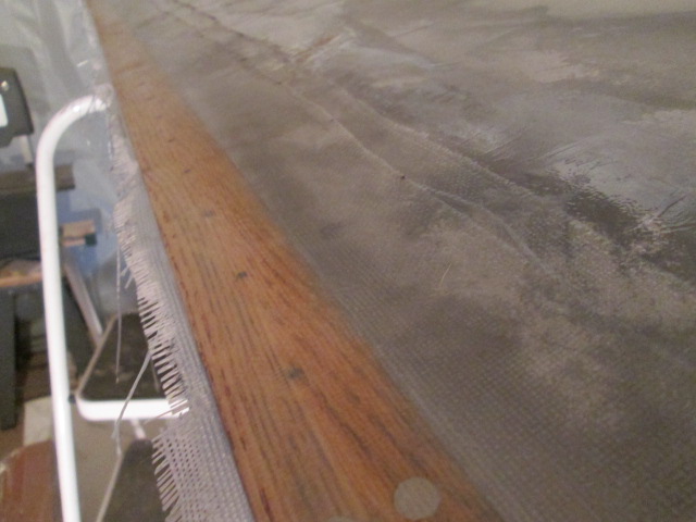

Another looking down from the street side. I suppose I could have trimmed some more of the excess off while still wet since not doing so can let a bubble form when the glass tries to hang down and bends over the edge, but I find that gets messy and I tend to lift the cloth in doing so. I prefer to leave less hanging over to start, even though you run the risk of pulling threads out from the edge during the wet out. The staggered plies aren’t very straight along the back (right in pic). If I had this to do over I think I would do it as two single ply PMPP’s. Another option would be to make a staggered PMPP by wetting out one ply over plastic; laminating with a top plastic; trimming it straight; peeling one sheet of plastic; laying it staggered over the second ply as its being wet out on plastic; peeling the top plastic; laying a larger top plastic over; trimming the edge of the larger ply; peeling the plastic off of the larger ply; and then laying that side down on the part.
A little closer up and you can see some loose strands and the lack of straightness. I spent some time at the end trimming loose strands that had pulled up onto the foam and trying to get the short fibers along the edge to lie down smoothly. I was wishing that I had mail ordered peel ply, and now I realize what Atomic was saying; I should have had a strip of plastic ready and laid that over the stagger to fair it down as it cures.
I think I dragged enough wet up onto the foam that it will be armored enough and I can sand any barbs without gouging into the foam.

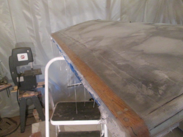

Yesterday when I was doing the hatch hinge area I had some drips and strings hanging off of the lower edge and had laid cardboard down to catch the drips. At some point I knelt down to cut some of the more egregious strands, and may have gotten a whiff of wet on my scalp; or I touched the mixing cup after having removed my gloves to take pictures, and there was a little hint of tacky epoxy that I could just feel and smell on my fingers, and I may have touched my head afterwards (another possibility was that it was something that I was exposed to at work). Later when I got home I started getting a slight burning sensation and itchiness, so I dunked my head and scrubbed with soap and water. No blisters so far, so maybe a near miss.

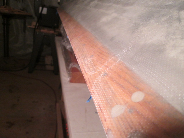

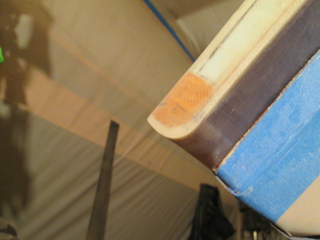

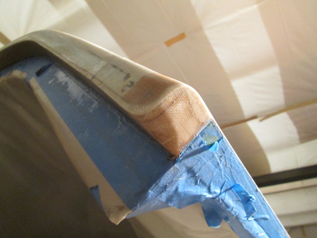

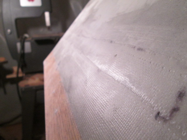

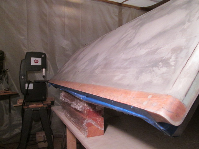

After trimming the edge close with the serrated knife; scraping the edge down close with the small paint scrapper (which worked very well and a lot faster than the 100 grit on the small block); sanding the edge flush; knocking down the nubbies at the staggered lap (so that the greenie pad wouldn’t snag on it); and washing the amine off with the greenie, things were shaping up very nicely. Street side first.
A long shot of the leading edge.

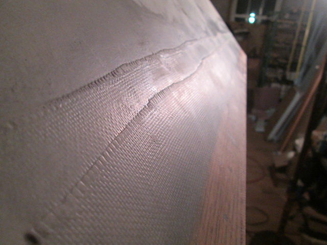

The little flame shaped outline is where I sanded the not so flat butt joint bump between cloth strips fair.
Curb side.

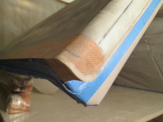

At first I just sanded the lap edges enough to remove any snags. You can also see the darker gray areas above the edge of the cloth where I made sure to spread any excess epoxy off and as thin as I could to avoid runs and blobs.
Then I decided to test my theory about the skim coat of epoxy armoring the foam against sanding damage and used the small block to hand sand the staggered edges much closer to fair. It was easy with nice fresh paper and very light pressure. The best part was that I never once caught an edge or chunked out any of the foam! No accidental fingernail gouges, no undercutting, and no dents or dings to have to fix.
I could have taken this even further, or worked it with some fairing mix, but it makes more sense to me to do the main hatch layup before going to that stage. If I thought I could do a better seam it might make more sense to fair it better, but I’m not that good yet. So that was my ‘ah ha’ moment. If I had listened to that advice earlier, or if I had decided to do epoxy and glass earlier, I might not have chased so many dings and dents and handling issues. I might not have done all of that spackle work, and I might have been further along here now. Maybe.

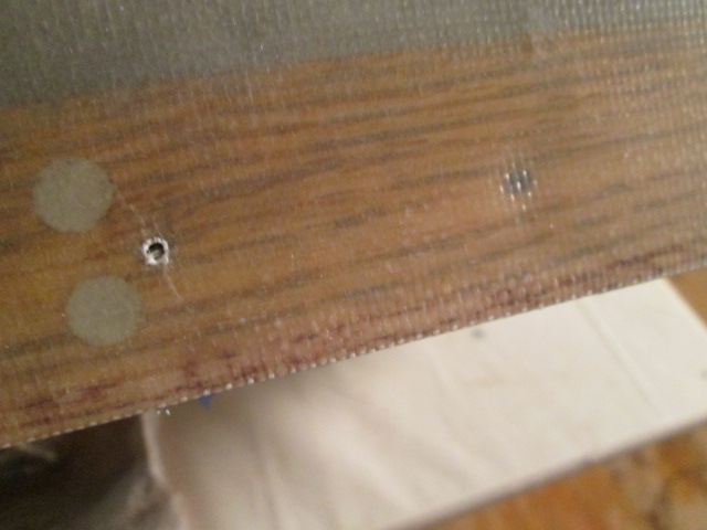

One last task for tonight. I went down the row and drilled thru to the existing hinge screw holes. Here you can see two of the hatch rib screws buried under filler under the glass on the left; a drilled hinge screw hole adjacent to that; and another hinge screw hole to be drilled thru over on the right. No trouble seeing them or finding center.
