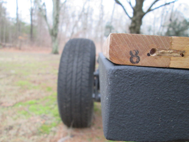

It finally warmed up a bit today. I suppose I have been slack and could have found something other than epoxy work to do on the build over the last several cold days (Sunday thru Thursday), but I have also been on the fence about what to do with the lower edge of the floor.

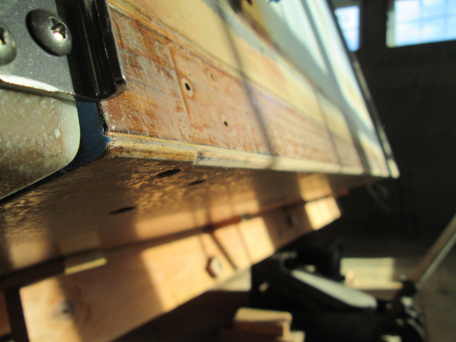

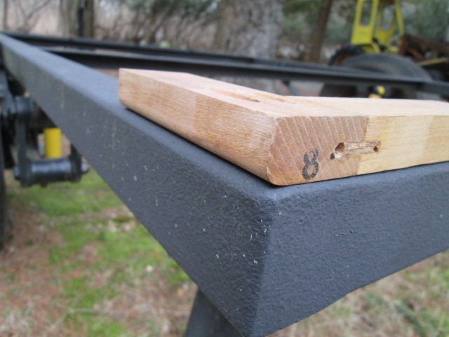

So tonight I keeled the cabin over on the curb side, raising the street side, to take a closer look and see if I can make a decision.
The 1/8 thk box tubes on the sides of the trailer have a radius of 3/16 inch, while the 3/16 thk front xmbr has a radius of 1/4 inch. The locker bump out takes up most of the front wall and the rock guards will cover the rest, so whatever I do there isn’t really an appearance factor. From my work on the TB I know that I am much more comfortable wrapping zero bias cloth over a 1/4 inch radius than a 3/16 inch one (although Michael's suggestion to use a light mist of spray tack to hold the cloth snug might help).

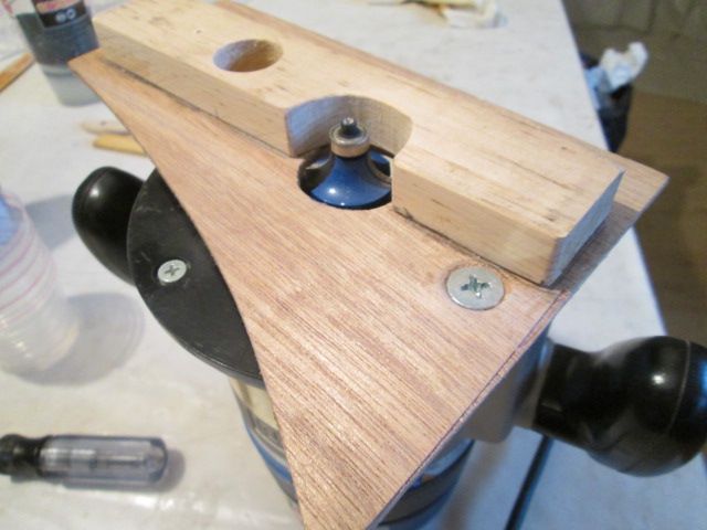

The countersunk screws under the floor securing the walls ended up being far enough in from the edge that the bearing on the 3/16 round over bit wouldn’t fall into them by about half the width of the bearing. I decided that I could run that bit around and if I decided I didn’t like how it looked, I could either step up to the 1/4 inch bit or switch to the chamfer bit and commit to the flox edge.
It seems like a really small detail, but I really don’t like the idea of having a bigger radius on the cabin than there is on the trailer; a lopsided “butt crack”.
Anyway, I removed the draw latch to get it out of the way and ran the 3/16 inch bit, and then hand sanded the area where the router shoe wouldn’t let the bit get close to the locker. While contemplating I used the medium sized sanding block with 80 grit and roughed up the outside edge of the floor to take the TB2 glaze off.
The 3/16 radius just doesn’t look like it is enough for me to reliably get the cloth to wrap under, especially with the somewhat unknown factor of worker more or less overhead under the floor.
The flox corner option means that the strip that would go under would be applied as a separate operation. Not having the cloth draping down from above and having to stick it up from below sounds a bit harder. The only way I would try that is with the PMPP process and it still could be trickier than just wrapping the side cloth under as one big operation.
Tomorrow is supposed to stay warmer (mid 40’s), but rainy and wet. I think I will take the TB out to the trailer and do a mock up with the 1/4 inch radius against the side rails and see if I can’t get over my hang up on the butt crack appearance. Stepping up to the 1/4 inch round over and wrapping the side layup under in one operation seems like the easiest solution.

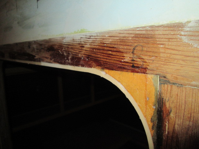

It was hard at first to get going in the shop today. Despite the slightly warmer temps, it was overcast and damp today, so the loft temperature was slow to come up.
But once I got going things went well and I felt like I got a good deal done. I didn’t want to take the TB out in the rain to do that mockup with the trailer frame radius, so instead I just took a scrap of the cabinet face frame stock that also had the 1/4 inch radius on it. Sorry, didn’t think to bring the camera down. Anyway, the butt crack actually looked better with the 1/4 inch radius than it did with a sharper edge on the cabin. Maybe the promise of less work influenced my opinion, but I’m okay with that.

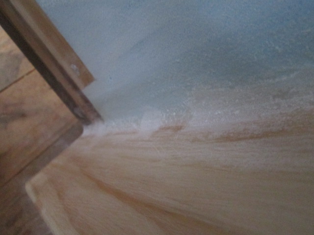

So I ran the 1/4 round over bit along the street side, and while it was still up in the air, used the medium block with the 80 grit belt to scrub up the underside within about 8 inches of the edge of the floor, and along the side and sill of the wall. There is some slight lack of fairness between the bottom of the wall and the top of the floor here and there that I hadn’t noticed before, so I might have to give that a smear of filler at some point. I had meant to pick up some 80 grit sheet sandpaper to use in the palm sander, but I forgot. Doing the full length of the floor, even just near the side edge was enough work and steamed up my glasses, so when I switched and jacked up the curb side I decided to use the palm sander with the 100 grit paper that I had on hand. Here’s a shot looking down the curb side from the rear. Just forward of the draw latch tab on the hatch you can see the 3/16 inch radius (I’ll increase this later when the cabin is down and I can lift the hatch out of the way). Ahead of that you can see the 1/4 inch radius running to the front. Also, up on the sill and side edge of the floor you can see the start of the scuffing work, but it needs more still.

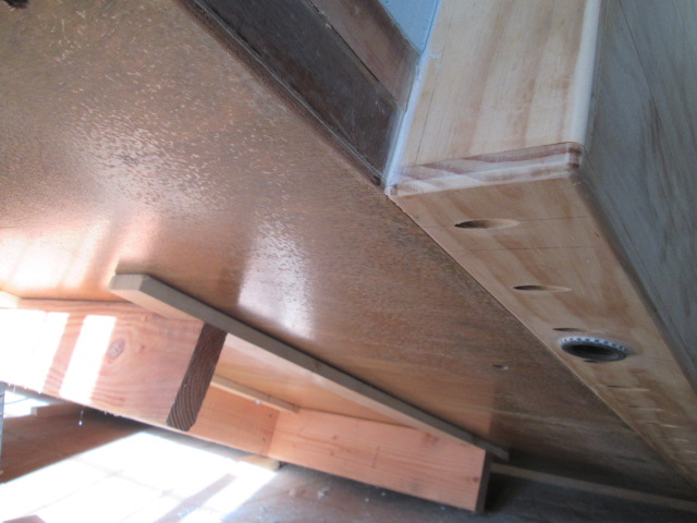

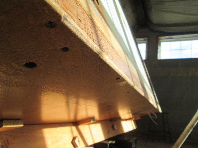

In this slightly different angle you can see how the underside is scuffed and the countersunk deck screw heads that need filling where they run up into the bottom of the wall.
While I had the router setup I ran it around the bottom and side edges of the front locker bump out to increase those from the 1/8 inch radius I had done previously. The top side edges had to be done by hand because the router base wouldn’t fit there, as well as the front top edge due to the shed angle.
Here you can see the front underside of the floor scuffed, the fresh radius on the underside of the locker bump out, and the pocket screw holes that need to be filled. Also, the rear edge of the locker is slightly lower than the floor, so that needs to be faired with some filler.
I cut a faux credit card to match the angle between the top of the locker and the front wall then rounded it over to a 1/4 inch radius. I also rounded one of the 90 deg corners of the card to 1/4 inch, as well. Once I had the thickened epoxy mixed and in the piping bag I filled the inside corners around the locker and used the card to form inside radius fillets.
Used the same batch to fill the pocket screw holes and fair the underside of the locker to the floor.
Then filled all of the screw holes along the sides. (The larger unfilled hole you see a little further in from the edge is one of the bolt holes for attaching the cabin to the trailer.)
Still had some thick left so I used it to touch up the flox corner on the curb side door frame and to fill the screw holes left from the temporary dam there.
Still a little leftover, so I smeared it along the front edge of the hinge glass where the plastic peel ply had not performed as well as I would have liked.
Tomorrow I’ll get some 80 grit for the palm sander and rough the floor up some more while I clean up the filler.

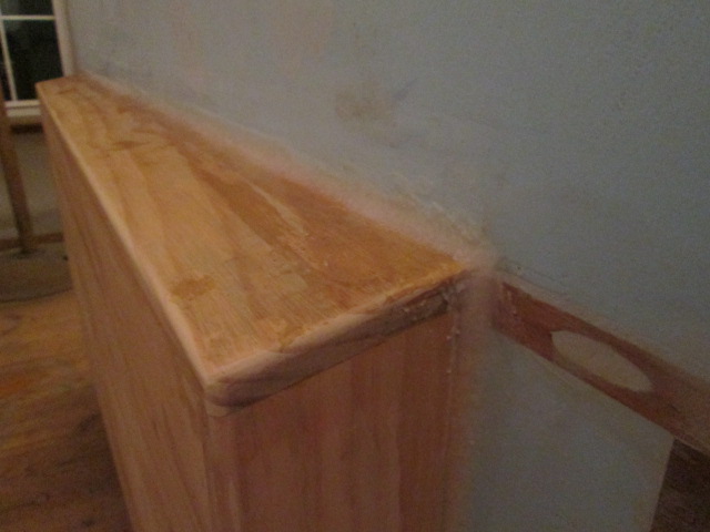

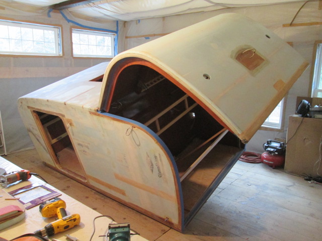

I remembered to take a couple of pictures of the mock up for the now infamous “butt crack”.

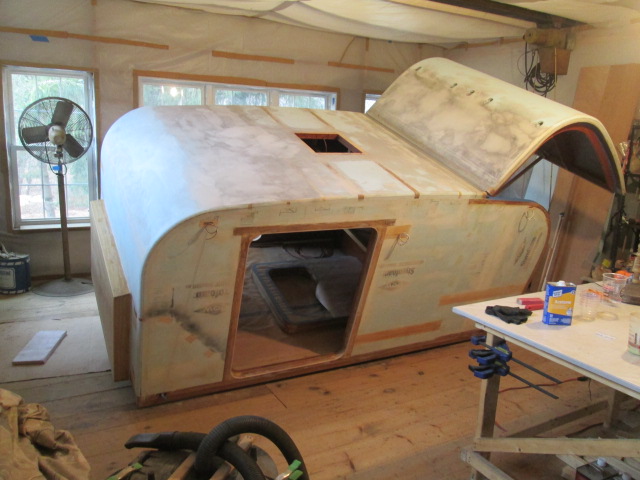

I hadn’t intended to keel the cabin over with the hatch propped up, but must have spaced out because it happened. Doesn’t seem to have caused any issues, so I worked on; but it did make for a couple of interesting shots. Spoiler up; hard bank to port.

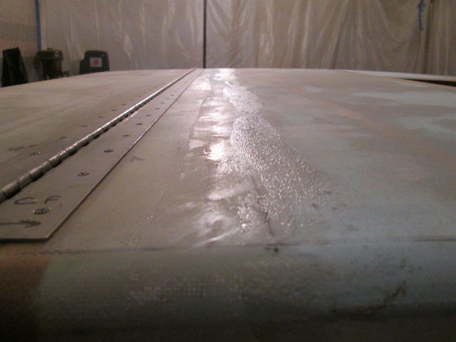

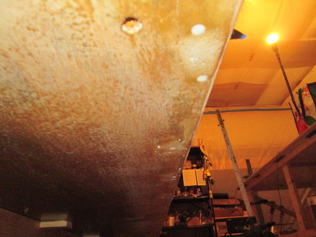

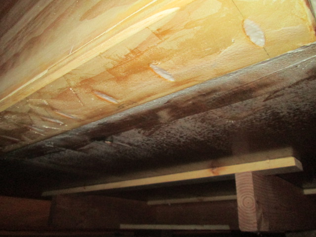

That got me access to scrub amine from the street side roof at the cabin hinge glass; along the underside of the front and curb side; as well as the curb side door frame. Then 60 grit with the small hand block to knock the small high spots down; then 60 grit on the soft back of the palm sander along the side of the sill and floor edge, and the underside adjacent to the edge (to give it great tooth for the glass cloth wrap). Not much of the TB2 left in these areas and plenty of raw wood for the epoxy to grab.

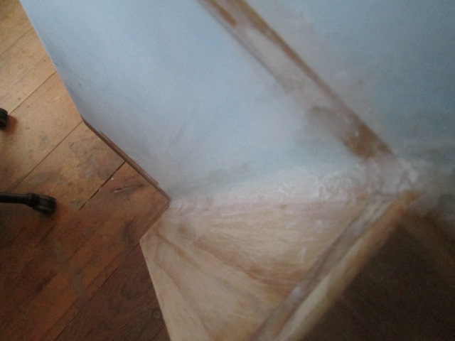

The filler in the pocket screw holes under the front locker sucked up more than I would have liked, so I had to rough them… well, the half or so that I could reach comfortably from this side… out by hand with a small scrap of 36 grit so that I can top them off with another round of filler. Also, I had second thoughts about the filler I added between the back of the locker and the front of the floor. My concern was that this build up would act as a shim along the front xmbr of the trailer, but given that I plan to use some sort of welting or sealer, I don’t think there is much reason to knock it back all the way; though I did hit it with the 60 grit on the small hand block. (no pics)

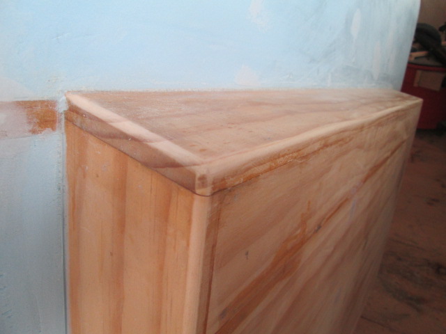

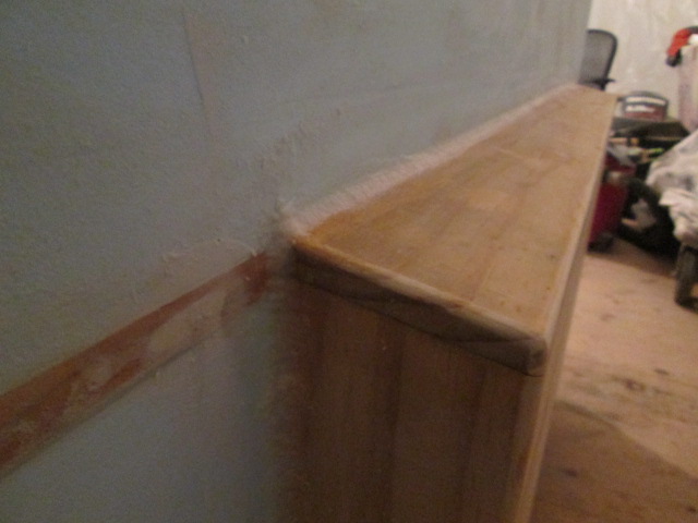

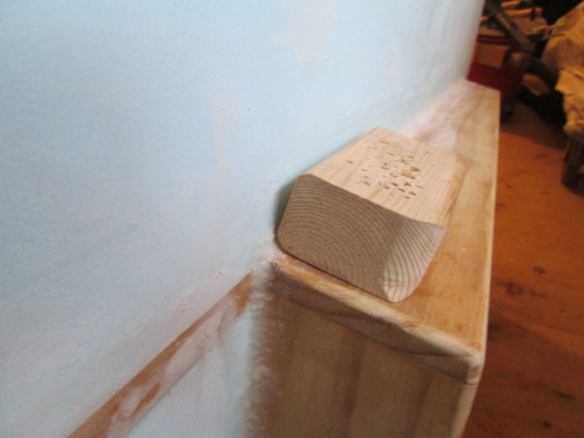

For the fillet around the locker bump out the straight 403 chop filler had some bramble and the shaped credit card squeegee didn’t work as consistently as I would have liked. My solution was to make a radius sanding block to let me block sand the fillets. Here you can see the block (with a strip of coarse grit red sandpaper already glued on the edge) located by a makeshift ‘L’ shaped dog clamp (a cabinet frame mock up test piece and small spacer) to keep the small chunk of 2x3 block from flying off or sliding under the router.

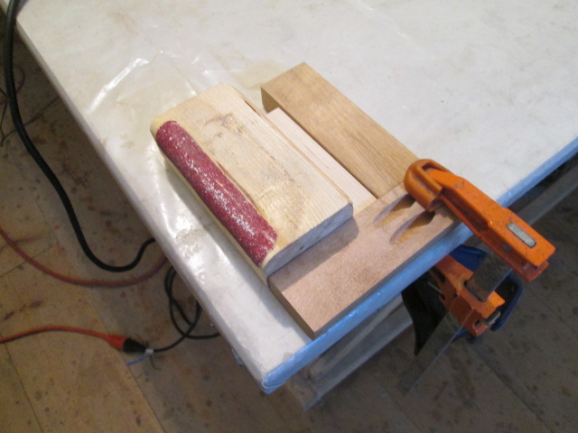

The sanding block worked very well to knock the high spots down and even up the fillet. On the top of the locker I ran it both ways, guiding off of the locker top for a few passes, then guiding off of the wall for a few. The hard crust of filler that spilled over onto the foam, though very thin from being squeegeed off, provided enough armor to keep the sanding block from damaging the foam.
On the curb side of the locker, in the 90 deg corner, the block worked equally well. This shot, looking down from the top, is a bit skewed due to the cabin being tilted up on the street side.
There were still a couple low spots that you might just be able to make out in this pic; so maybe a little pickup filler, or some of the 410 fairing compound will be needed here.

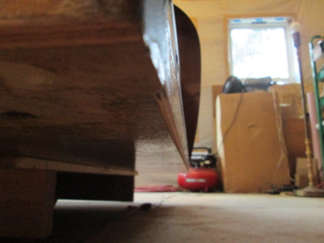

Here is the underside of the floor rear edge looking from the street side, mostly just a reminder for me of what I did. You can see that I rounded it over, but left about 1-1/2 inches unrounded (the width of the galley walls) near and far. I have an idea of how the seal rabbet will transition from the rear edges of the walls to the back edge of the floor and I thought it would be better to leave this for now until I’m sure how the rabbeting bit wants to be guided at this transition.
